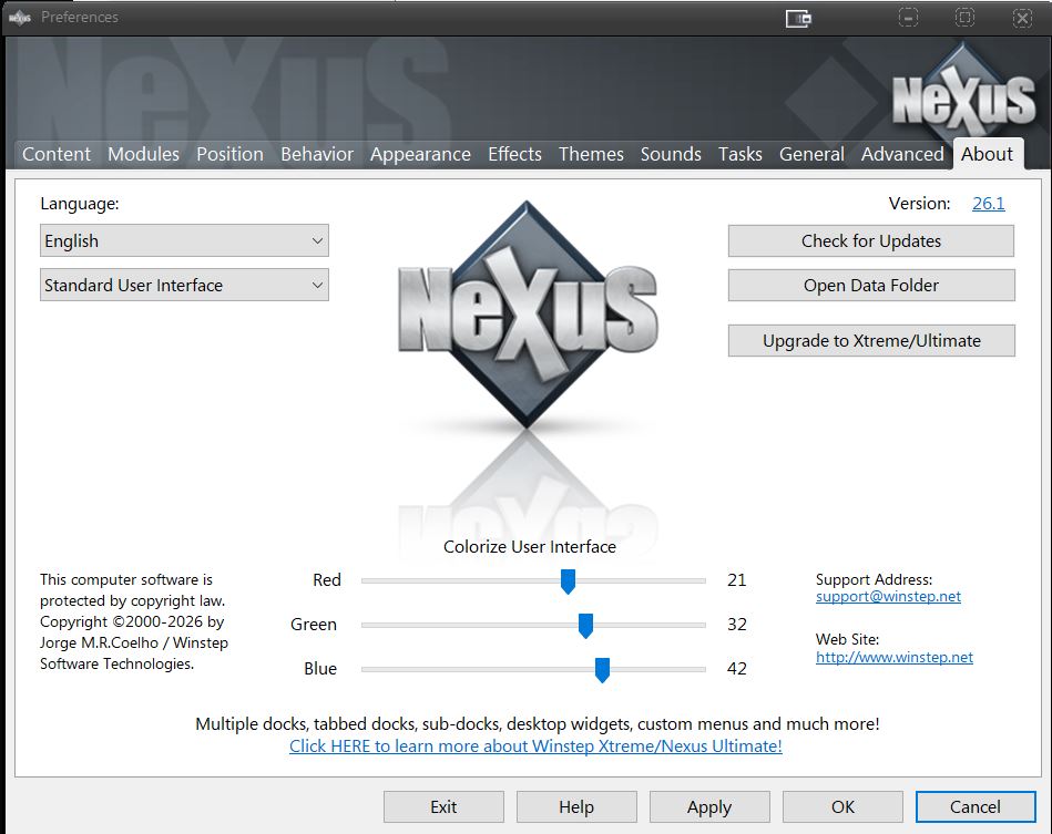

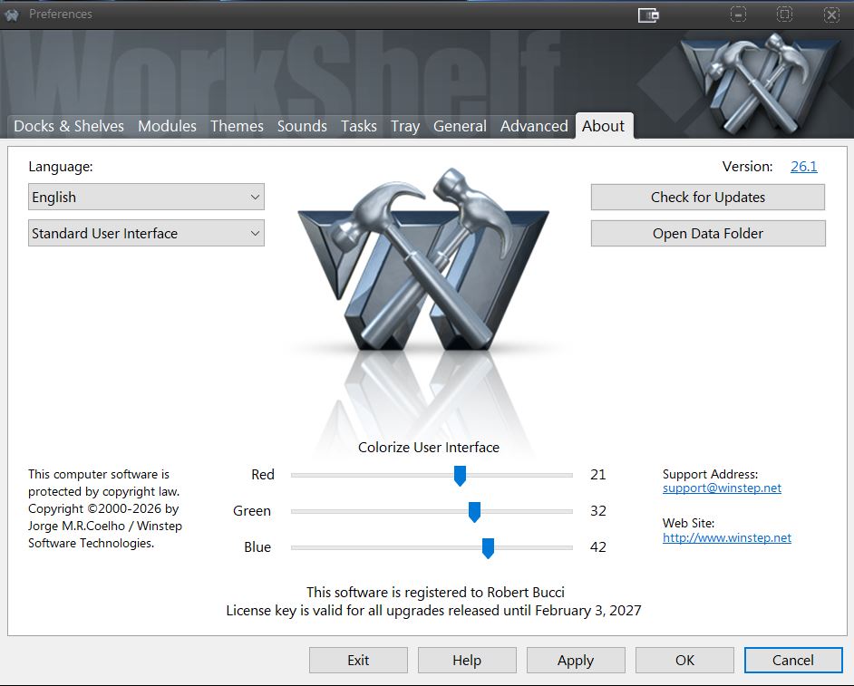

Hello,
I've been an Xtreme subscriber for many years, and while issues here and there with function, never a registration issue.
After the upgrade to 26.1 (both Xtreme and Nexus) I recently noticed in the about tab of Nexus that now there is a button stating to upgrade to Nexus Ultimate, which was not there prior.
Needing to renew my subscription on 2/3/26, figured I'd wait to see if the new wsxkey would resolve it, but it did not.
Screenshots attached of Xtreme and Nexus about tabs, not sure what other info may be needed for the support members here, so starting there.
Thank you in advance,
Bob
File comment: Nexus About tab
File comment: Xtreme Workshelf About tab

Bob, under Winstep Xtreme, WorkShelf *is* Nexus + desktop modules.
You should NOT be running the free version of Nexus at the same time as Winstep Xtreme.
On the original email with your Xtreme license key there were instructions on what to do when migrating from the free version of Nexus or upgrading from Nexus Ultimate to Winstep Xtreme.
Please read this Product Comparison Page to understand better what I am trying to explain.
Because the free version of Nexus and WorkShelf store their settings in a different place, the problem is that at this point I have no idea if the main dock you are using belongs to Nexus or to WorkShelf.
Normally the solution simply to exit Nexus and then delete Nexus.exe from C:\Program Files (x86)\Winstep\ , but before you do that I want you to go into the Advanced tab of Nexus Preferences and make a Backup of the Nexus settings there.
If when you exit Nexus your main dock disappears, then you should go to the advanced tab of WorkShelf Preferences, make a Backup of WorkShelf settings FIRST and then Restore the backup of your Nexus settings into WorkShelf.
I hope this makes sense.

Hello Jorge,
Thanks for the reply and info.
I was never aware after all these years, that I was running the free version of Nexus lol.
Nexus was in the Winstep program group in the windows start menu from the get-go from what I remember (I have shortcuts on the desktop for NextStart, Workshelf, and Nexus, in case I need to kill and restart them for any misbehavior), and built my main dock from that. I purchased the Xtreme suite off the bat, never used any free or trial versions. Though I can't remember if after that, after not seeing Nexus within Xtreme, I downloaded it thinking I was missing an app, which is possible.
I believe I get what you are saying, which is within Xtreme, Nexus isn't an app that is part of the suite, and a "Nexus" dock should just be a dock created within Workshelf? And that Nexus Ultimate is only for people who want a dock and not the rest of the apps?
Kind of a Doh moment just now, as my 4 non-main docks all have a Nexus icon in the dock, and I know they are part of the Workshelf docks.
I will try your steps in the morning, but I have had issues restoring backups (I make them regularly) of Workshelf and Nextstart with errors of something not being found though I can't remember what that something was, and manually rebuilt things.
One more question if I may - I have about 25 icons/shortcuts on my "free" Nexus main dock, and concerned I may get an error when restoring a backup. If I create a new main dock in Workshelf, can I drag my shortcuts from the existing free Nexus dock into the new Workshelf dock prior to deleting Nexus itself?
Appreciate the assistance :)
Bob
Yes... Under Winstep Xtreme, Nexus docks are handled by WorkShelf.
NextSTART was the first Winstep application to be developed, back in 98.
In 2002 the first beta of WorkShelf came out, with WorkShelf at the time being a single shelf plus the modules (iconic + desktop). Initially it did not support docks.
Docks were only added to WorkShelf around 2006 after much demand, and the free version of Nexus, featuring a single dock, only came out in 2009. It had to be extricated from WorkShelf with a forceps.
Nexus Ultimate was an interim version developed later for users who only wanted docks and shelves, but not the full blown Winstep Xtreme UI.
Yes, a bit confusing, even before the free stand alone version of Nexus, the docks within WorkShelf were already called "Nexus". Kind of a "two in one" package.
Yes, in that case it's best if you transfer the icons in the free version of Nexus via drag & drop to a dock in WorkShelf. Once you're finished exit the free version of Nexus to make sure you are not missing anything.
Once you are satisfied, just delete nexus.exe from C:\Program Files (x86)\Winstep\

Hello Jorge,
All set!
Sincere thanks for the help with this :D
