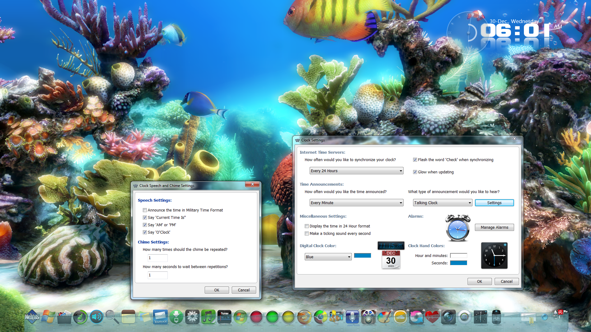

That definitely makes sense for the Alarm and am glad you made note of that during development, but the clock/time announcement still doesn't seem to work when all the parameters are set to make it work according to my screenshot below, unless I'm missing a crucial element somewhere else? There must be something that I'm overlooking because it did work in the past. I just can't figure out what it could be.
Just testing some other sound files, and some/a lot don't seem to work either with my set parameters in the screenshot above. Putting item in recycle bin doesn't make a sound, but empty recycling bin does make a sound. Mouseover doesn't make a sound. And others have their own concerns as well with respect to sound.
