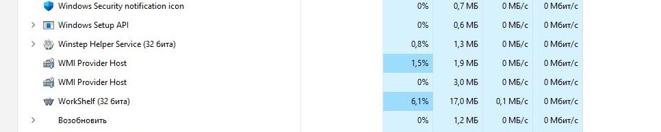

PostPosted: Mon Jul 27, 2026 8:19 am
Posts: 114
I'm monitoring the readings in the Task Manager.
PostPosted: Mon Jul 27, 2026 9:11 am
Posts: 13474
I rarely go into the Processes tab in Task Manager but when I did just now I noticed that WorkShelf (and NextSTART) are classified by Windows 11 as "Background Processes".
This means that on CPUs with hybrid P-Cores + E-Cores (Performance vs. Efficient cores) such as the 12900K, Windows 11 might push WorkShelf and NextSTART onto a E-Core instead of a P-Core. Being classified as a “Background process” can affect the CPU usage a process gets/consumes.
So if WorkShelf is pushed to an E‑core, it will:
    show higher CPU usage for the same amount of work
    show slower responsiveness
    show more jitter in animations and timers
    show more frequent spikes
    show reduced work output due to running on slower E‑cores
through no fault of its own.
I’m more and more convinced that the random prolonged high CPU usage on Windows 11 when idle was due to this together with the continuous Core Audio polling for the volume icon in the dock's tray. Both things only happen on Windows 11 systems which also explains why this was never an issue for Windows 10 users.

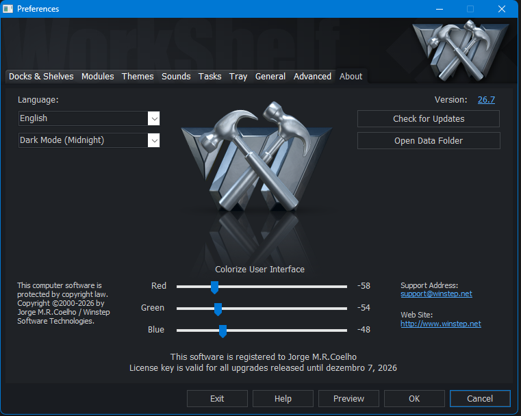

PostPosted: Mon Aug 03, 2026 9:34 pm
Posts: 13474
Added new UI theme/color scheme: Dark (Midnight).

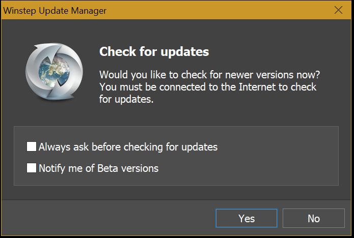

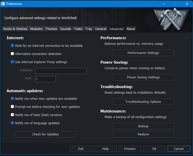

Also fixed a bug (sigh!) in the beta where the Winstep Update Manager "downloading..." window could appear either completely off-screen or not centered (depending on your screen resolution).
This happened because I accidentally dragged the window in the IDE and its startup position went from "Center Screen" to "Manual". When in manual mode the window appears at the position I have it here, and since I have a 4K monitor at 100% DPI...
I only noticed when doing some unrelated tests in the Windows 10 VM with a lower screen res and higher DPI, because here the window appeared basically where it normally would.
While fixing that I also modernized the dialog you will only see if you enable the "Prompt me before checking for new updates" setting (disabled by default).
It went from this:
to this
A bit better, IMO

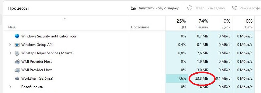

PostPosted: Mon Aug 03, 2026 10:28 pm
Posts: 114
have installed beta version 26.7 (beta version 4). Increased memory consumption?
PostPosted: Mon Aug 03, 2026 11:21 pm
Posts: 13474
Not really.
Besides, RAM usage depends on a lot of factors, what is being cached in memory, etc. Is that what you get immediately after launching WorkShelf or after some time of playing with it?
