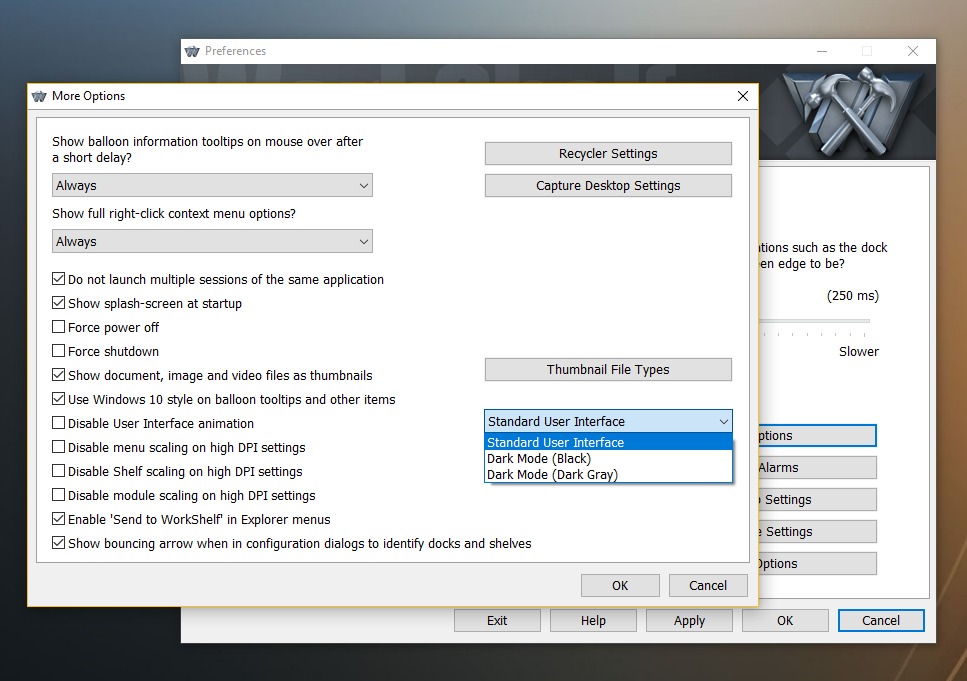

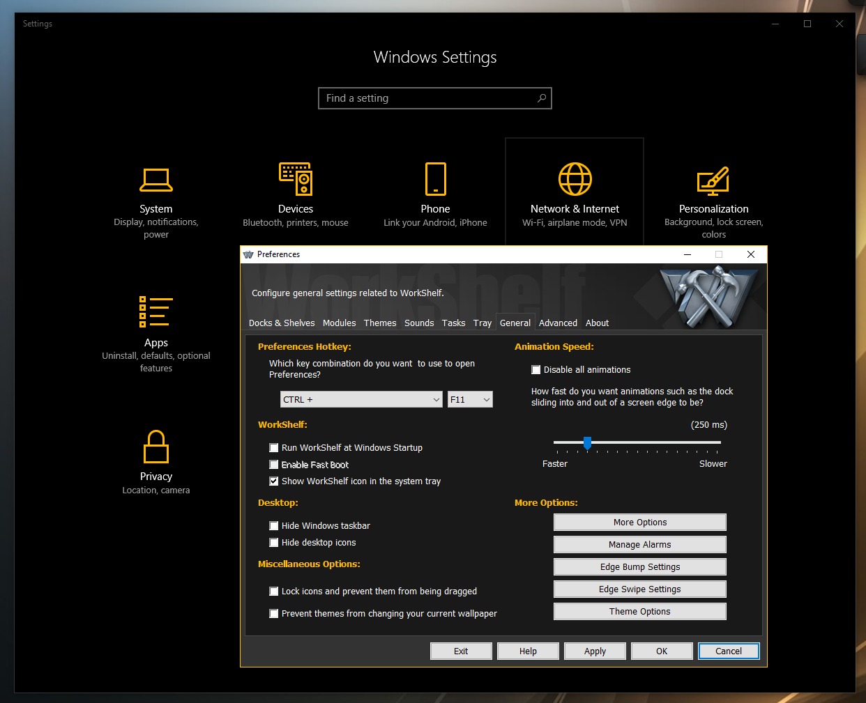

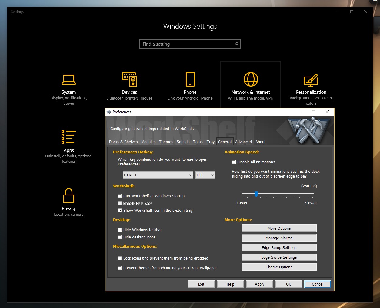

In the mean time, I have been making a lot of cosmetic changes to the UI (and finding and fixing some new bugs). I can't do any deep changes that would take me a long time to implement properly mostly because the drag & drop file copy/move operation bug (the comma in the filename) in v17.12 is pretty serious if you are affected by it, so it needs a new version out that fixes it ASAP.
At the same time, I wanted the new version to also have something new to play with, so I resumed working on my User Interface Dark Theme idea to match the Windows 10 Dark Theme mode. I really don't like the way Microsoft failed - deliberately, I think - to match the UI of Win32 applications with the overall look of Windows 10.
There are two extra modes, a black and a dark gray one. The result is, I think, not too bad (but please let me know your TRUE opinion), although there might still be room for improvement (if I decide to make buttons and combo boxes user-drawn, instead of using the standard Microsoft Common Controls Win32 look):

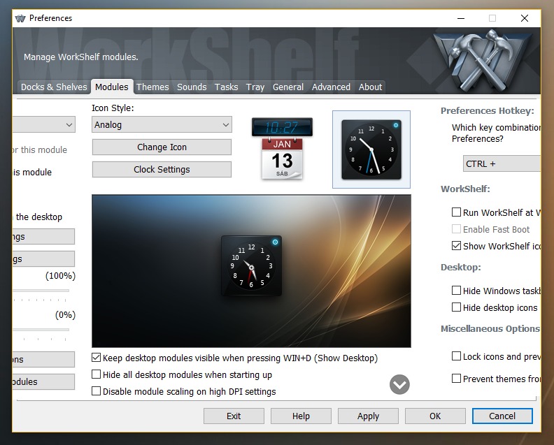

I also implemented a new tab switch slide effect as I mentioned previously, and although the effect itself is kind of cool (and I've also seen it on Linux, for instance) I'm not sure if I like it better than the instantaneous tab switch. Either way, it's optional (see new 'Disable User Interface Animation' setting in the first image) so it can be turned off - the real question is whether it should be the new default or not.
I know a static image does not make it justice, but to at least give you an idea what I am talking about, this is what would happen when going from the General tab in Preferences to the Modules tab (of course, the slide animation is pretty quick, at about 600 ms):
Jorge, from the screenshots, it looks good. And I'm sure you're right: MS wanted Win32 apps to look "out of place" in their shiny new (HEH!) 64-bit OS.
Sometimes a GIF is worth a thousand words . . . ;-)
