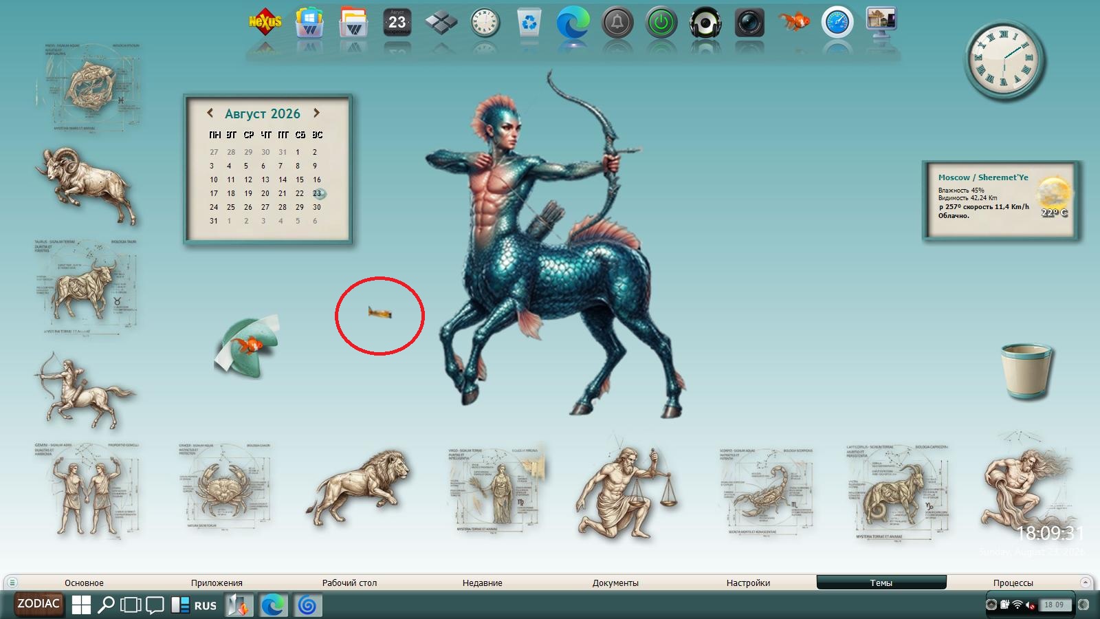

Respected BassdudeNZ! The Zodiac theme has been updated today! I noticed a slight inaccuracy. Or is that how it should be?

As for the formation of a double folder after the update. Example: \Themes\Foundation\Foundation\.
I cut the double folder from the theme. I moved it to the theme's shared folder. I inserted and replaced the files, and there is only one theme left in the shared folder: \Themes\Foundation\. I don't think it's a big mistake.

This is Scorpio overlapping which I have since fixed. If you would do me a favor and wait until approximately September the 16th, it would have done a full cycle. This way I can fix on the fly if any others show the same overlapping. I apologise for not being able to do it sooner. I need to be sure every one is fine. I think the rest are, but it is good to be sure.

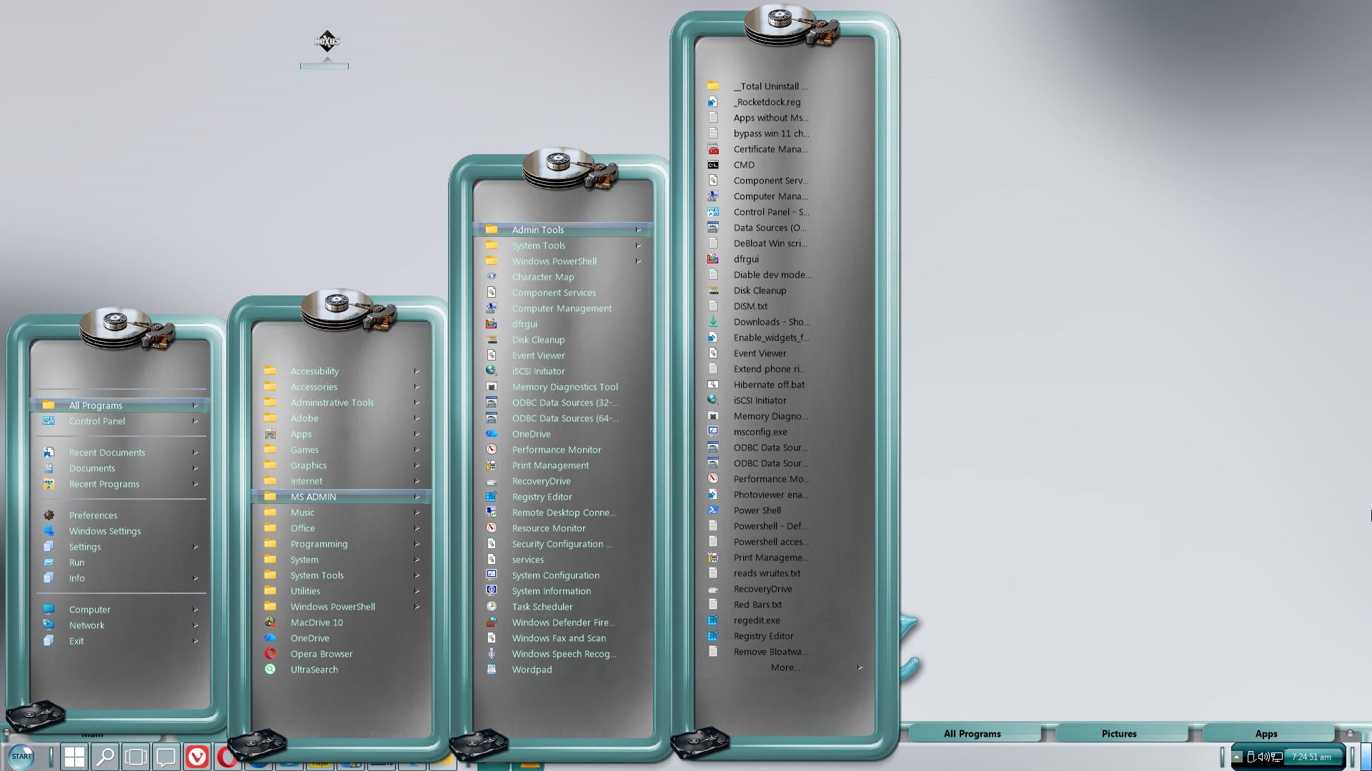

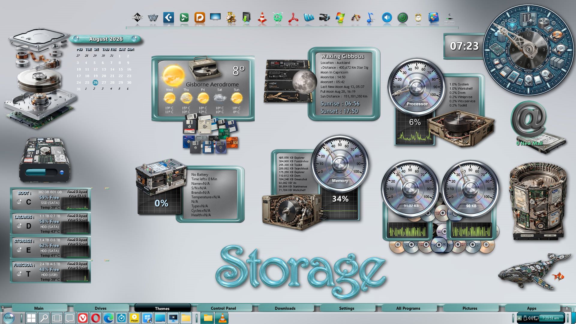

Based on Storage through time... even has all floppies, 5", 1.5, Zip disks, LS-120s, the old Washing machine hard disks, the very first removables, a dissection, and usage of aperture arms as meter arms...Quite difficult to get them sitting right...almost...
Trashcan is bigger than usual. details get lost otherwise if any smaller.
Another whole enchilada theme. Will test in Laptop tomorrow and upload if ok.

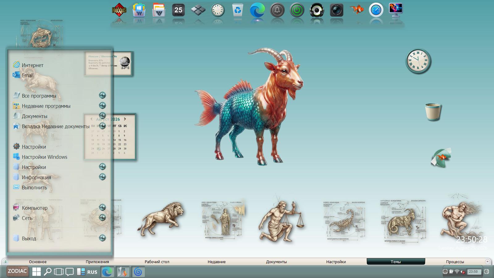

The "Zodiac Signs" theme was updated today. Everything is great! Capricorn with a fish tail! Wonderful plot! Thank you so much! I also increased the size of the Start menu in Settings. Exactly what I needed. :D :lol: :)
