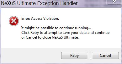

I'm getting the error when trying to delete an item from the dock.

Any type of item (i.e.; Internal Commands, modules, shortcuts to applications, etc...)? Did you try it with different items?
Also, how are you trying to delete the item? By dragging it to the Recycle Bin module or via the right click context menu? If the latter, does it crash too if you drag it to the Recycle Bin module?

Confirmed it has something to do with the new Windows updates, more reports coming in. This even affects versions as older as v12.2.
I've sent an email to all those who reported the crashes on the Uninstall Surveys with an email address, asking them to post here. Hopefully some of them will respond.
EDIT (1): THIS IS CAUSED BY A FAULTY MICROSOFT PATCH!

Confirmed! I backed out KB3097877 and tried again. All is well. It's definitely another botched patch from Microsoft. I'll watch for a re-issue of the patch and try it again.

Confirmed. The re-issue of KB3097877 plays nice with others. I was able to remove an item from the dock without crashing "Nexus Ultimate".
