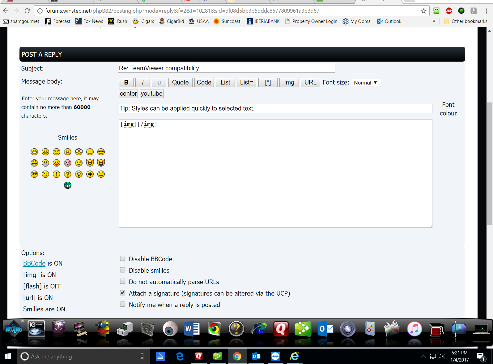

As you can see the dock is pretty much full width. I can remove some items if necessary to see if that makes any difference. Would two different size monitors make any difference? My primary monitor is a 19" 1600x1200 resolution (4:3 format) my left and right are 20" 1680x1050 (16:9) format.

 Post subject: Re: TeamViewer compatibility
PostPosted: Thu Jan 05, 2017 8:07 am
rtmeek wrote:
The only other thing I can see is when I am logged on through TeamViewer my primary monitor display on my desktop appears larger as if I have zoomed in from 125% to -say- 150%. The other two monitors stay the same with no change.
I think this might be the problem right there. Windows 10 added individual DPI scaling per monitor. This means you can have 100 DPIs in one monitor, 150 in another, and so on.
All fine and dandy, but the rest of the world is only just now beginning to add high DPI support to their applications. Now Microsoft wants you to add high-DPI support per-monitor too.
I don't even know how that works... I mean, what if you have half of one window in one monitor at 100 DPI and the other half in another monitor at 150 DPI?
Currently Winstep applications have full support for high DPI, but not for high DPI *per monitor*.
