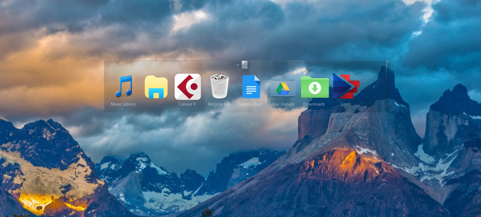

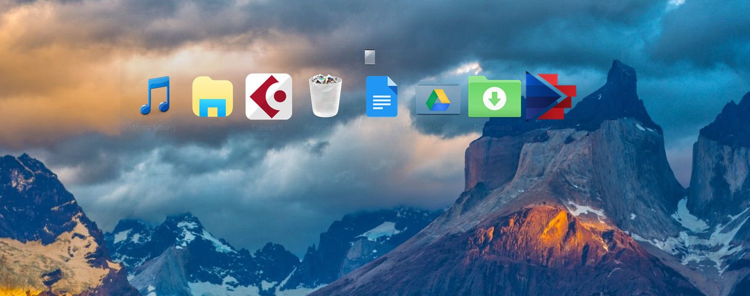

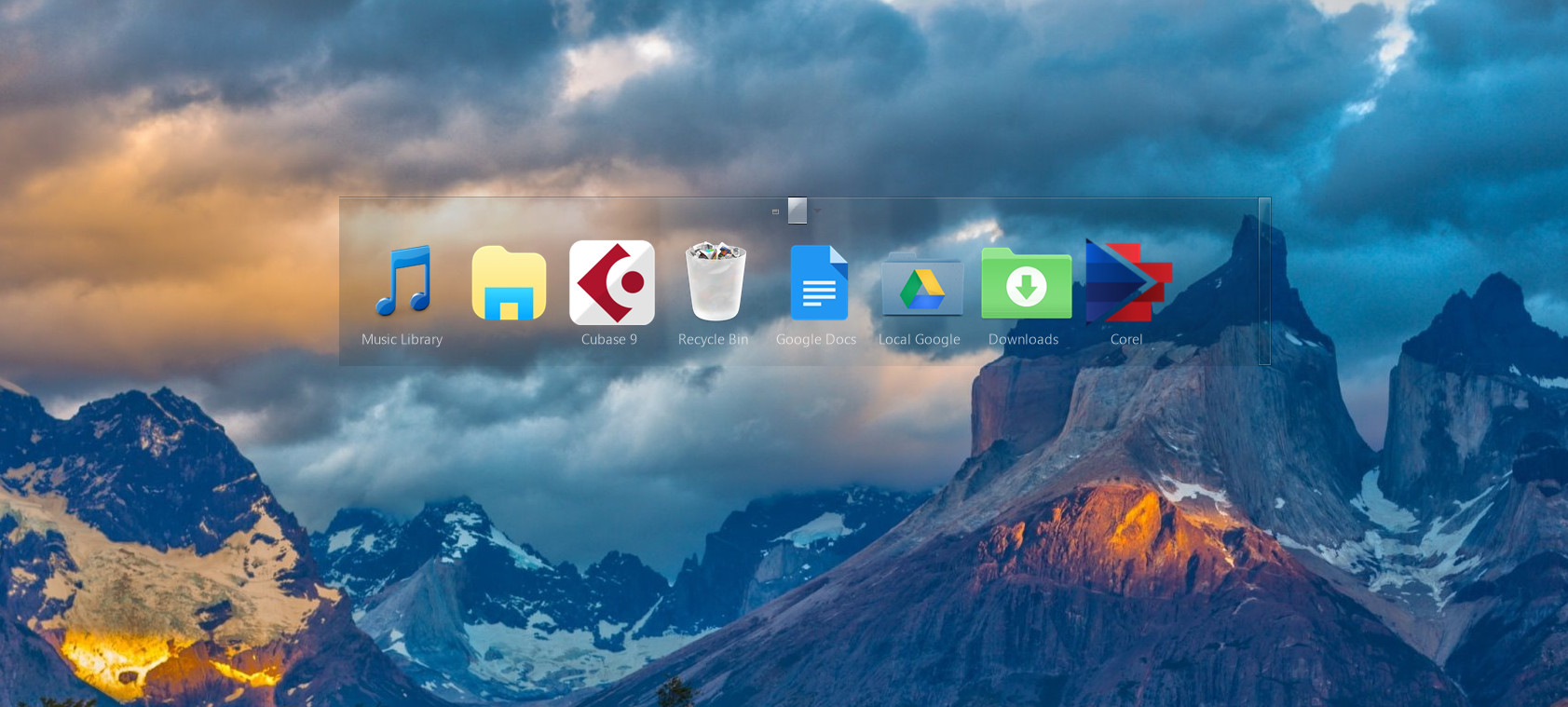

Hi. I was hoping you could help find a solution. I'm looking for a way to use Winstep Xtreme to replace my desktop icons. My goal is to have the icons/folders on my desktop with their labels visible, without a background (resembling the traditional windows desktop) Using Shelf, I can make the background of the shelf transparent (ie. invisible) but then the labels also become invisible. Is there a way to do this?
(see screenshots for reference)
File comment: I'm trying to get the shelf theme completely transparent/invisible
File comment: When I make the shelf background fully transparent, the icons ALSO disappear...
 Post subject: Re: Icons with labels, with no background
PostPosted: Sun Oct 15, 2017 5:47 pm
No, there currently isn't.
If I remember correctly, the reason has to do with the small label text size and how text anti-aliasing works in GDI+: anti-aliasing disregards the transparency values of the background, treating it as if it was fully solid. In practice this results in jagged and very hard to read text, unless the wallpaper (or whatever is behind the label) is almost the same color as the (transparent) Shelf background.

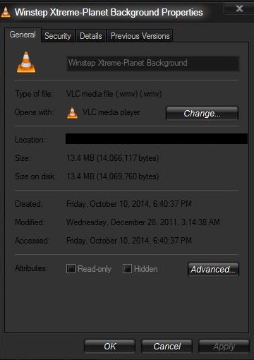

Jorge, is this the type of problem you're referring to that will happen with what the OP is trying to accomplish? This is a problem I have with a dark theme I have installed on my PC that happens when a dialog box is opened.
BTW, I've been hoping there is way to change the text color but so far I haven't found a way. The dev for the program never responded to my request. It appears it's because the program is years old and the dev is no longer replying to support questions.
