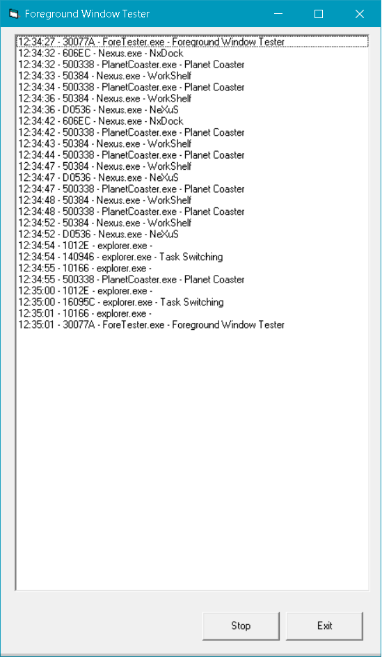

I have recently installed Nexus Dock 18.3 onto my Windows 10 system. I have spent the last couple of days setting it up exactly how I want but I have encountered a problem that I can't seem to fix no matter the solutions I have tried from other forum posts.
I have nexus dock set to show all the time except over top of maximised windows but I have it set to come forward when I hit the edge.
I went to load up a game (Planet Coaster) from an icon on the desktop (not from nexus). The games settings are set up for 1280x720 where as my native resolution is 1920x1080.
As soon as the game loads, nexus steals focus from the game. If I click on the application from the nexus dock then it goes into the game for a split second then nexus steals focus away again and it goes back to desktop again. However if I ALT-TAB back to the game the issue does not occur, instead it seems to bypass Nexus dock stealing the focus.
It is very much a pain in the ass having nexus steal the focus away from the game initially before having to alt-tab back to the game again. WHY IS NEXUS stealing the focus away if the game is in a different resolution to native.
I have also download the foretester.exe file and ran that while checking what was happening. And indeed it does seem to be stealing focus from the game unless I use the ALT-TAB method.

File comment: ForeTester.exe results
 Post subject: Re: Nexus Dock stealing focus from Fullscreen Games
PostPosted: Sun Apr 29, 2018 7:21 am
First of all, congratulations on the very detailed description of the problem and on having done the first troubleshooting options yourself.
I also think the issue is directly related to the change in screen resolution to run the game. Normally a change in screen resolution will cascade a series of events to make sure the dock fits on the new available screen space, etc...
However, this is prevented from happening if, after the change in screen resolution, Nexus detects a full screen application is running (e.g.; which normally would mean a game changed the screen resolution). It even waits half a second after a screen resolution change to make this test in order to give the game enough time to set itself up, etc...
For some reason it seems like its not detecting 'Planet Coaster' as a full screen game, so it proceeds to make a lot of changes which eventually steal focus away from the game.
One question: in the Position tab, are any of the 'Prevent maximized windows...' and 'Respect space reserved...' settings enabled? If so, try disabling them and let me know what happens, please.
Could you also try it with any other game that also changes screen resolution to see if the issue is just related to that particular game?

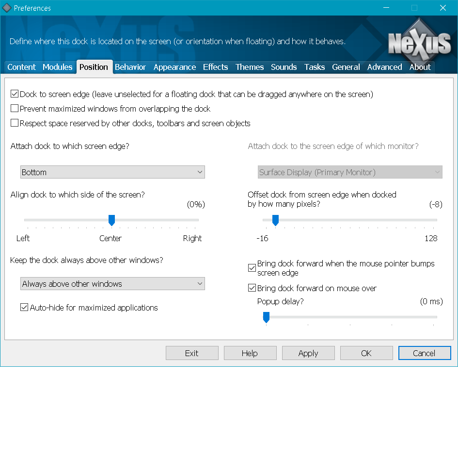

Both of those options are disabled. The only options I have regarding position enabled are "Autohide for Maximized Applications", "Dock to screen edge" and both "Bring dock forward" options. Please see screenshot for details.

File comment: Position tab in Nexus Dock

Also the ALT-TAB method I mentioned in the OP does not work all the time... Sometimes while ALT-TABing back into the game it does the same issue with Nexus stealing the focus again.

RaYneMan1186 wrote:
From my testing of different games it appears that most of them are not having any effect. I am thoroughly bewildered by what is causing this issue... PLEASE HELP!!!
Looks like something Planet Coaster is doing is causing the issue, then.
The only way to know for sure what is happening is to make a modified copy of nexus.exe that logs what is happening internally (as it's happening) to a log file, for me to review later.
But you will have to give me some time to do that.

RaYneMan1186 wrote:
Like I said I don't think it will be an issue on my main desktop but it is a bug nonetheless...
It's not a bug.
The alternative, as it happens with some other applications, is you removing a monitor or changing your screen resolution and suddenly being unable to access the other application because it is now somewhere off screen.
Nexus makes sure this doesn't happen, if you do any of the above, any off-screen objects (in this case the dock) are automatically moved to a visible area and made to fit in that same visible area.
The problem is that Windows never provided a method for a (game) application to warn the rest of the system saying "here, I'm changing the screen resolution, but it's only a temporary thing while I run, so don't you do anything in the mean time'.
So, applications like Nexus are forced to 'guess', and if the game does unusual things like using different windows to launch and run the actual game, you can end up with Nexus guessing wrong. As you can see from the tests you made with the other games, it guessed right nearly all of the time.
