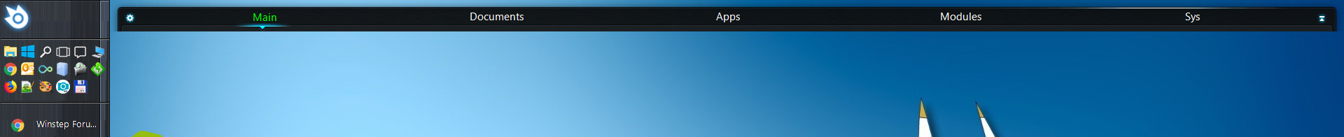

Hi, when taskbar is vertical, the shelf overlaps with it.
This is because programers set "Left=0" instead of "left=spiDektopArea"
Greetings!

Do you have the Shelf set to 'Respect space reserved by other docks, toolbars and screen objects' (Shelf Properties -> Position tab)?
 Post subject: Re: Shelf position error when taskbar is vertical
PostPosted: Wed Jul 04, 2018 9:53 pm
Posts: 31
Yes, i have it
PostPosted: Thu Jul 05, 2018 5:53 am
Well, you were right, and I fixed it for the next release.
HOWEVER, I have a nagging feeling Windows at some point changed the way appbars were working and that is what caused the problem.
ABM_QUERYPOS should return an adjusted rectangle for an appbar, and that should include adjusted coordinates for ALL edges, not just the requested docking edge. Ah well.

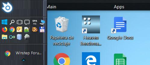

Ok, about 18.8 release, now it respect ok the space reserved, and do not overlap.
But for some strange reason, it generates a space (or margin) on left/top/right of desktop (see image)
Ahah. That's theme related - it's because of the alpha shadows at the edges of the Shelf background bitmap. Try a different theme or a white desktop background and you will see what I mean.
The space at the top is for the same reason and also because you have the Shelf docked to the top but inverted (i.e.; tabs on top).
