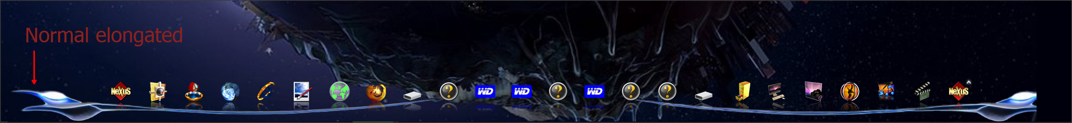

The other problem I'm having is that I can't enlarge the Shelf. I'm using the Serenity theme, removed the lines between icons and "Disable dock scaling on high DPI settings" is unchecked. It's far too small. How do I fix that?

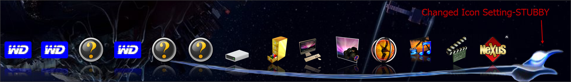

On a minor note, my dock theme Blue Lights doesn't show quite the same as it did on the Win7 PC. I have a feeling it's DPI related. The left and right edges look stubby, not as elongated as they are in the default icon mode (16X16), and no where as much as on the Win7 PC. The Win7 PC has a more stretched look and might not be the normal look because of the DPI settings.
If I leave the dock at the small icon default size (16X16), the dock displays similarly as it did on my Win7 PC, but once I change it, that's when it has the stubby appearance. BTW, the DPI settings are changed on the Win7 PC.
I checked (which looked crazy), and then unchecked (where it is now) the box/setting "Disable dock scaling on high DPI settings".
Here is the how the Blue Lights dock theme looks at 16X16.

This is how it looks when changed to a higher icon size.

As for the dock background, Blue Lights is the type of dock background that can look a bit different depending on icon size. It's just a by-product of how background stretching works, etc...
