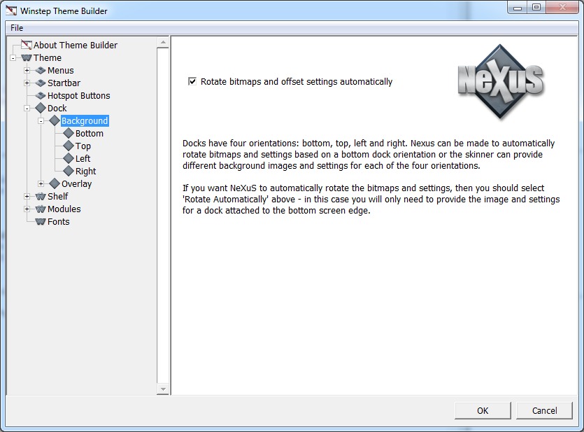

I started with a basic idea of a component tree view on the left with the actual skinning settings on the right. If you're running Nexus free, only the components for Nexus show up on the tree view, if Ultimate, only the components for Ultimate, and so on.
Also, to keep things simple, instead of making a 'mockup preview' of the theme being worked on in the Builder itself (which would mean duplicating a lot of code and bloating the Builder) the applications themselves are used to preview skins (actually not different from what happened back when the skinning Preferences were part of their GUI). So you press a button and the theme you are working on is instantly applied to Winstep Xtreme, thus allowing a 100% correct preview of what you are doing.
Something else that was very important was to make things easier to the skinner. Winstep skinning is based on using specific filenames for bitmap files (e.g.; nxbacktop.png for the background of a dock at the top, titlea.png for the titlebar of an active menu, etc...) and there are so many of them that they are hard, if not impossible, to memorize.
So, wherever a bitmap is required, the Builder accepts a bitmap file to be drag & dropped directly into it. The Builder itself will take care of giving it the correct name, so skinners no longer need to remember those.

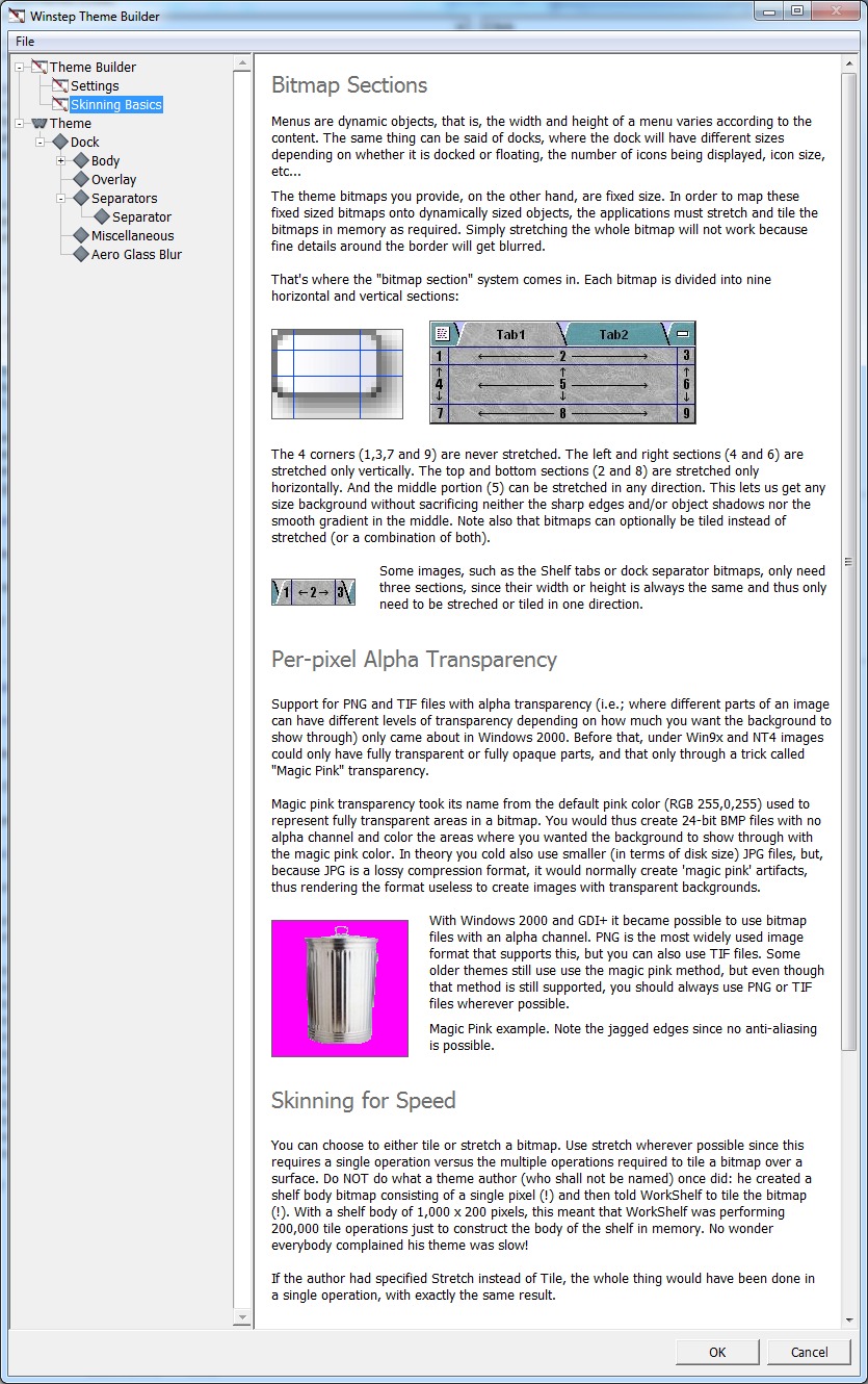

Something else I wanted to tackle is the fact that there are virtually no skinning tutorials even for some very well established skinnable applications out there. It's like if skinning was some arcane art that needed to be passed by word of mouth. :)
So, to help newbie and professional skinners alike, the Winstep Theme Builder will be as much a skinning tutorial as it is a theme builder. Skinning basics will be explained in it, and every setting, what it does and what it affects, will be described in detail with illustrated examples wherever possible.

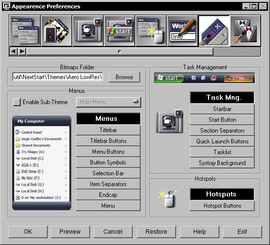

Of course, all this also means that what once (in the old v9.5) required a single panel of settings now requires several pages. But I think it's worth it.
Old skinning pannel for Nexus:
Same thing in the new Theme Builder:

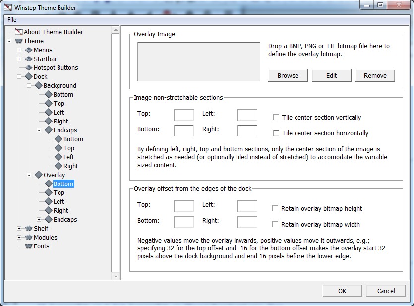

Just some remarks that puzzled me when making a Winstep skin:
1. Referring to Background Image settings section "Image non-stretchable settings" (same for Overlay) in your pictures above.
The text below the boxes says that only the center section is stretched or tiled as needed. This implies that the width of the Top and Bottom section will never be stretched or tiled if needed, which must look awkward. They are of course tiled or stretched if needed (same for the height of the Left and Right section). There is however no clou what it will be: tiled or stretched. Also there are no boxes to select either of these options. This is a bit puzzling. Especially when having experiences with WindowBlinds (Skinstudio), which does provide boxes to select all these options.

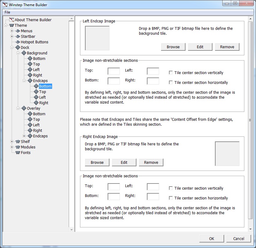

2. Question I had when making a Winstep Theme: Can I make Endcaps with specified width and without content (icons)? (i.e. just for decoration)
3. Concerning Shelf: Tried making a shelf which docked at the bottom of the screen is divided into three parts: a heigh top part, a middle part (for the icons) and a low bottom part. When docked on top, the low bottom part should become the low top part (so Shelf background should be flipped). Next I wanted to be able to put the tabs either on the top or the bottom (without an additional flip of the Shelf background). I tried all kinds of combinations (using wsFullBody as well as wsFullBodyF pictures) to see if this could be accomplished. It took me a while to find out that this is not possible. Just an example of a feature that needs a bit more information on how it actually works to be useable.
Hope these remarks are helpful. Looking forward to use Winstep Theme builder.
Yes, yes, I already changed that text. Remember this is work in progress, not even at alpha stage yet, everything is almost a 'filler' and subject to change.
For instance, I explain how it works in a small one page tutorial about Skinning Basics:
Yes, those are called 'Extended Endcaps'.

Just to clarify my thoughs and how I run into questions:
I noticed in the explanation above that sections 3, 4, 6 and 8 are stretched when needed. Question remains why they cannot be tiled, since this sometimes looks much better (if these parts have a structure). Just missing the logic here, I would expect both options (tiling and stretching) to be available for these sections.
Since both options are not available, I am starting to ask myself why not. Is it because you can achieve 'tiling' in a different way? Am I missing something obvious? Can I make sections 2 and 8 wider than fits on any available monitor and will then the right part of sections 2 and 8 (in excess) simply be cut off or will this not be the case and will sections 2 and 8 be squezed to fit? That kind of things keeps me busy sometimes. Most of the time this happens when I have a good idea of how it should look like, just (after some trying) to find out that it cannot be realized the way I wanted it.
Yes. The text says:
"The 4 corners (1,3,7 and 9) are never stretched. The left and right sections (4 and 6) are stretched only vertically. The top and bottom sections (2 and 8) are stretched only horizontally. And the middle portion (5) can be stretched in any direction. This lets us get any size background without sacrificing neither the sharp edges and/or object shadows nor the smooth gradient in the middle. Note also that bitmaps can optionally be tiled instead of stretched (or a combination of both)."

Aha, now I see. Did not look good enough. In the new Theme Builder you can apply settings for bottom, top, left and right parts of an image separately.
