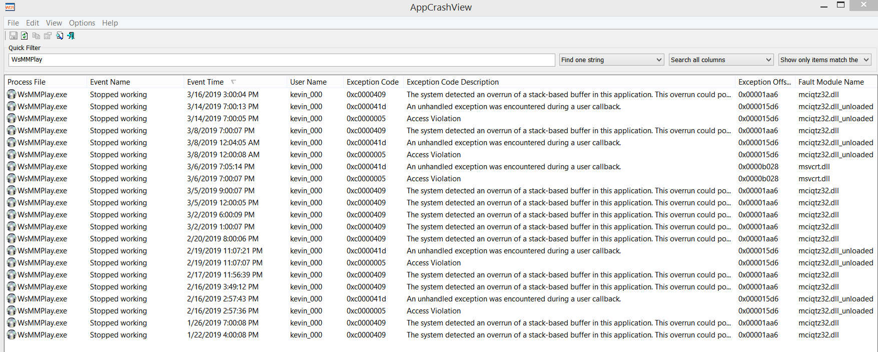

This one has been nagging me since I started using Winstep Nexus.
Regular access violation and stack overflows. Seems to be only on my Win8.1 machine. The Win 10 machines seem happy.
Here is the stack overflow:

The access violation:

Suggestions ?
 Post subject: Re: Winstep Media Player has stopped working
PostPosted: Sun Mar 17, 2019 8:48 pm
This is EXACTLY WHY the Winstep application uses WsMMPlay.exe as a *proxy* to play MP3 media files instead of doing it directly.
Your problem is a (are) buggy audio codec/driver. When an application tells Windows to play an audio file, the 3rd party code that does the actual playing runs within the process space of that same application. If the code is buggy and trashes the stack or corrupts memory, it's the host application that ends up crashing through no fault of its own, usually with no indication of the TRUE culprit.
For instance, had you not noticed that this was not happenning on your Windows 10 machine, you would have likely concluded that WsMMPlay.exe was a buggy pile of steaming c*rp. :) Now imagine if the main application was crashing instead, even worse.
In reality WsMMPlay.exe is as simple and as bug free as it can get. It is just taking the bullet for the main Winstep application (poor thing).
So, try uninstalling any 3rd party codec packs you might have installed on your system and installing a different one - personally I use the K-LITE codec pack, hasn't given me any problems.

I'll give it a try.
My first thought is why don't I see this with any other apps playing .mp3s ?
What is being done here which is different than every other app ?
PostPosted: Mon Mar 18, 2019 4:55 pm
Good question and one I don't really have an answer for because I don't know what the other apps are doing.
All WsMMPlay.exe does is use the Windows mciSendString API call to play the files. All the actual playing is done by Windows itself, but, of course, the required 3rd party DLLs etc will be run *inside* the WsMMPlay process.
If one of those DLLs is buggy or badly coded and trashes the return stack or something like that, you get unexpected behavior, such as crashes. Actually this is the first time I read about WsMMPlay actually crashing, before I started using it you got REALLY WEIRD behavior in the main application itself.
If you want to know how difficult it was to diagnose and eventually work around bad codec/filter problems by using the WsMMPlay.exe 'proxy' player, feel free to read THIS THREAD. All 12 pages of it. :)
This is not new. There used to be a Control Panel Logitech webcam applet that also trashed the stack - it caused any application that simply enumerated the contents of the Windows Control Panel (required to display the Control Panel tab in the Shelf or the Control Panel menu in NextSTART) to crash.
Explorer *seemed* immune to it, but probably because Microsoft already had plenty of experience with buggy 3rd party DLLs and did this enumeration on a separate 'sacrificial' thread. Figuring out what all the users experiencing this issue had in common (the Logitech webcam Control Panel applet) was also a novel by itself.
Once I figured out what the cause was, I was able to work around it - but not fix it, because I cannot fix buggy 3rd party code. Logitech also had no incentive to fix it (assuming they were even aware of it) because Explorer itself did not crash (although EVERY OTHER application that enumerated Control Panel items would - I know because I tried several).
