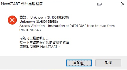

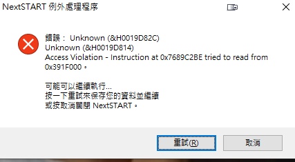

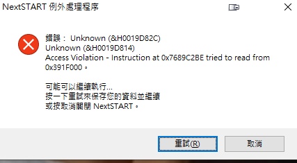

Nextstart get access violation error when it launch a few second,and then it crash.
Any solution to solve this?
I am running winstep extreme on windows 10 and I have Bitdefender running incase this will affect the problem.
These were the error that pops up,same error but with different codes.
 Post subject: Re: Nextstart get access violation error
PostPosted: Tue Feb 18, 2020 5:08 pm
Ouch. Hard to diagnose in Chinese.
Did this begin happening immediately after installing Winstep Xtreme or only after doing some changes to NextSTART?

It happen right after the first launch,I can't even get to the config step,the taskbar showup and then error pops up then crash.
It can be run if it got lucky,but when I press Win Key it will bring up the start menu but the taskbar won't show up in full screen application.
Hope this can be solve,if not,looks like I pay extra for nothing lol,the nexus dock was great though. :(

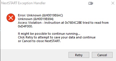

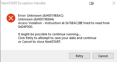

:D Got it

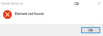

Also I forgot to mention,when the nextstart work,some of the shortcut on the taskbar were not working and got this error "Element not found"
File comment: Explorer error
PostPosted: Tue Feb 18, 2020 6:22 pm
Well, I was kind of hoping to see something other than ntdll.dll in there (which would point the finger at a 3rd party application) - the fact that the error doesn't always happen doesn't help either. Random errors are a PITA to diagnose.
Out of how many <x> launches do you get 'lucky' with no error?
Also, try the following:
Open the Windows Registry, navigate to
HKEY_CURRENT_USER\Software\WinSTEP2000\NextSTART
now look for the
StartbarQkRefresh
entry and change the value from True to False.
This will prevent NextSTART from automatically retrieving Windows Quick Launch shortcuts at startup (which are basically no longer used in Windows 10 anyway), just in case that is what is causing the problem.
Now try running NextSTART again.

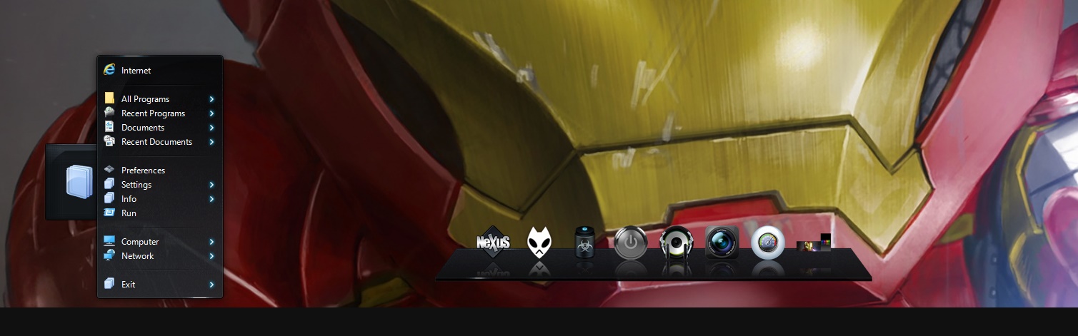

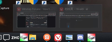

Now it won't run after reboot,manully run it,it doesn't show the taskbar,but have this
I manully set it replace the taskbar in the preference,and this time it doesn't have the error pop up.

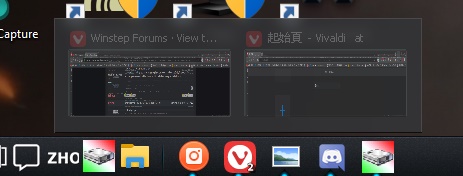

:oops: Two more question,when I left click the taskbar it doesn't minimize and bring to top which suppose to be

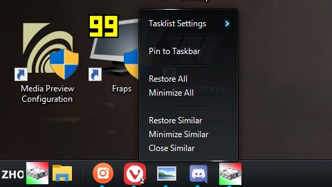

And Right Click it shows this,which dosen't related to the original function
Is these cause by the error or by design?If these is by design,I may not wanted to use the Nextstart :oops: just saying before you dig deep to diagnose.
PostPosted: Tue Feb 18, 2020 7:33 pm
You are supposed to left/right click the preview **thumbnails** of the running applications, not the icon itself - then it will behave as you expect.
The NextSTART taskbar is not just a 're-skin' of the Windows taskbar, it also has other functions and behaves a bit differently.
