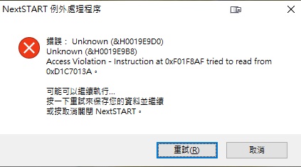

Nextstart get access violation error when it launch a few second,and then it crash.
Any solution to solve this?
I am running winstep extreme on windows 10 and I have Bitdefender running incase this will affect the problem.
These were the error that pops up,same error but with different codes.

Ouch. Hard to diagnose in Chinese.
Did this begin happening immediately after installing Winstep Xtreme or only after doing some changes to NextSTART?

It happen right after the first launch,I can't even get to the config step,the taskbar showup and then error pops up then crash.
It can be run if it got lucky,but when I press Win Key it will bring up the start menu but the taskbar won't show up in full screen application.
Hope this can be solve,if not,looks like I pay extra for nothing lol,the nexus dock was great though. :(
You mean if you hit the 'Retry' button in that dialog?
Once it runs, does it do so without that error popping up again?
This is very difficult to diagnose if it is in any way related to the Chinese language as I can't install it here and, even if I could, I would be totally lost in a Chinese version of Windows. :) I take it WorkShelf has no such problem?
One more question:
Windows Control Panel -> Region -> Administrative tab -> Change System Locale button
Is 'Beta: Use Unicode UTF-8 for worldwide language support' checked? I know it can cause problems if it is.
Also, open the Windows Event Viewer -> Windows Logs -> Application
Look for the crash entry related to NextSTART. Can you please copy the text and paste it here?

No,it got lucky that nothing pops up and it work,but if it got error,hit the retry buttton will lead to a endless loop until I hit cancel.
The Unicode option is uncheck by default.
I only find one log with a "!Error" related,I can try to switch the system language to english to see if I can copy it in english.

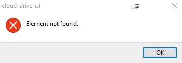

Also I forgot to mention,when the nextstart work,some of the shortcut on the taskbar were not working and got this error "Element not found"
File comment: Explorer error

Well, I was kind of hoping to see something other than ntdll.dll in there (which would point the finger at a 3rd party application) - the fact that the error doesn't always happen doesn't help either. Random errors are a PITA to diagnose.
Out of how many <x> launches do you get 'lucky' with no error?
Also, try the following:
Open the Windows Registry, navigate to
HKEY_CURRENT_USER\Software\WinSTEP2000\NextSTART
now look for the
StartbarQkRefresh
entry and change the value from True to False.
This will prevent NextSTART from automatically retrieving Windows Quick Launch shortcuts at startup (which are basically no longer used in Windows 10 anyway), just in case that is what is causing the problem.
Now try running NextSTART again.
