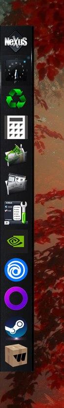

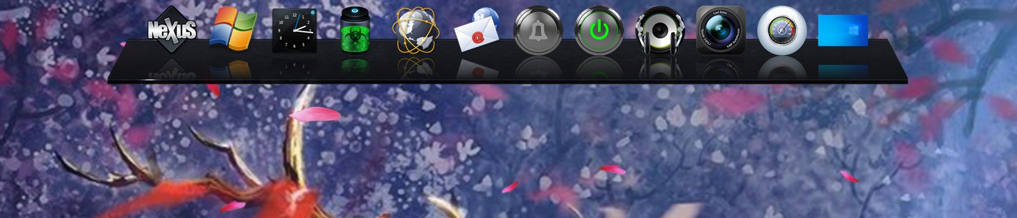

I Attached two Files. The Notebook File shows how i designed it so far and the Desktop File shows how it looked like when i installed Winstep AND integrated the Backup Files. Also the Sounds for the shelf are back. Originally i deactivated them. So i would assume the backup function is somewhat broken. At least for the trial version?

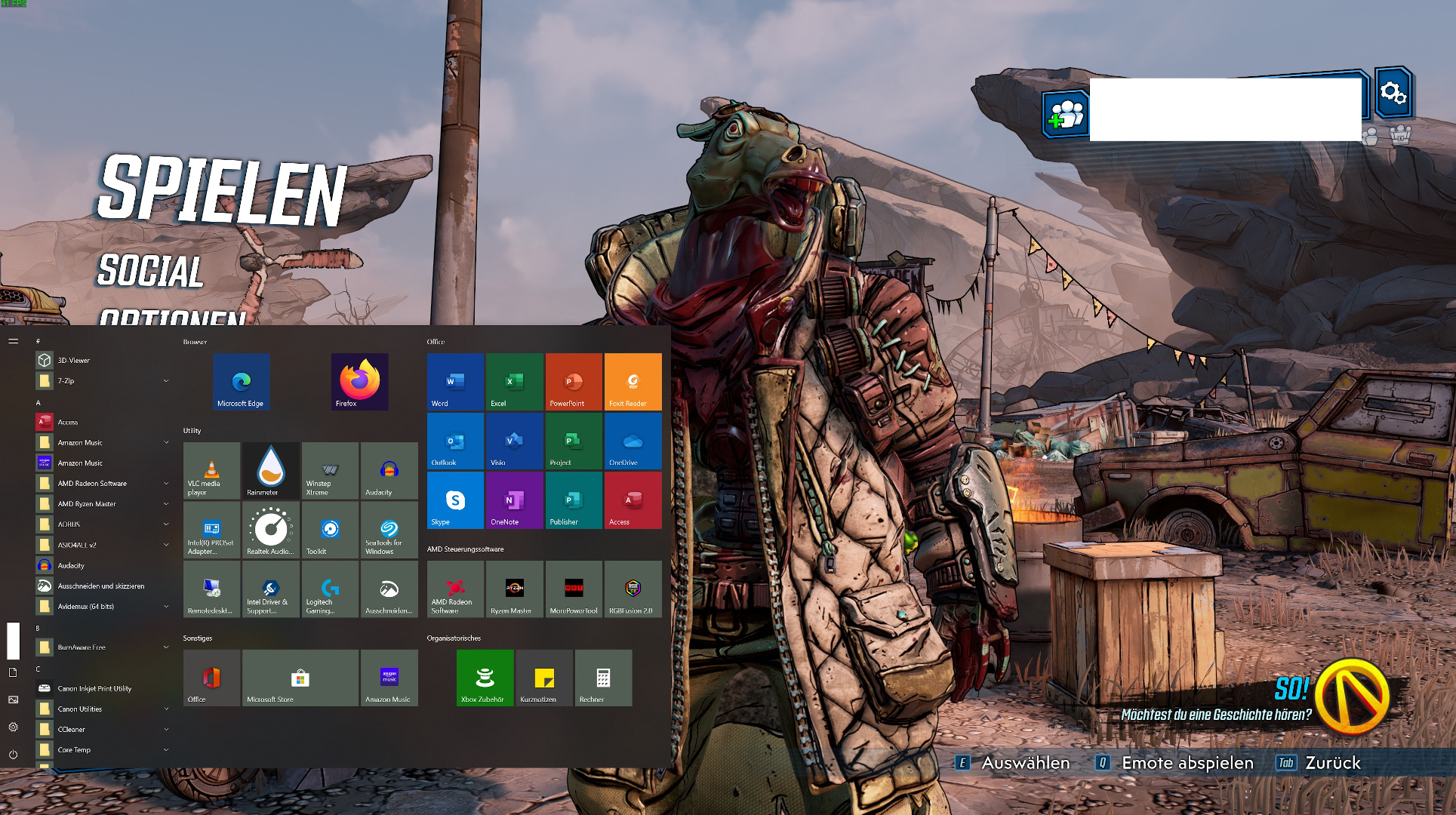

Well its me again. Now i have some other difficulties that are beyond my reason. FIrst ob I am often working with the Windows Key to tab out of a game. But the Taskbar is always invisible. I know i could make it always visible, but then I have the taskbar, well, always visible. Also in Games. I woul love to know were I could find a setting to make the Taskbar visible only when i press a button like the Windows Key. It looks like this while gaming and fast tabing out of the game:

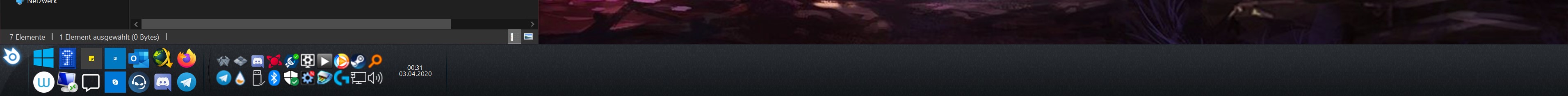

I played with the settings a bit and hit the button to stretch or shorten the Taskbar. I got then the issue that my Taskbar now looks like this:
A bit confusing to understand what you mean. The Win key is reserved by the system, so it cannot be used for anything (or what it does changed) by the Winstep application. Simply pressing WIN will always display the Windows Start Menu.
Please feel free to play with the settings, as this is mostly how you learn how everything works. However, it is ALWAYS a good idea to make a backup of your current (good) known settings so you have something to go back to in case you manage to paint yourself into a corner.
In the above case it seems to me like you have changed the order of the taskbar sections, and that the 'running application taskbar buttons' area is now AFTER all the other areas. Either that or you disabled this area.
Open NextSTART Preferences, go to the Taskbar tab, click the Taskbar Settings button. Now click the Taskbar Sections button in the dialog that opens,
Make sure 'Start Button', 'Quick Launch', 'Tasklist' and 'System Tray' at the bottom are all checked and use the 'Up' and 'Down' buttons so that the order is Start Button, Quick Launch, Tasklist and then Sytem Tray at the very end.
OKay maybe it is because I am not an native speaker so sorry if i cause any misunderstandings this way. My particular Problem with this behaviour ist, that normally (Without WInstep running) by pressing the Win Key not only opens the Star Menu, but also pulls the Taskbar in the foreground, so that I can navigate from the Taskbar. Winstep has (as far as i managed to overlook the Setting) only the option to be always in the foreground, not by pressing a button like the Win Key.
I hope this made my issue a bit clearer ^^"
Yep, that saved my butt here ^^
Thank yopu for your guidance with this setting problem anyways. I will remember it if I have this Issue again.
