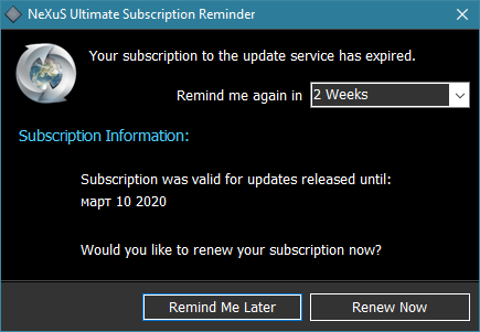

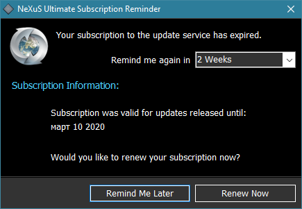

Hi,
First of all I would like to thank you for the wonderful software. I have been a subscriber of Nexus Ultimate for the last 5-7 years (don't remember exactly) and I definitely plan to be in the future because I like it very much.
I have the following problem. My yearly license expired 4 days ago and I still haven't renewed. The subscription reminder popup comes out every 2 minutes even when I tell it to remind me in 1 day or 2 weeks - it continues to pop out every 1-2 minutes.
This is very annoying because the popup always places itself on top of all windows.
Is this "nag" done on purpose? I mean, of course the reminder is on purpose, but I guess the postponing options should work I guess.
I tried everything - clicking the "Remind me later", clicking on the X to close it, clicking on "Renew now", set it to "Never" - nothing stops the annoying popup.
Yes, I will renew but I would like to do this at my discretion :)

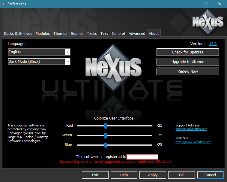

Just wanted to add that the license is working, although expired.

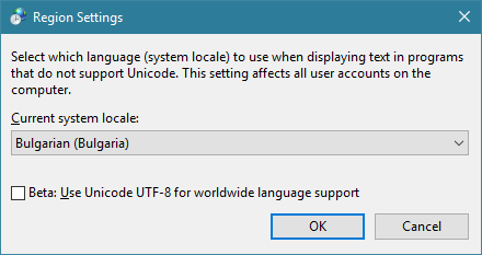

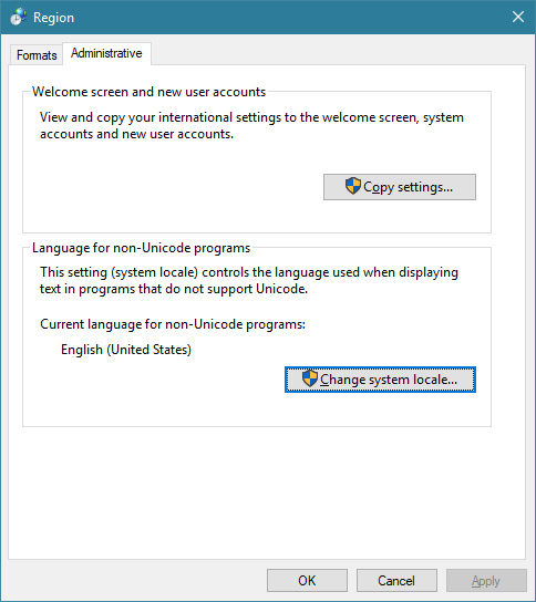

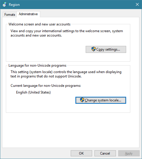

This made me realize that I have my locale set to Bulgarian and I need to change the Windows setting that takes care of non-Unicode programs:
Changed it to Bulgarian:
and restarted.
After that I repeated the process and the value this time is "мар 15 2021" which in English reads "March 15 2021".
Voila, the problem is gone!
Thanks again for your guidance!
