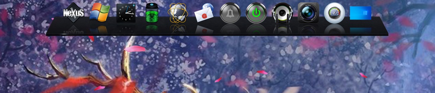

Thank you your reply. Thank you for your answer, but this does not help do be honest. I already used both backup mechanics for "Shelf" and "START". But many settings are not applied.
My Dock does not look like the one i configurated, so i assumed that there are problems with the backups.
I Attached two Files. The Notebook File shows how i designed it so far and the Desktop File shows how it looked like when i installed Winstep AND integrated the Backup Files. Also the Sounds for the shelf are back. Originally i deactivated them. So i would assume the backup function is somewhat broken. At least for the trial version?
I would really like to know were i can manually backup the whole programm files.

Sorry, that is not even possible, you must be doing something wrong.
Please try the following: in your Notebook, open WorkShelf Preferences, go to the Advanced tab and click the Backup button. Now give your backup a *unique* name, e.g.; "this is my test backup".
Now go to your desktop PC, open WorkShelf Preferences, go to the Advanced tab and click the Restore button. Make sure the backup you select to restore from is the one with the unique name you just gave it on your notebook.
Let me know what happened, please.

Well paint me green and call me a cucumber. I swear on everything that's holy to me that i did exactly the same as i did the first time making Backups for WorkShelf and NextSTART but this time it worked. The only difference this time was, that i renamed the two files. I still assume, that there was some error somewhere if i am honest.
Thank you anyways. Now i can try out individualizing Winstep on my desktop. SO far, i am pleased except for the little inconvenience. ^^
