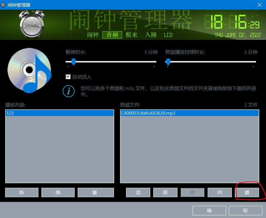

As shown in the picture, I thought of a lot of ways to always open the sound of the alarm clock.

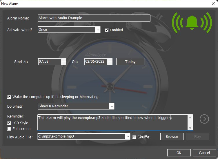

You need to specify an MP3 audio file in the 'Play Audio File:' field of the New Alarm panel:
Also, check THIS LINK out.
Finally, are you in China or running a Chinese version of Windows? It looks like it. If so perhaps you could help me verify that an issue related to a bug with Far Eastern languages in the User Interface has indeed been corrected?

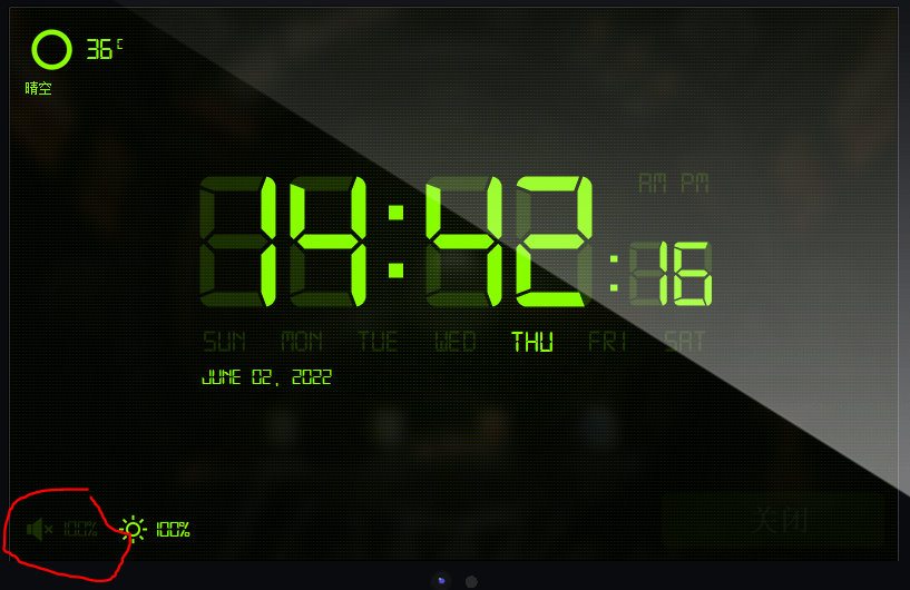

First of all, thank you for your reply. I am indeed in China and use Chinese version of Windows.

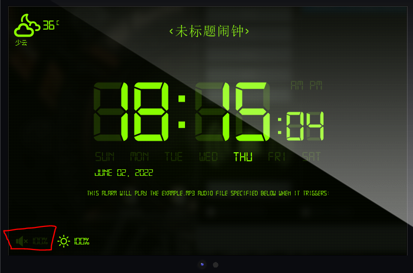

I did it your way, but it still didn't solve the problem, that is, the alarm still didn't sound, and I found that everything about the audio didn't play.
As shown in the figure:

Dud you check windows volume mixer, maybe its muted there?
im not on my pc atm so i cant check what allarm shows if its muted in Windows

yes, it looks exacrly like that

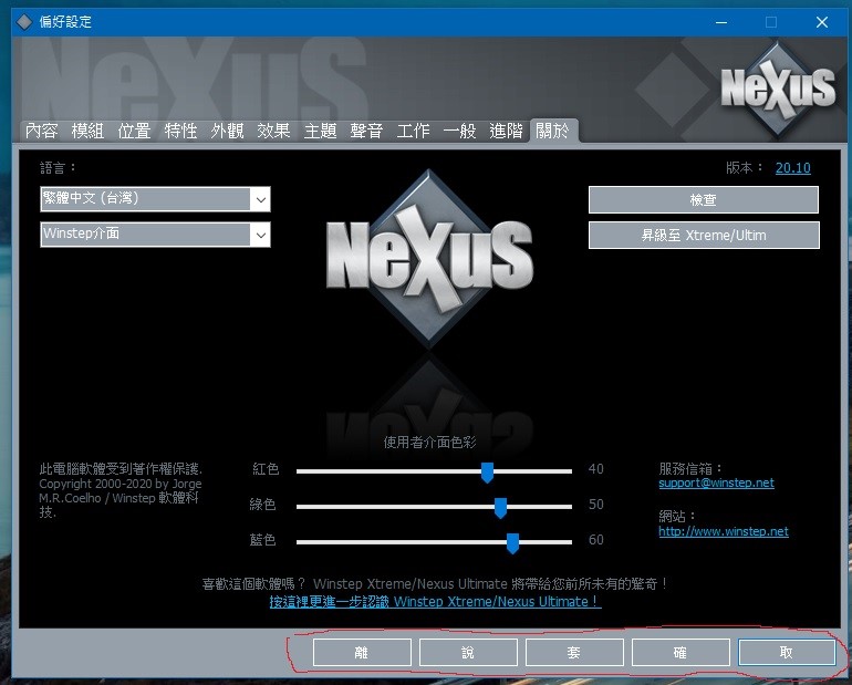

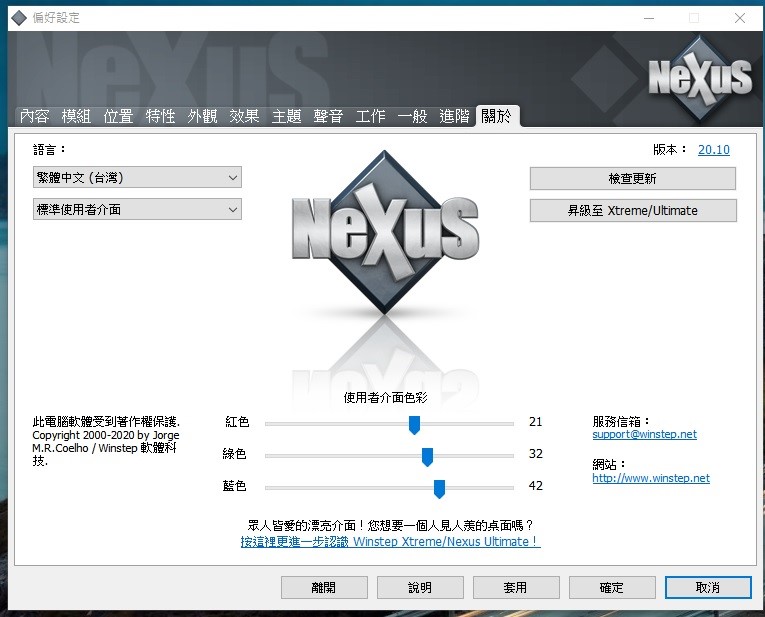

Something else regarding what I mentioned above about the Chinese characters, if you open Preferences and look at the buttons at the bottom, are Chinese characters being "eaten" whenever you have a UI mode other than 'Standard Interface' ?
For instance, this is how it should appear:
Note specifically the Chinese text in the buttons:
But when another UI mode is selected, the Chinese characters seem to be "cropped", looking like this:
Does this also happen to you? I don't know how to read Chinese so I can't tell for sure, but it does seem so, no?

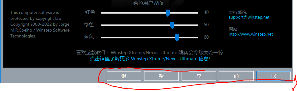

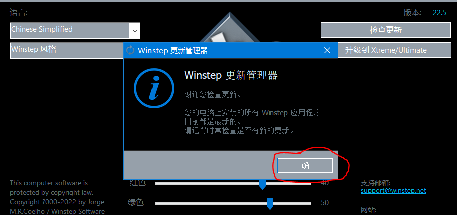

I installed the Nexus v22.5 beta and the text cropping issue was finally solved. I checked and found that most of them were resolved, only the prompt box text that popped up when I clicked on the "Check for Updates" button was cropped.
The audio issue remains unresolved and never plays. I was desperate.

First of all, thanks for confirming that the cropping text issue has indeed been solved (and for pointing out that I had forgotten to fix it in the Winstep Update Manager as well).

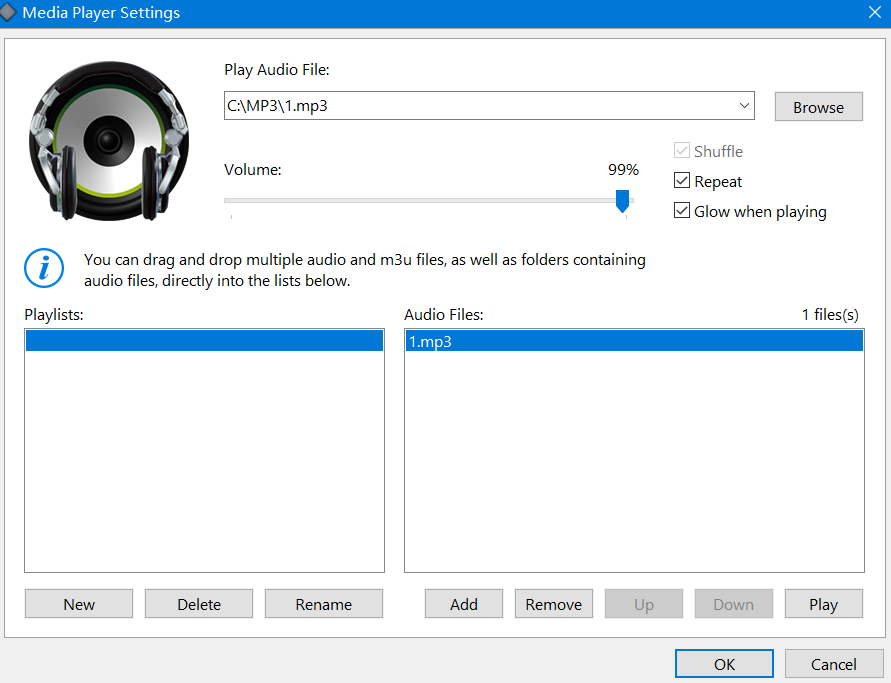

The MP3 not playing is getting on my nerves. If you can hear the clock voices, etc, there is no reason for your MP3 audio files not to play as well.
Add the Winstep Media Player to the dock by right clicking on the dock -> Insert New Dock Item -> Internal Command -> Media -> Media Player
Now right click on the Winstep Media Player icon and select Media Player Settings. Drag MP3 files to the panel at the right, play with the Media Player a bit. Can you get ANY of the MP3 files to play?

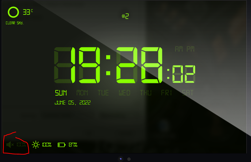

Thank you for the gift you gave me, I loved it and it was successfully installed and registered. However, after installation, there was a problem of Chinese characters being cropped, but it did not affect.
As for the mp3 audio, I was completely desperate, I tried it over and over again, but it didn't work out, it still wouldn't play, pressing the button didn't work in the slightest. And the volume icon for the alarm clock has been gray.
Just like in the pictures.
Normal, that's the v20.10 official version of Nexus Ultimate and what you installed previously was the beta of v22.5, the cropped text fix will be in an upcoming official update. :D
So nothing happens when you press the Play button? Hmmm...
Ok, let's try something else:
In the Winstep Media Player, replace the C:\MP3\1.mp3 file with
C:\Users\Public\Documents\WinStep\Themes\Female Voice\NewMail.mp3
Can you hear that one when you press Play?

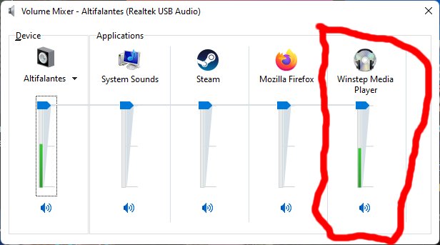

Also, open the Windows Volume Mixer and make sure that 'Winstep Media Player' shows up when you press the Play button and that it is not Muted or with the volume reduced to zero:

Wow, I'm so happy I finally heard the beautiful music. I reset it and checked it again.
I found that it does not support Chinese file names and folder names. I suspected that there was something wrong with the mp3 audio format I downloaded, so I downloaded another one and it actually played ^_^ successfully.
Thank you for your guidance, if it weren't for you I would have given up a long time ago, thank you. I have found a bug, that is, the media player icon will fail, sometimes you press it does not work, you can only restart the software, I hope you pay attention.
