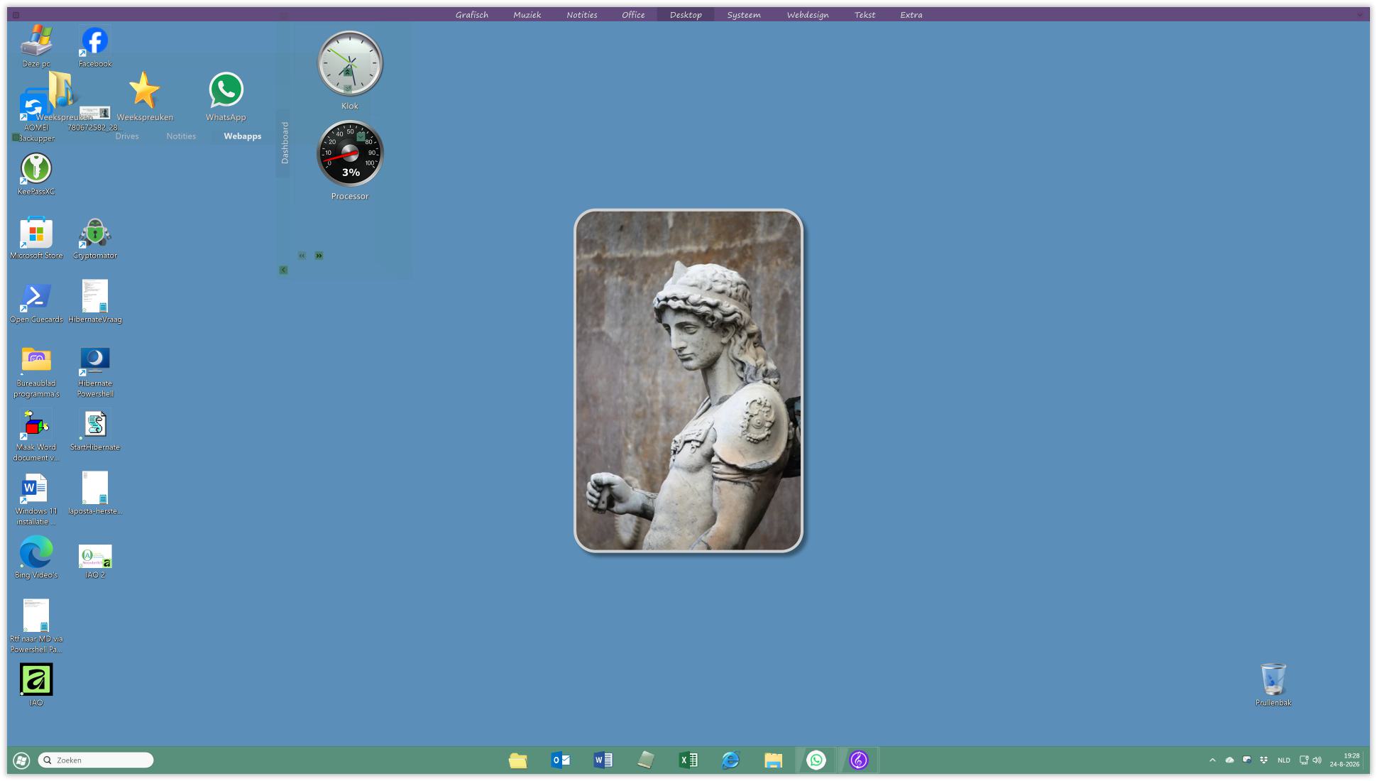

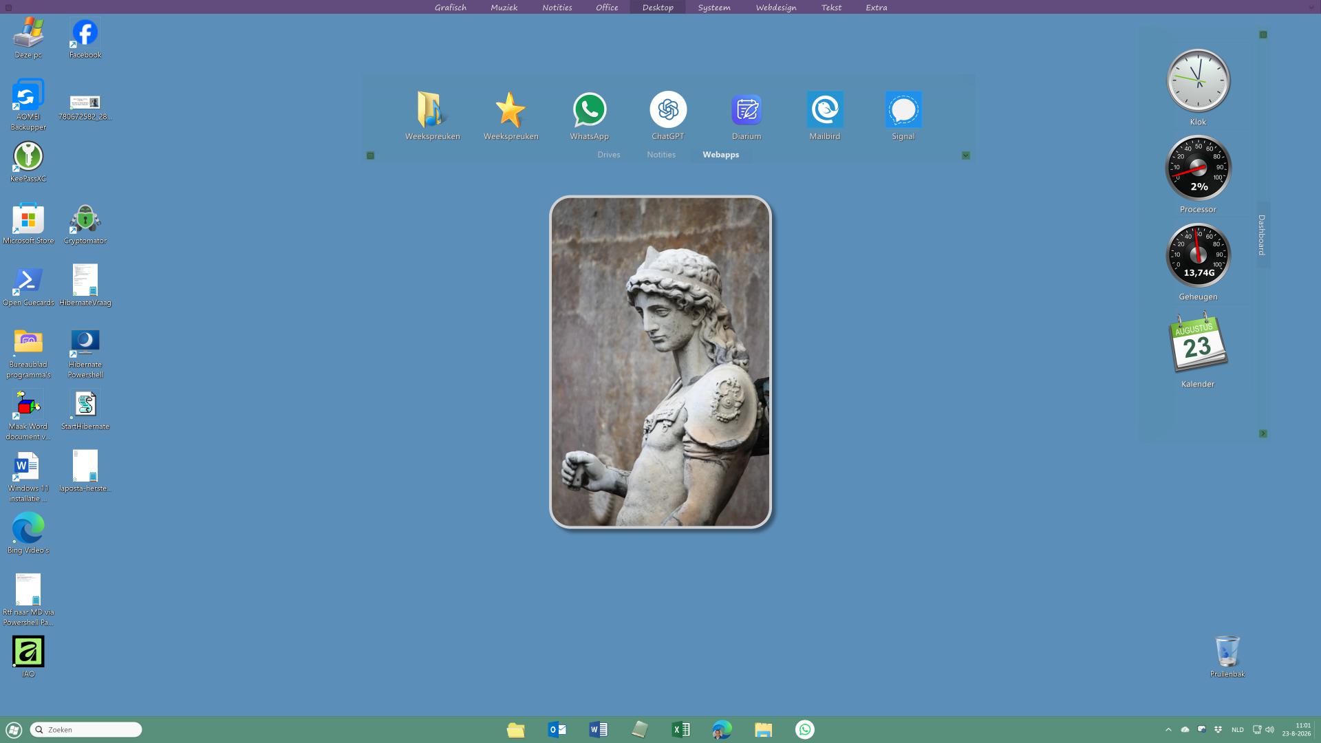

My desktop before and after 'reboot'
I cannot exactly say whenn this happens.
It happens not everytime.
Today i did a reboot, nothing changed.
I did a log off and log on: nothing changed.
I did hybernate nothing changed.
And suddenly after a longer hybernate? it was there again.
I don't know what i have changed that cause the issue.
 Post subject: Re: Shelf position does not stay on dekstop
PostPosted: Mon Aug 24, 2026 9:25 pm
What is most likely happening is the following:
1. WorkShelf starts while Windows is still initializing the display configuration.
2. During that process, Windows temporarily reports a much smaller desktop resolution - judging by the resulting Shelf positions and sizes, possibly something in the region of 1024x768 or 800x600.
3. WorkShelf receives that temporary display change.
4. Since the two floating Shelves are now partly or completely outside the available screen area, WorkShelf's normal bounds checking moves them back inside the visible desktop and reduces their size so they fit within the temporarily smaller screen.
5. Windows then switches back to the proper/native resolution.
6. For some reason, however, the monitor profile corresponding to the final display configuration is apparently not being restored afterward. If it were, the floating Shelves should at least move back to their original positions.
7. As a result, the temporary position and size adjustments made while Windows was using the smaller resolution remain in effect.
This matches your before-and-after screenshots very closely.
There are actually two separate issues here.
The first, and probably the main cause of what you are seeing, is that the correct monitor profile is apparently not being applied once Windows has finished restoring the normal display configuration. If it were, the Shelves should at least return to their previous positions.
The second issue is something I have just found and fixed for the next beta. Monitor profiles were saving the positions of floating Shelves, but not their width and height. This meant that even if the correct profile was restored, a Shelf that had temporarily been shrunk to fit a smaller screen could not recover its previous size.
That part is now fixed. I still need to determine why, in this particular startup/resume sequence, the final display change is apparently not causing the correct monitor profile to be restored.
The difficulty is that returning from hibernation or starting Windows is an extremely busy period for both the operating system and the application. Display, DPI, work-area and other notifications can fire in rapid succession while the graphics driver and desktop are still settling, which makes it very difficult to determine in real time exactly which sequence of events occurred. The fact that the problem appears to happen randomly strongly suggests either a timing/race condition or a notification that is occasionally being missed.
There is another potentially important factor in your particular setup: you previously showed Windows scaling set to 150%.
At 150% scaling, WorkShelf also has to deal with DPI changes in addition to resolution changes. During startup or resume Windows may briefly expose an intermediate display state before the monitor, graphics driver and per-monitor DPI information have fully settled. It is therefore possible that WorkShelf is temporarily seeing not only a different resolution, but also a different DPI/scaling value - for example 100%/96 DPI before Windows restores the normal 150%/144 DPI setting.
That would mean several different display geometries could be reported in very quick succession, making this kind of timing issue even more likely.
One thing I am not completely sure about is the scaling shown in your more recent screenshots. In an earlier screenshot in another thread the 150% scaling is very obvious, whereas some of the later screenshots look much closer to 100% scaling. This could simply be because the screenshots were resized before being posted, but I would like to rule out Windows itself changing the DPI/scaling state during startup or resume.
