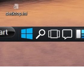

Hello,
I tried your solution, I receive well a message box with ""Reserved screen areas have been reset" but nothing change the toolbar is still hidden (in reality too low on the screen)
or too high when I come back on my computer
