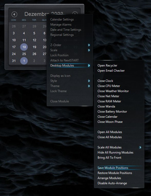

1. Place the modules on the secondary monitor and arrange them as you like them.
2. Right click one of the open modules -> Desktop Modules -> Save Module Positions.
3. Go to the C:\Users\Public\Documents\WinStep\Themes\ folder
4. Locate a file with the .pos extension, the name of the current theme you are using and the screen resolution of your PRIMARY monitor (for instance, if you are using the DarkTech theme at 4K the file will be called 'DarkTech-3840x2160.pos')
5. Right click the file, select Properties and make it Read-only in the Properties dialog.
This will prevent the position of the modules from being overwritten with their new positions when you switch to a single monitor and they are automatically re-arranged so they remain visible on the primary monitor. When you switch the second monitor on the file will still hold the proper module positions for a two monitor configuration and they should be properly re-arranged then.

MrSpock wrote:
Thanks for the answer but unfortunately this does not work. The pos file is not changed if you change a position and then close Winstep.
Did you skip step 2 above (you can *right* click on ANY open desktop module for this)?
That's what *manually* saves the current coordinates of ALL open modules into the .pos file. Positions are saved *automatically* only when the screen resolution changes OR the theme changes - this mechanism was primarily intended for the Winstep application to remember where the user positioned the desktop modules in each different theme.
Remember to clear the Read-Only attribute of the pos file before manually saving.

What happens if you then right click any of the desktop modules and select 'Desktop Modules -> Restore Modules Position' from the context menu?
