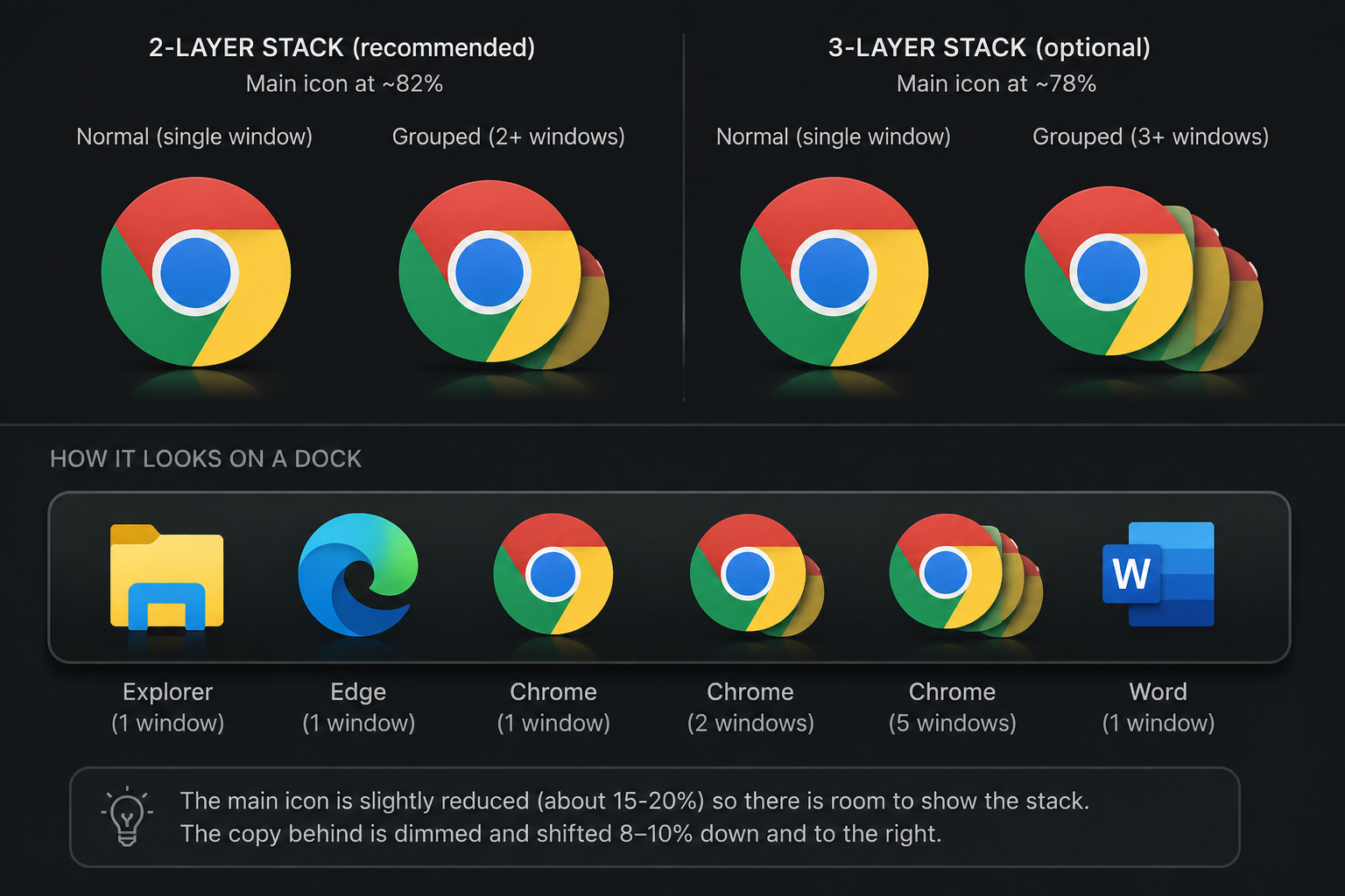

As for your intense dislike for the numeric badges, I was thinking in adding an optional alternative method for "stacked" windows, something a bit like what is described in the image below... would you prefer something like that?

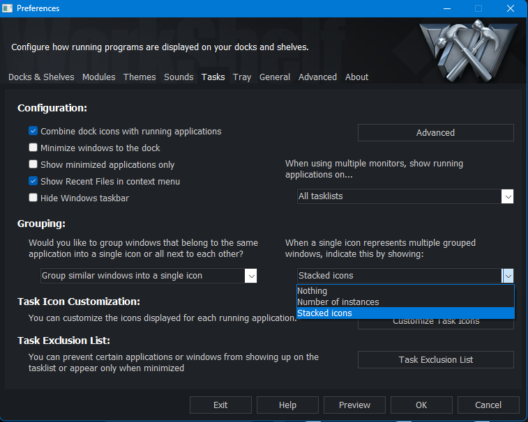

gillon wrote:
re suggestions with numbers. Could there be a toggle to turn it off/on
I did one better, as you might already realized from my post above. Added a grouped icon indicator setting, shared with NextSTART:
Stacked icons will show one rear copy when the icon represents two grouped windows,, and two rear copies when it represents more than two:
