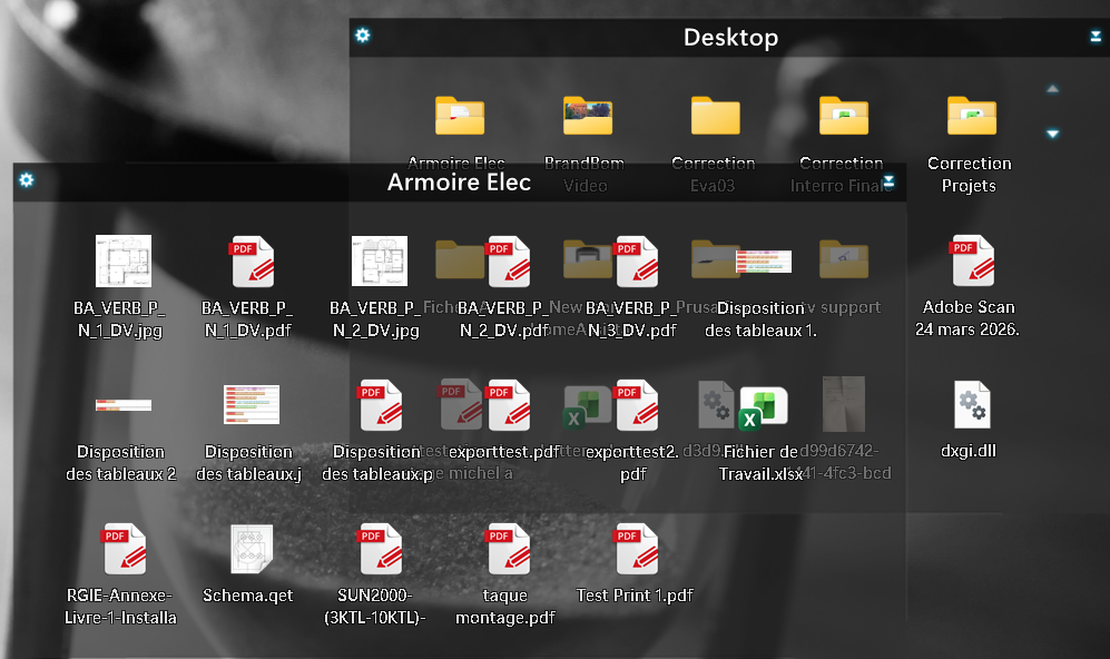

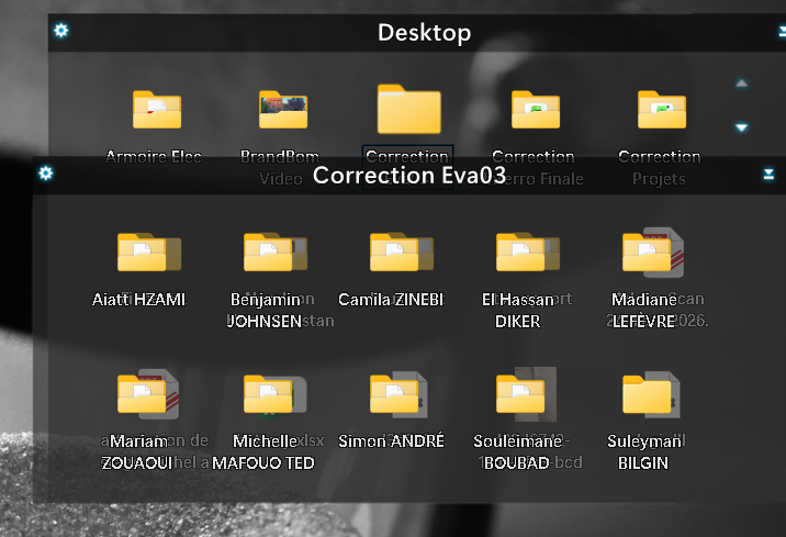

1)If you set the shelves to a transparent colour and use the "grid menu", folders/files tend to overlap each other, so that everything becomes an unreadable mess. See the pictures.
I have two possible solutions in mind (by order of preference):
-An option to force an opaque grid menu or separate the transparency possibility between the shelf and the related grid menu.
-An option to offset the grid menu opening outside of the shelf area.

Apologies, I meant to reply to this one in more detail and ended up forgetting all about it.
From Windows Vista up until Windows 10, it was possible to blur the background of irregularly shaped regions via an API call.
The Winstep software scanned the background bitmap of a dock or shelf for semi-transparent regions matching certain criteria, created a "map" of those regions in memory, and passed that map to the Windows DWM. From then on, the DWM automatically blurred only those regions against the window's background while the rest of the window remained normal.
This was perfect, because blurring the background solved precisely the type of readability issues you are describing here.
Windows 10 removed that capability, and Windows 11 never brought it back. The Windows backdrop system now only supports full-window blurring, not individual or irregular regions within a window.
Grid Stacks in docks or regular Shelf tabs are "permanent" and therefore have their own persistent individual settings, including transparency. They normally use the global Shelf theme, although each of these Grid Stacks can also be customized to use their own individual theme.
However, Grid Stacks created "on-the-fly" from folder shortcuts (i.e. folders set to open as Grid Stacks) do not have persistent settings because they are temporary and only exist while that Grid Stack is open. In that case, they inherit their settings from the parent Shelf, including the transparency level.
These two facts together create the problem you are describing.
A setting to open the Grid Stack outside the parent Shelf would not really solve it either, because the parent Shelf itself can be expanded to cover the entire screen.
The best solution would therefore be your first suggestion: adding a setting to make ALL temporary Grid Stacks fully opaque.

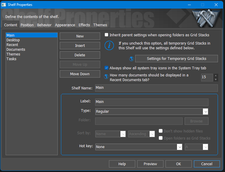

There is another potential solution, although I am not sure yet how feasible it would be, or even whether it would be worth implementing: creating a set of settings that applies to ALL temporary Grid Stacks - much like the current Grid Stack Properties panel, but without the Content tab and with the settings shared by every temporary Grid Stack.
Then, in the Tab Properties dialog, right next to "Open folders as Grid Stacks", there could be a choice between:
Inherit parent Shelf settings
or
Use shared Temporary Grid Stack settings
If the latter is selected, a button would provide access to the Temporary Grid Stack Properties dialog.

Yes. When that possibility occurred to me, I realized how much more useful it would be than a simple "make temporary Grid Stacks opaque" setting and, after making sure it was actually feasible, I immediately started working on it (and it's already working here).
Instead of fixing only the transparency issue, this gives temporary Grid Stacks access to essentially the same Appearance, Effects and Theme settings as regular Grid Stacks, but through a single shared profile used by all temporary Grid Stacks.
The choice is made on a per-Shelf basis, so each Shelf can either continue behaving exactly as it does now and have its temporary Grid Stacks inherit the parent Shelf settings, or use the shared Temporary Grid Stack settings instead.
This means, for example, that you could make temporary Grid Stacks fully opaque while keeping the parent Shelf transparent, but you could also give them a completely different theme, icon size, spacing, effects, etc. And because the profile is shared, you only have to configure it once rather than configuring every folder shortcut individually.
So it ends up solving your particular transparency problem while also providing a much more flexible and generally useful feature.
Initially I even considered making "Use shared Temporary Grid Stack settings" a per-tab setting rather than per-Shelf, but this would unnecessarily over-complicate things for no good reason.

So I've tested the new sub grid implementation and here are some feedbacks:
-It works globally. Nice ! Thx
-The option name "Use shared settings for temporaru Grid Stacks" seems a bit counter-intuitive. At first, I thought ticking the case would enable a global setting for temporary and normal grid stack. While it is the contrary. I would use something like "Use specific settings for temporary Grid Stacks" maybe.
-Ticking the option reset all the font settings I had for the normal Grid Stack. Just a bit annoying.
Yes, I see what you mean, a user can indeed read "shared" as meaning shared between normal and temporary Grid Stacks and that's almost the exact opposite of what the option does.
"Use dedicated settings for temporary Grid Stacks" is more explicit, but then users might assume each temporary grid stack has its own dedicated settings which is not what happens.
Perhaps "Use dedicated shared settings for temporary Grid Stacks"...
OR we invert the whole thing and use "Temporary folder Grid Stacks inherit parent settings" where the meaning of unchecking that option is at least clear... it does not, however, explain what unchecking that does.
What do you suggest?
See, I think this is exactly the issue and the source of some confusion, in part precisely because of how powerful and flexible the application is.
All "normal" Grid Stacks - the ones you explicitly add via Insert New Item -> Grid Stack - are persistent objects and therefore have their own individual settings and properties. These can be accessed by right-clicking the Grid Stack icon in the parent object and selecting Grid Stack Properties.
Normally they all use the same global theme, but each Grid Stack can also have its own individual theme, just as Shelves normally all use the global theme but can each be configured to use a different one through the Themes tab of that object's own Properties dialog
The global theme is the theme you apply from the Themes tab in Preferences. When you change the theme there, it is applied to all objects that are not configured to lock their own theme, including objects that were previously using a different individual theme. If you do not want the global theme to override the theme of a particular object, you enable Lock Theme for that object.
Temporary folder Grid Stacks, on the other hand, do not exist as persistent objects, so they cannot have individual settings of their own. Until now they simply inherited their settings from the parent object, which can be a Shelf, a Drawer or even another Grid Stack.
That is what caused the problem you originally reported: if the parent Shelf was semi-transparent, the temporary Grid Stack inherited that transparency too.
When you enable Use shared settings for temporary Grid Stacks, you are not giving each temporary Grid Stack its own settings. Instead, you are creating a single settings profile shared by all temporary Grid Stacks.
This gives you much more control over how temporary Grid Stacks look, but the consequence is that they will all use those same shared settings regardless of the settings of the parent object that opened them.
By default, that shared profile also uses the global theme - including that theme's fonts. If you want temporary Grid Stacks to use a different theme and therefore different font settings, you can select one from the Themes tab of the shared Temporary Grid Stack Properties panel.
Unless I am misunderstanding what you mean by "normal Grid Stack", the font settings you had customized there were actually the font settings of the parent Shelf, which the temporary Grid Stack was inheriting. Enabling the shared Temporary Grid Stack settings simply stops the temporary Grid Stack from inheriting those parent settings and makes it use the shared profile instead.

I will therefore probably change the code so that temporary Grid Stacks always inherit their scaling from the parent Shelf/Grid Stack, even when they otherwise use the shared Temporary Grid Stack profile.
And this is what I just did. The Grid Stack Scaling setting is no longer visible in the Appearance tab of the Shared Properties dialog for temporary Grid Stacks, and this property is now inherited from the parent object.
I also removed the "Customize Tray Icons" button to make room for some info text in the Contents tab (finding space in settings is always a PITA, but this button already exists in the Tray tab in Preferences so no biggie) and changed the setting to "Temporary folder Grid Stacks inherit parent settings".
I hope this, together with the info text and the new button caption, is enough for the setting to become self-explanatory.
