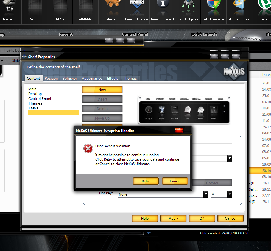

[irrelevant bug]
Open the shelf properties. Go to "content" tab. Select one of the shelf's tabs (for example, the last one). Click "delete". Now, click somewhere on the empty space in the tabs list. And now... click on the space, one line below the last item in the list. Bam. Sonic boom, again... [check "delete-bug.png" for visual info]
[irrelevant bug #2]
Right-click the shelf. Select "shelf properties" from the pop-up menu. Click it. You'll get tab properties instead.
