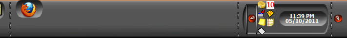

Here is the taskbar at its lowest.
Here I have changed nothing but the theme and it gets bigger.
So this happens because some element on the bar is to big for it to stay one line correct?
Just making sure I understand:)
 Post subject: Re: taskbar is to large
PostPosted: Wed May 11, 2011 11:35 am
Online
Yes, even if only by a single pixel. For instance, in the example screenshots you posted above: that systray button is showing both the date and the time, which makes it a double line button. Now, it might *look* like that systray button would fit into a single row taskbar, but, as I said above, a difference of a single pixel might be enough to trigger the automatic taskbar re-size.
You can test this: right click on the systray button and select 'Hide Date'. If I'm right and the systray button is the culprit, the taskbar will automatically shrink to single row.
You see, the Date feature in the systray button is quite recent, most themes were made when only the time could appear in the systray button.
