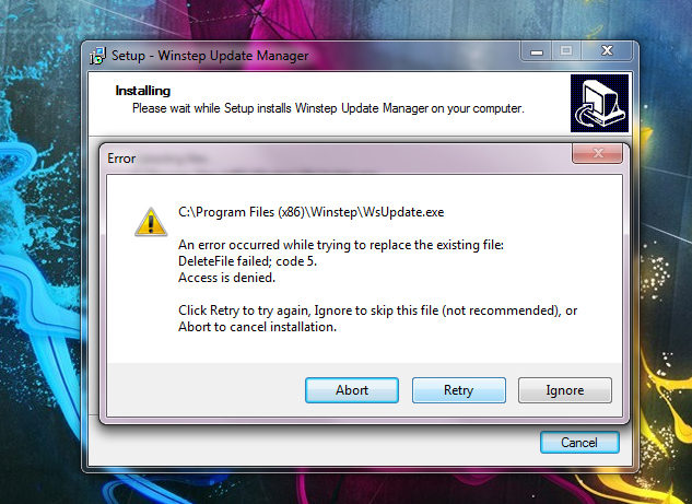

hi,
i'm using nexus ultimate version 11.05.0966. i'm facing an weird problem. whenever i try to install a new update (automatically downloaded by software itself), it fails and gives me an error message. i have to abort the procedure. i have attached the error message. please go through it. many many thanks. i need the solution very badly. waiting for your kind response.
regards
 Post subject: Re: can not update nexus ultimate! please help...
PostPosted: Sat Jul 09, 2011 6:26 pm
Posts: 202
For some reason the process of WsUpdate.exe was not closed. Maybe you didn't exit all winstep applications before installing the update?
When this error happens open the Task Manager and in the Processes tab check for any winstep related process (especially WsUpdate.exe as I think it's an Update Manager update that you're installing), if there is still any process running, close it and in the error dialog press Retry.

The Winstep Update Manager (WsUpdate.exe) should have exited automatically after launching the setup application. No idea why it hang around in your case.

If Wsupdate.exe is not running and you are still getting 'Access Denied', then the other likely reason is that, for some reason, the setup application is not running with Admin privileges, and thus cannot write to C:\Program Files. This shouldn't happen, because Win7 heuristics should automatically give you a UAC prompt for applications named 'setup'.
Exit the setup application, go to C:\Users\Public\Documents\WinStep\Versions\ and look for a file called 'setup.exe'. Right click on it and select 'Run as Administrator'.

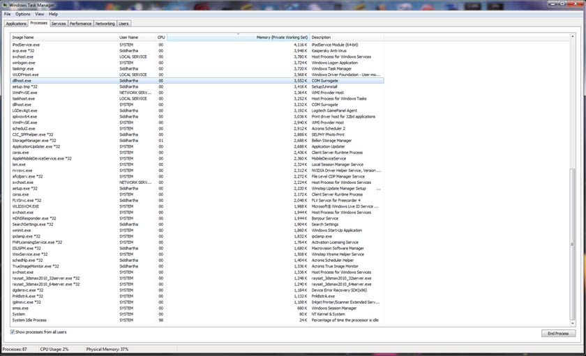

sidhu1990, sorry if this is a stupid question, but when you checked to see if WsUpdate.exe was running, did you do it from the Processes tab of the Windows Task Manager or from the Applications tab? You need to check for it in the Processes tab.

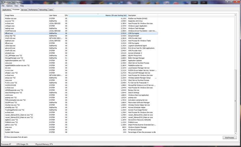

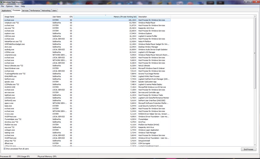

sorry, for late reply. i'm using windows 7 ultimate 64 bit. i followed your directions & disabled uac. i found winstep helper service, nexus ultimate. i stopped both of those processes even stopped one at a time but same result. i have attached screenshots of my processes window. please go through it, if i missed any thing. should i reinstall it. will my ws-key will work, if i download latest version from website? i'm within 1 yr licensing period. many many thanks. in that case i have to rearrange all the icons. that will be very tiresome.
