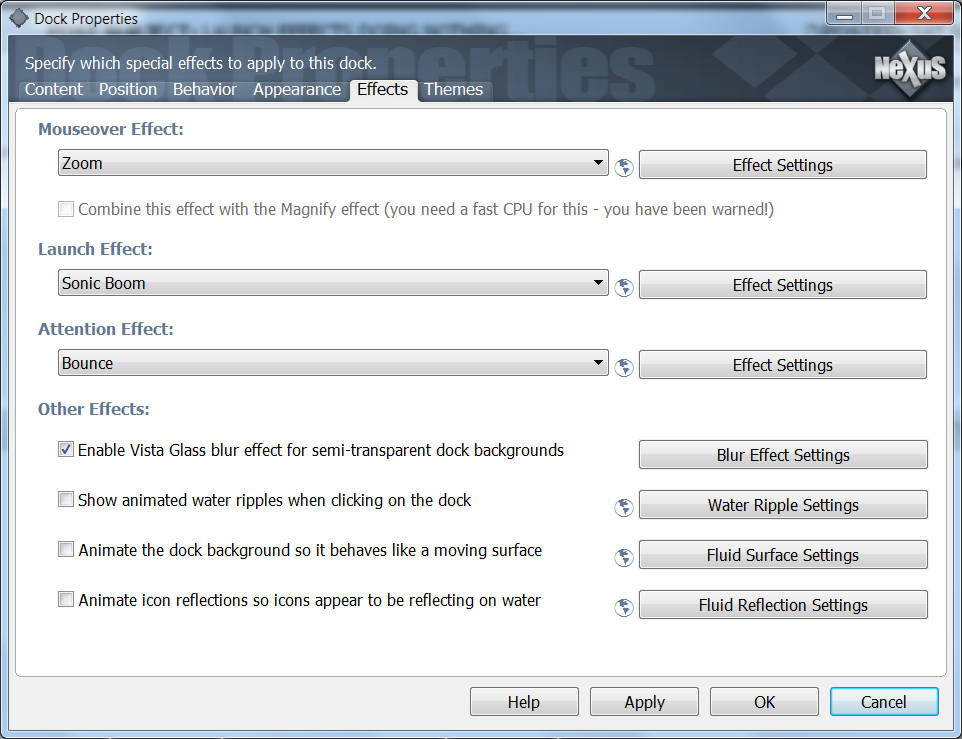

Hi, I just upgraded to 11.10 - super excited to try the new launch effects. But nothing seems to "take" - everytime I select something, it gives me nothing when I actually click on an icon...
I do remember having selected "No bounce effect" in 11.6 - I think it was called something like that. But I can't find that setting anymore. Do you think it is still turned on somewhere and is causing it to cancel any/all Launch effects?

Are we talking about Nexus free, Nexus Ultimate or Xtreme?
Can you please post a screenshot of the Effects tab in Preferences?

Nexus Ultimate
here's a shot attached.
Also, FYI, somewhat related. I tried to enable "water ripple" effect via the right click context menus (right click on dock), and it crashed my Nexus dock badly. I couldn't get it to start up at all after that (it would crash each time I tried to start it.) I had to uninstall, then reinstall the Nexus dock. Once I did - I tried out the Launch effects and they worked just fine. When I restored my backup (fortunately, made literally minutes before the mega-crash scenario), the launch effects no longer work.

Looking at that backup, I can see the Launch effect for your first dock (which has 10 items, first item being 'Common Folders') is set to AfterGlow. I don't see anything obvious that might cause the problem. Nobody else has complained about this either (so far), which makes it a tough one to crack.
Looking at your Preferences screenshot above, however, I did notice that your screen DPI is NOT set to 100%. It's a long shot, but have you tried setting your screen DPI to 100% and see what happens?
