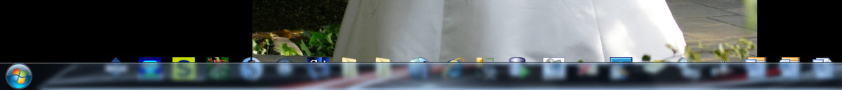

I'm having a problem with Nexus when my laptop is docked at work (Connected to a 22 inch monitor) then i undock it, it goes to the bottom of the screen under the task bar. I need to select bottom edge again to get it to the correct position. Thanks in advance.

The dock is set to respect reserved screen space, right? Also, what version are you running?
Try installing the beta of v12.2 from HERE, then please let me know if this solves your problem.
You have to be fast with that feedback, though, since v12.2 is about to be officially released.

The dock is set to respect reserved screen space. I installed the beta this morning and tested it out and my problem is fixed. Thanks.

Glad to know! :D
In the mean time I also fixed a couple of other positioning issues related to games/applications that temporarily change screen resolution.
