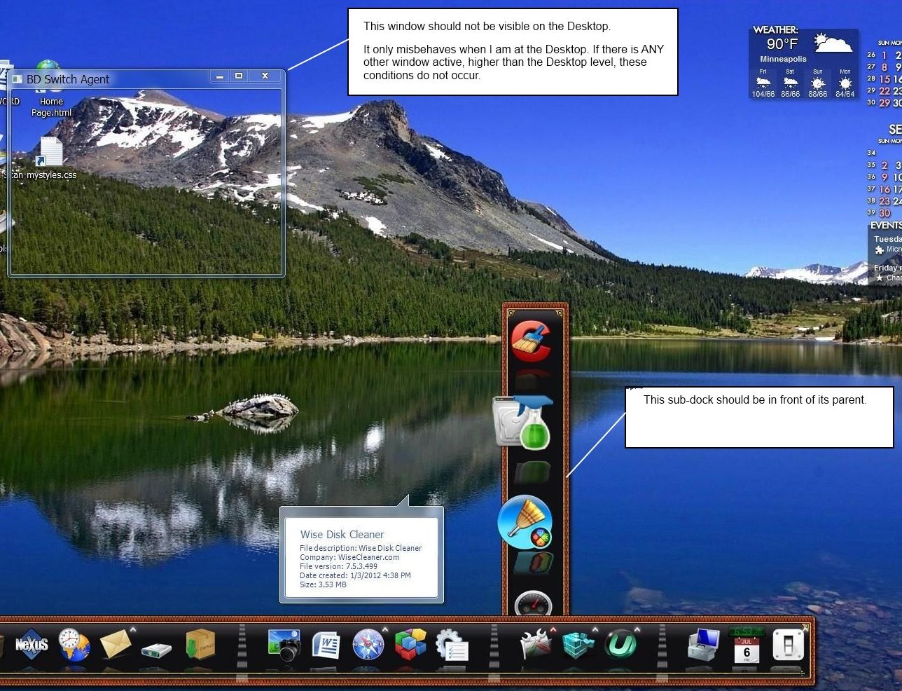

Dammit! I spoke too soon. Two of the three are back to misbehaving. Again, Nexus Ultimate has the problem of sub-docks hiding behind the dock (when at the desktop). BitDefender has the mystery window appearing on the desktop.
Thanks,
Grouch
Edit: added partial screen capture.

4. I clicked on the desktop then bumped the screen edge to make the dock visible, I hovered over an icon that had a sub-dock. The sub-dock appeared behind the parent dock. I moved the mouse away from the dock so it would collapse back to the screen edge.
5. I hit Alt-Tab and followed the same steps above, and the sub-dock appeared in front of the parent dock, as it should.
It SEEMS that there is an off-by-one error in the z-levels of "NeXuS vs. Desktop" that Alt-Tab corrects. It is not just the sub-dock that hides behind the parent. Any "Dock entry properties" dialog has to be dragged out from behind the dock in order to click the "OK" or "Cancel" buttons.
BitDefender was not the cause of the issue, it was just affected by it. It was probably putting its window lower than the Desktop to hide it, but the issue is placing it above the Desktop's z-level.
I think that if Nexus assured that it was at least 1-higher than the desktop, it might resolve the issue. {or} Maybe the Desktop is lower than it's supposed to be and other programs placing something just below the desktop are now visible.

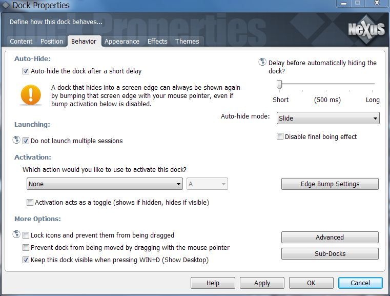

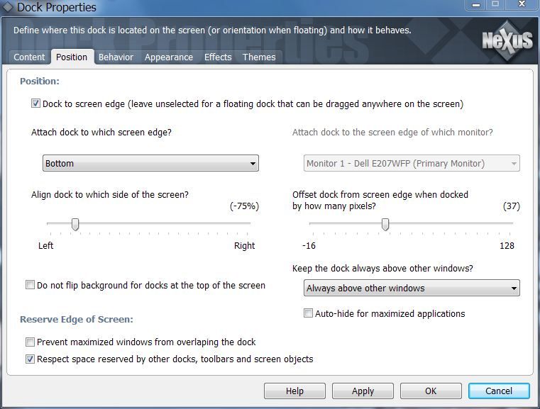

As to my settings, the Nexus dock is set to hide until an edge-bump slides it up from the bottom. At that time the icons with sub-docks are visible. Settings for the parent dock are as follows:

Ahh, I think I might see what the problem is. On the first screenshot you posted your setting is Always above other windows. Set it to Same as other windows. That's what mine is set to and see if that helps.
On the second screenshot for the setting: Which action would you like to use to activate this dock?, you have None. I'm not sure if I'm a little confused on what dock you have set to do what, but I have my parent dock set to Bump Bottom Screen Edge.
