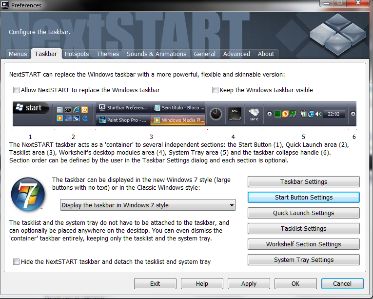

Just a thought. Enable WorkShelf and disable the Winstep taskbar via NextSTART. Let me know what happens. I'm curious to find out if the problem is connected with the taskbar and not WorkShelf.
Make sure you exit and restart Winstep Xtreme just to make sure the new settings are fully enabled.
