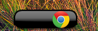

On starting nexus there is an invisible item on the dock (I think its the dock control icon as the dock disappears when I double click). I have disabled the icon in the settings but this only takes affect after I open settings and click apply.
I have tried not running nexus on windows startup and loading it myself but the problem still occurs.
Any ideas on how to fix this?
Edit:
I am only using to dock to show running applications, no other items. The problem only occurs if there are no applications running when nexus is started.

Can you please post a screenshot so I have a better idea of what is going on?
Either way, if it is what I am imagining, the dock will need to show *something* if you are using it only to show running applications and none are running at the moment, otherwise you wouldn't be able to access settings etc... But it should show a control icon rather than an invisible icon, and that would be the real bug.
From what you are saying the only way I can get round this is to make sure an application is running before starting nexus.
Usually i have the dock 100% transparent as all i want to show is the running app icons. This would be fine but the 'invisible icon' moves the rest of the icons off centre which isnt ideal.
