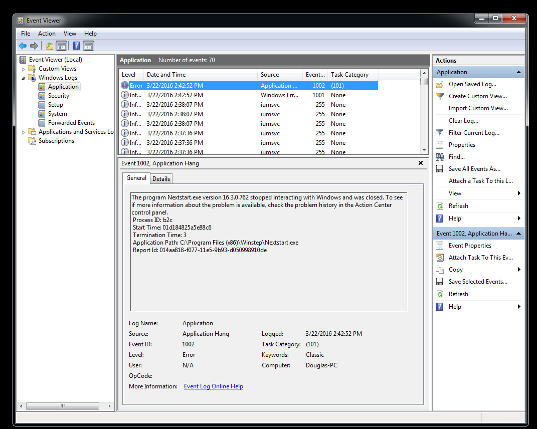

I'm running the latest Winstep Extreme on a win 7 PC. Everytime I plug in my USB thumb drive Nextstart freezes. I've tried several different thumb drives in all my different USB ports with the same issue. I'm including a screen shot from Event viewer. If I reset everything in Nextstart, the issue is gone.

Thanks for the picture, although it doesn't tell me much.
