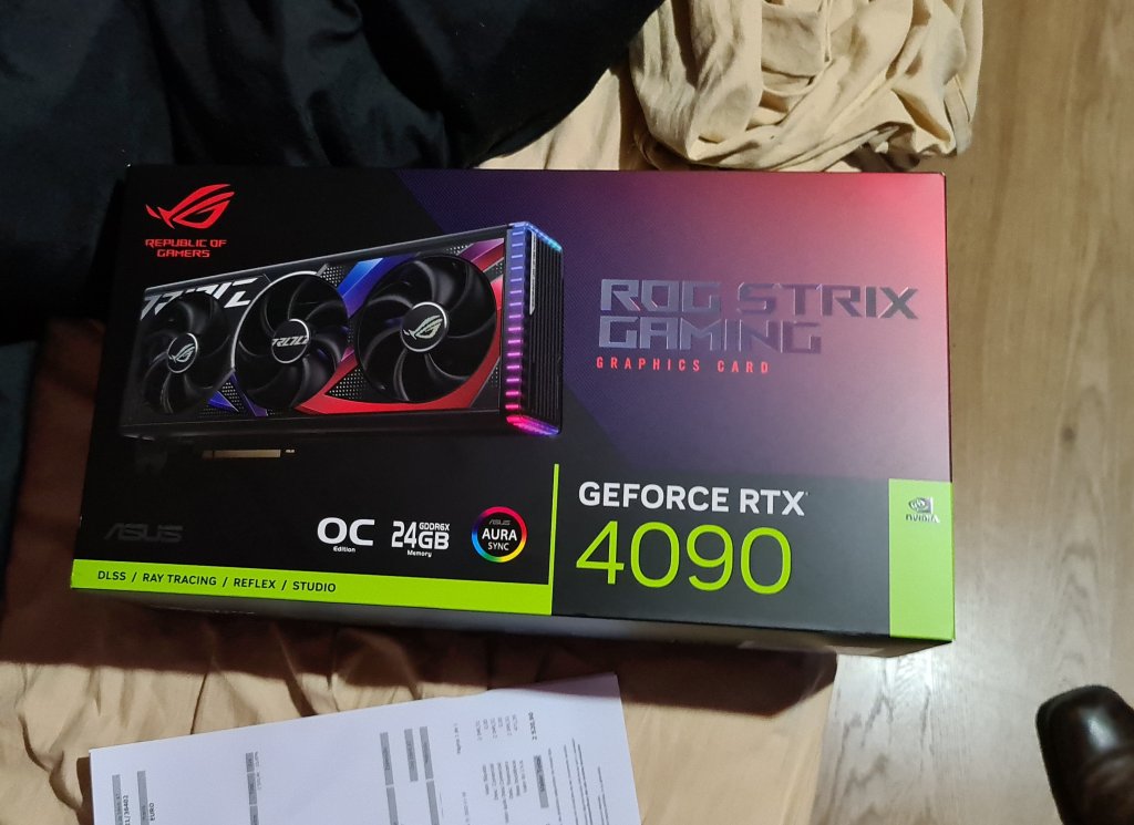

Replacing the Asus Strix 3090 OC with a Strix 4090 OC
When nVidia released the 4090 back in October 2022, I was lucky enough - thanks to my usual hardware supplier - to get my hands on an Asus ROG Strix 4090 OC barely a month later. Not even going to comment on what we are paying for flagship GPUs these days. :shock:
In anticipation I had already ordered from Cablemod a custom black & white 12VHPWR PCI-e Cable for ASUS and Seasonic PSUs (the 1200W ROG Thor is a Seasonic OEM) which got here before the GPU, but for various reasons it actually ended up being a while before I installed the 4090.
Initially I wanted to mount the 4090 vertically, like the 3090 before it, but I had some doubts on whether it would fit or not, despite the huge size of the Helios case (and the native vertical mounting mechanism). In fact, it did not, but not so much because of the size of the GPU.
Turns out the major problem was the position of the 12VHPWR connector at the top of the card, it ended up right under the Corsair DDR5 RAM sticks. There was absolutely no way the CableMod 12VHPWR connector would fit between the GPU and the RAM, not without seriously bending it, and with all the reports at the time of burning 4090 connectors, not something I would even consider doing.
Using the alternative vertical mounting mechanism of the Helios with such a tick card was no option either, as it would then be sitting flush to the Helios side panel, preventing it from receiving proper airflow.
And so I ended up mounting it horizontally:

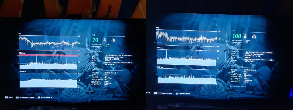

The new 4090 without any sort of overclock was roughly 55% + faster than my 3090. Not bad considering I game at 4K on a 120Hz OLED monitor (especially now with the new Unreal 5 games + ray tracing making a mockery of GPUs that are still considered top-of-the-line)

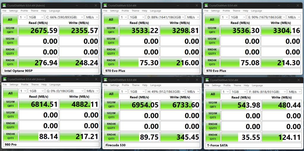

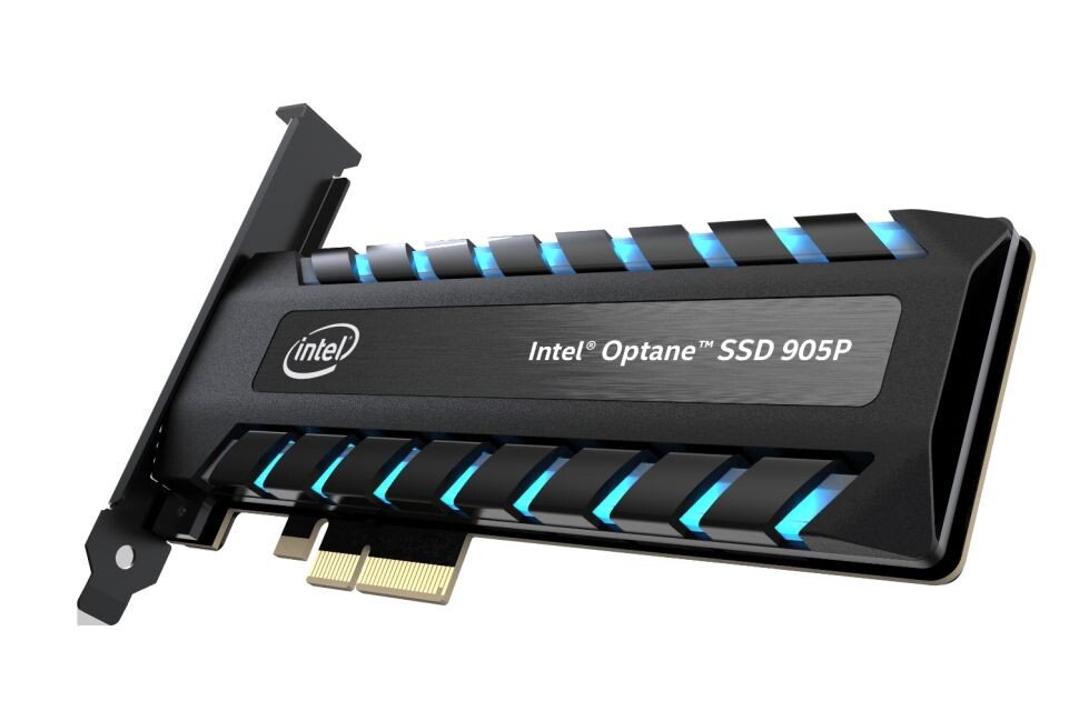

Besides this, I had the 960GB Intel 905P Optane PCIe drive sitting idle in my previous C700M system, and that is just a HUGE waste of an Optane drive. Despite being only Gen3, the Intel 905P is still unbeatable in terms of IOPS and 4K reads, not to mention write endurance.
For a quick comparison of the drives in my system, the 905P and the two 970 EVO Plus are Gen3, the Firecuda and the 980 Pro are Gen4 and the T-Force is a SATA SSD. Despite being Gen3, as you can see nothing yet gets close to the Optane in terms of 4k Q1T1 reads (which is what makes the system feel "snappy").
Sequential transfer rates look nice for marketing purposes, but most of the time the system will be doing random 4K transfers, not copying huge sequential files. Not only that, but that huge write transfer speed in ALL of the drives above will fall of a cliff once the SLC/DRAM cache becomes exhausted - except the Optane. The Optane will keep writing at 2500 MB/s until all hell freezes over.
I thus decided to make the Optane my new main system drive in the Helios.
Since the Optane is a PCIe drive and the Asus Z690 Maximus Extreme only has two PCIe x16 slots (both connected directly to the CPU) this meant that the 4090 GPU would have to share bandwidth with the Optane, going from full PCIe x16 4.0 to PCIe x8 4.0. Not a biggie at all since we are talking PCIe 4.0 speeds here, 8x is equivalent to full 16x speed on a PCIe 3.0 system.
I was also running out of space for games on my two 2TB 970 EVO drives. This way I could re-use the Firecuda as an extra 2TB drive dedicated to games.
So, I ordered a 1TB 980 Pro, cloned the Optane into it, removed the 905P once the process was finished and the 1TB 980 Pro became the new main system drive in the C700M system.

So at this point the system in terms of storage consisted of:
1. 960GB Intel Optane 905P PCIe NVMe
2. 2 TB Samsung Evo 970
3. 2 TB Samsung Evo 970 (#2), both NVMe EVO drives installed on the DIMM.2
4. 2 TB Firecuda 530
5. 1 TB T-Force SATA SSD
6. 4 TB Western Digital hard disk to store old backups, etc.
So basically 8 TB of sweet, sweet, flash storage.

So at this point the system in terms of storage consists of:
1. 960GB Intel Optane 905P PCIe NVMe (system drive)
4. 2 TB Samsung 980 PRO
5. 2 TB Firecuda 530 (empty)
6. 1 TB T-Force SATA SSD (empty)
7. 2 TB Samsung T7 Touch external USB drive
8. 4 TB Western Digital hard disk to store old backups, etc.
Now up to basically 12 TB of sweet, sweet, flash storage.

Vertical GPU:
So, I tried. I swear I did, but things at the time ended up not going as expected and I didn't even remember to take photos to show what happened.
To start with, the 905p Optane, being a PCIe drive, meant that I would need two riser cables to pull this off (one shorter than the other). So I ordered a second Linkup PCIe 4.0 compatible riser cable (and those things are expensive!).
The Helios case offers two potential ways you can mount a vertical GPU, one closer to the motherboard, the second closer to the glass panel. The position closer to the motherboard has the drawback of power and motherboard cables interfering with the GPU card and/or a CPU cooler/RAM sticks but is the best for airflow, the position closest to the glass does not suffer from this problem but puts the card so close to the glass that airflow and therefore temperatures suffer (and in some cases I heard that the tempered glass gets really, really, hot).
The idea was to put the 4090 in the position closest to the motherboard and use the vertical GPU mount next to the glass panel to put the Optane in front of it (which is a much, much, smaller card than the gigantic 4090, therefore it would barely interfere with proper airflow to the GPU).
A long time has passed since I tried this so my memory is a bit fuzzy, but I remember I had to struggle to mount the 4090 close to the motherboard, especially because the 12VHPWR cablemod power cable would once again interfere with the memory sticks (although this wasn't so bad as with the Corsair DDR5, given that the TridentZ modules have a much lower profile). I had to get a 90 degree adapter to solve this. The sheer height of the 4090 Strix card would also partially obscure the little OLED information panel on the motherboard.
Whichever way, I remember I managed to get everything mounted correctly, or at least enough to try and power on the system. Pity I forgot to take photos.
And that is when I faced defeat: for whatever reason, the Optane drive didn't even power up, no lights, no nothing, despite being properly connected with the riser cable to the second x16 PCIe slot on the motherboard (ah, but was it really?).
At this point I was already so tired and anxious that something had happened to the Optane that I just gave up on the whole idea, removed the riser cables and mounted everything in the classic horizontal way. Which is how it is to this day.
