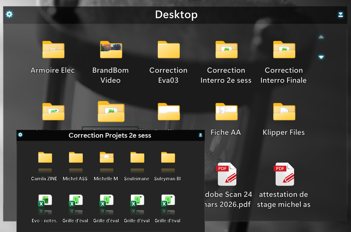

And in the end settled for this:
This was the version that I prefered ;) More natural.

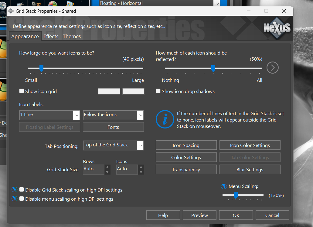

Please try to use the exact Winstep terminology when describing these issues, especially when distinguishing between Shelves and Grid Stacks. Above I assume that when you say the ‘Shelf’ becomes giant you actually mean the temporary Grid Stack, since the setting you changed is ‘Grid Stack Scaling’. If that assumption is wrong, then I would be investigating a completely different problem.
Sorry for the wording. I was talking about these options but I think you figured it out in the end. So far, "grid stack scaling"should not be shared indeed due to difference in dpi in multi monitors setup.

Can you please make a backup of your settings (Preferences -> Backup) and send it over to the Winstep support address... see if I can reproduce it here.
Done: mail title = "Backup for "Muti-monitors profile" topic"
