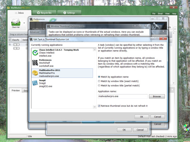

Add it to the Thumbnail exclusion list (WorkShelf Preferences -> Tasks -> Advanced -> Thumbnail Exclusion List button).
If this solves the problem, please let me know the name of MailWasher's executable so I can add it to the default exclusion list.

Thanks Jorge for the suggestion, but sadly it didn't fix the problem. I added the program .exe file to the exceptions list as you suggested, but still had the same issue.
To show you exactly what happens when I try to maximise Mailwasher, I created a small screen capture for you.

I forgot to mention that I set the thumbnail exclusion to match by application name, which was the same for other programs in the list. I hope that's correct?
I also tried enabling as well as disabling the 'retrieve thumbnail but do not refresh it' option, but the same problem occurred both ways.

Try also adding 'MailWasherProApp.exe' to the exclusion list, although, after watching the video, I'm not even sure if that is related to thumbnails at all.
