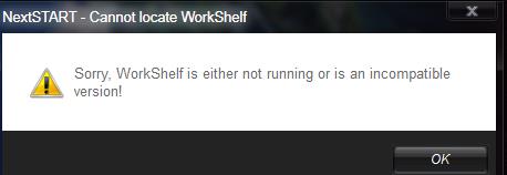

I'm using version 16.06.1161. I'm having a similar issue. I have to click one of the tabs on the Shelf before mouseover will work.
After mousing over Desktop, Control Panel, Main Recent, Documents I get an error message before I can finish mousing over the rest of the tabs. It's reproducible every time.
The error message I get is WorkShelf Exception Handler. If I click on Retry, nothing happens. If I click Cancel, Winstep closes.

 Post subject: Re: Activating a tab in a shelf
PostPosted: Tue Apr 25, 2017 4:01 pm
Posts: 13592
Exactly which tab is causing this error? Does it happen if you go directly to it without mousing over the other tabs? What happens if instead of mousing over from left to right you mouse over from right to left?
PostPosted: Tue Apr 25, 2017 5:35 pm
I exited and restarted to see what would happen. And it still does it. It happens after I mouseover Documents from left to right.
This time I got the error message that Windows would try and find the problem. And then I got another Winstep error message, it closed, and all of my Desktop items are no longer visible.
I'll have to restart Winstep via Start Menu to get them to show again.
I restarted Winstep then I tried it a few times and it didn't do it from right to left or when I mouseover Documents. Isn't mouseover supposed to activate the tab without clicking on it? Or is my settings the reason it doesn't active on mouseover without clicking on a tab?
Here is the Winstep error message I got.
