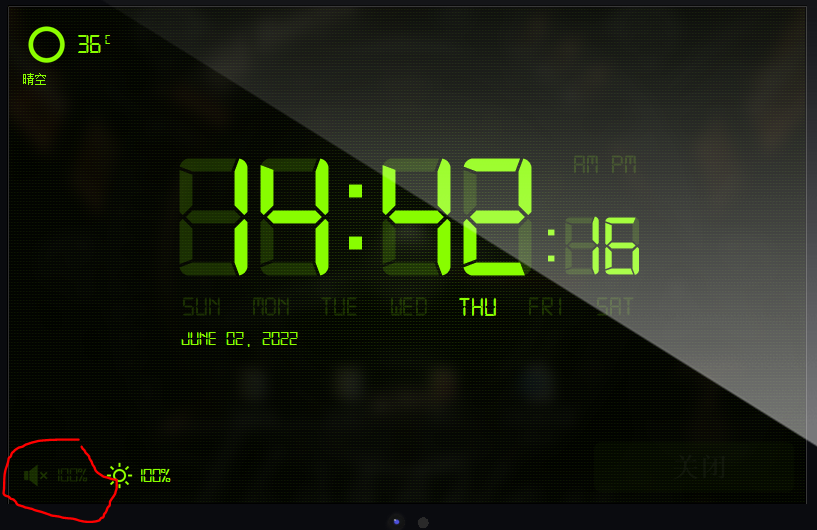

First of all, thank you for your reply. I am indeed in China and use Chinese version of Windows.
I did it your way, but it still didn't solve the problem, that is, the alarm still didn't sound, and I found that everything about the audio didn't play.
As shown in the figure:

Dud you check windows volume mixer, maybe its muted there?
im not on my pc atm so i cant check what allarm shows if its muted in Windows

yes, it looks exacrly like that

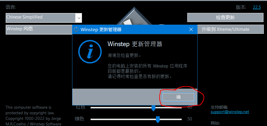

I installed the Nexus v22.5 beta and the text cropping issue was finally solved. I checked and found that most of them were resolved, only the prompt box text that popped up when I clicked on the "Check for Updates" button was cropped.

First of all, thanks for confirming that the cropping text issue has indeed been solved (and for pointing out that I had forgotten to fix it in the Winstep Update Manager as well).

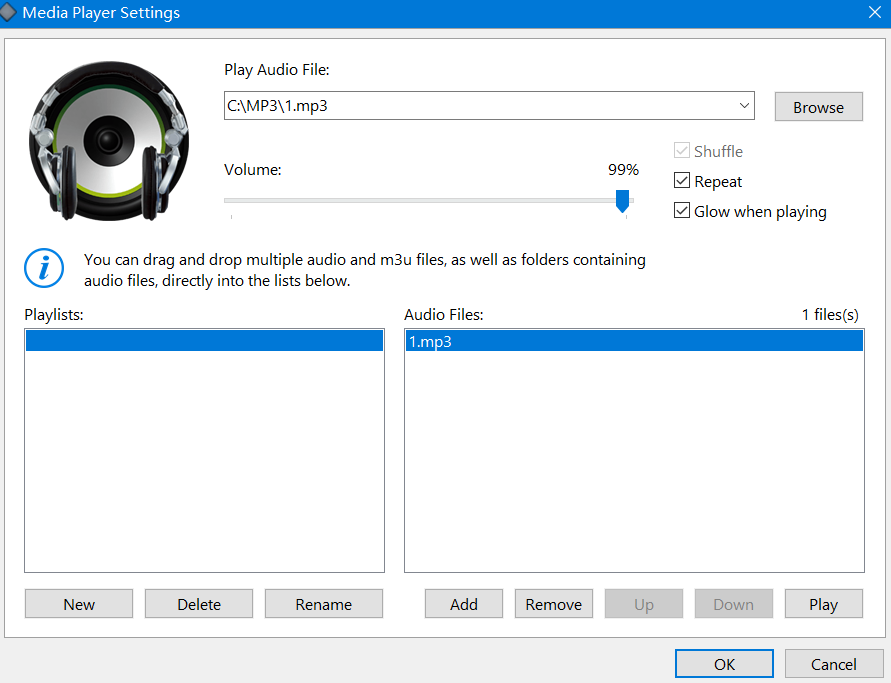

Add the Winstep Media Player to the dock by right clicking on the dock -> Insert New Dock Item -> Internal Command -> Media -> Media Player
Now right click on the Winstep Media Player icon and select Media Player Settings. Drag MP3 files to the panel at the right, play with the Media Player a bit. Can you get ANY of the MP3 files to play?

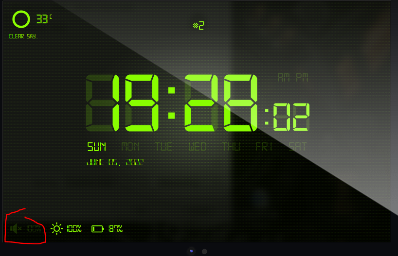

Thank you for the gift you gave me, I loved it and it was successfully installed and registered. However, after installation, there was a problem of Chinese characters being cropped, but it did not affect.
As for the mp3 audio, I was completely desperate, I tried it over and over again, but it didn't work out, it still wouldn't play, pressing the button didn't work in the slightest. And the volume icon for the alarm clock has been gray.
Just like in the pictures.

In the Winstep Media Player, replace the C:\MP3\1.mp3 file with
C:\Users\Public\Documents\WinStep\Themes\Female Voice\NewMail.mp3
Can you hear that one when you press Play?
Also, open the Windows Volume Mixer and make sure that 'Winstep Media Player' shows up when you press the Play button and that it is not Muted or with the volume reduced to zero:

Wow, I'm so happy I finally heard the beautiful music. I reset it and checked it again.
I found that it does not support Chinese file names and folder names. I suspected that there was something wrong with the mp3 audio format I downloaded, so I downloaded another one and it actually played ^_^ successfully.
