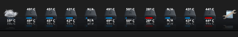

Guys, regarding allowing info both on top AND bottom of the disk meter icon:
The pros of this is that you would:
a) More lengthy info like Capacity or Bytes Read/s could become more readable by, for instance, displaying Bytes Read/s at the top of the icon and Bytes Written/s at the bottom, instead of "Bytes read/Bytes Written" at the bottom.
b) You could actually display four different types of info at once, two at the top, two at the bottom.
c) It is a user choice. The user may still choose not to display anything at the top of the icon (which is the default) OR he may choose not to display anything at the bottom and instead at the top.
Cons:
a) If the user chooses to display info on the top of the icon, legibility of the icon itself suffers a bit, of course.
This said, the default disk meter images were designed in such a way that they are shifted up instead of being centered in the icon, that is, there is a bit of empty space at the bottom of the icon to fit the text.
if the user decides to display info at the top of the icon, I automatically shift the image down a bit so that the empty space at the bottom is divided evenly between empty space at the top and the bottom. The text at the top and bottom is still going to overlap a bit of the meter image, of course, but shifting the image helps minimize how much of it is actually overlapped.
Likewise, if the user chooses to only display info at the top and none at the bottom, I can shift the icon all the way down in such a way that all the empty space is now at the top. Something else I do if there is text at the top for the Drive style icon is to move the drive letter etched onto the drive case a bit down so it does not get overlapped by the top info.
Anyway, describing something is one thing, actually seeing it is another, so I temporarily changed the code to see what allowing info at the top as well as the bottom would look like. Have a look and please give me your opinion ASAP. Again, remember this would be user choice, if he wants to make the icon unreadable, it is up to him (but I still don't think that is the case, I think it is actually not that bad, which is why I am fishing for opinions here).

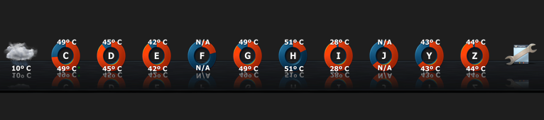

Just had a bit of time playing with the ‘ring’ representation.
Comments (and questions) as they come:
1) When you first open the v25.12 beta zip file, the Readme.txt file specifies it as 25.11 update
2) When module first opened and select customize under the ring display the following behaviours are observed:
    a) Select 'New Preset' in Presets: drop down - nothing happens and the selections reverts to Default.
  1. If I select one of the ‘Colorize’ options (which I’m not sure what they are meant to represent – maybe some popup / help might be useful here) then a set of Presets(?) are applied and the Presets: selection is set to ‘New Preset’. If I then choose 'Default' the values revert, but on selecting ‘New Preset’ it goes back to the last set of ‘Presets’ that were in operation with the Colorize option selected.
  2. Unticking the Colorize selections reverts back to the Default preset option, but if New Preset is then selected it reverts back to the previous selection with one of the Colorize options selected.
  3. If I cancel out of the whole dialog then start again then this doesn’t happen until Colorize is selected again.
  4. I do note that if I select the Colorize option the Hue and Saturation slider metrics are changed from -180 to 180 (and -100 to 100) to 0 to 360 (and 0 to 100), whereas the Lightness slider remains the same. I assume that this relates to my current lack of understanding of what colorize means, and hence why one changes to the full range (360) while the other only changes to 100.
    b) Using the sliders enable the colours and brightness to be adjusted, with values being shown in the associated boxes (where they can also be adjusted). 
    c) Modifying a slider / value immediately changes displayed option in Presets: to New Preset
    d) If I change a couple of values then return them to zero the Presets: reverts to Default - but if I then select New Preset the last value that was returned to zero reverts back to its previous value (probably related to actions observed in a) above). Is this supposed to happen?
    Note - I can also delete the values within the boxes (leaving everything blank) although sliders don’t change. If I save as a preset the values return. Not wrong, just strange.
    e) If I then save the Preset to 'My Save 1' say, it gets added to the drop-down list and I can select any of the options. 
    f) However, if I make a change and then save again with the same name, I get a dialog box stating that 'A preset with this name already exists. Do you want to overwrite it?'. If I select Yes, the item is repeated in the drop-down list, not overwritten.
    g) I also note that the Presets are just presented in the order saved, not alphabetically which I suspect would make it easier to find if you have a few. Although I appreciate that you would need to retain the ‘system presets’ at the top.
    1. I did try saving as the system presets and was stopped from doing so. 
    h) I did try adding numerous Presets and the drop-down did eventually turn to a scroll list 
    i) Am unable to type in Preset: box to select a preset – only option is drop-down selection.
    j) Placing same values into boxes as a previously saved preset did then present that preset in the Presets: drop-down box. 
    k) Am unable to edit a previously saved preset. Only option presented is delete. I can start to change the values but then the Presets: option reverts to ‘New Preset’ so I have to remember the name of the preset I was working with and then enter it / save again – which then gives duplicate as mentioned above.
3) Selecting ‘Save as PNG’ allows me to select a location / name for the graphic to be stored. However, if make change and then choose same location / name I get dialog boxes to state that it already exists and do I want to replace it, then on selecting Yes another dialog box (this time from Workshelf) saying it already exists. Overwrite? – on selecting Yes again the dialog box shuts, but on checking graphic it hasn’t changed. Two issues – one we shouldn’t have 2x dialogs for same thing, and two the graphic needs to be replaced.
4) If I choose to display certain metrics the text size varies when displayed on the desktop widget. The smaller size is better as it sits below the Icon (e.g. Free Space and total capacity). Whereas if I choose say Temperature and %age used the text is larger and overlaps the icon. Is it not possible to just keep the smaller text for all options?
  1. Same happens if only choose one item to display (e.g. set other to None). Personally, I would prefer the smaller text always.
  2. If I choose to make Primary and Secondary metric the same then only one value is presented. 
  3. Question – would it be possible to get the text to display in the same colour as the selected metric i.e. to act as a visual key?
  4. At the moment if I choose say Free Space and Percent Used then I get the two values but as Nexter mentioned previously the user could be confused as to whether the %age value refers to the capacity shown.
5) Drive activity and disabling smart queries appears to work correctly, although it would be useful to be able to modify the brightness of the activity display (and possibly the size in the case of the ring / circle representation) – as it is not necessarily obvious.
OBSERVATION - making detailed responses in this bulletin board is a pain, as I keep having to restructure the response and its not particularly easy to highlight different aspects.
Ideally there should be another mechanism for providing test feedback if its not just a simple result!
If I get time I may look at the other drive representation later.

Nezbit wrote:
I would like to see an option to change the font for the data below the drive. I am using it on a 24" HD monitor and I have to make it larger than I would like to easily read the data. I also think showing data on the top and bottom would look too cluttered.
Changing the font would not help, that is already as readable as it can be. As for data on top and bottom, it does look cluttered, but it is really up to the user. By default data is only shown at the bottom of the icon.
Nezbit wrote:
Two of my four drives could not show the Lifetime Remaining, but that is an option I would not use anyway. They were a Western Digital mechanical drive and a Crucial SSD.
Thanks! Mechanical drives (HDDs) do not have "Lifetime Remaining", that is only for SSDs. As for the Crucial, some drives either do not expose some data (I have a T-Force SATA SSD that does not report temperature, they did it deliberately) or they do it in a proprietary way that the disk meter module cannot read (supporting proprietary protocols is completely beyond the scope of this module).
Nezbit wrote:
For the Disk Meter Desktop Module I like the iFlip Calendar slightly better than the iStat. It would depend on what theme I was using though. Having both to choose from would be nice. A light and dark version would also be nice. My eyes are too old to look at small text, so the more readable the better.
Actually it's going to be neither... well, more like the iFlip. Still working on it, but here is what it will look like with room for 3 drives:
You really dig into the details, I like that. :D I noticed afterwards, but since it was not a big deal and I had already uploaded the file I did not bother to fix it.
Ok, I understand it can be a bit confusing at first, but here is how it works:
"New Preset" is anything combination of color settings (Hue, Sat, Lum, Colorize) that is not part of existing Presets. So, whenever you make a change to the existing preset combinations, the combo box changes to "New Preset".

If I right click on a drive module in a dock / shelf and choose Entry Properties->Change Icon then the drop-down presented only provides the option for 'Drive' even if the module being displayed currently is a ring!
That was kind of deliberate because the ring chart is a "composite" bitmap ("free space" background bitmap overlapped by a "used space" bitmap), and you can only specify a single bitmap on that dialog (the bitmap showing the free space). Having second thoughts on that though, as it might still be useful for colors/shades difficult if not impossible to achieve even with all the colorization options (or slightly changing the shape of the ring). Whatever the user chooses, it must "match" with the "used space" ring though.
