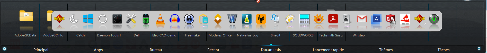

In my setup, the tablet and a bar are overlapping the top edge of the screen. How can I drag a shortcut into the bar? Currently, the tablet doesn't allow it.

I think he has a shelf docked to the same edge as a dock (in which case the answer is he shouldn't, but can pull it off using the dock's "offset from edge" setting), but I want to make sure it's that.

Vous comprendrez aisément tous les deux que je ne peux pas glisser une icône (raccourci) dans la barre des tâches (dock) lorsque la tablette et la barre se superposent.
Vous trouverez une copie d'écran de cette situation.

Admittedly though, the mind now has to boggle over that screenshot. Holy smoke, what a mess! Unbelievable amount of icons. :|

What you are trying to do is basically the same as making two bodies occupy the same physical space - in Sci-fi movies that only results in a huge explosion and both bodies being completely annihilated. :D
With a shelf and a dock what happens is that one ends up obscuring the other. There are only two solutions for this: you either dock one of them to a different edge (for instance, here I have a shelf at the bottom of the screen sitting right above the taskbar, and the dock at the top) OR in the Dock Properties tab you offset the dock from the screen edge in such a way that it does not cover a fully expanded shelf.
But the bottom line is that you should not have a dock and a shelf docked to the same screen edge.
