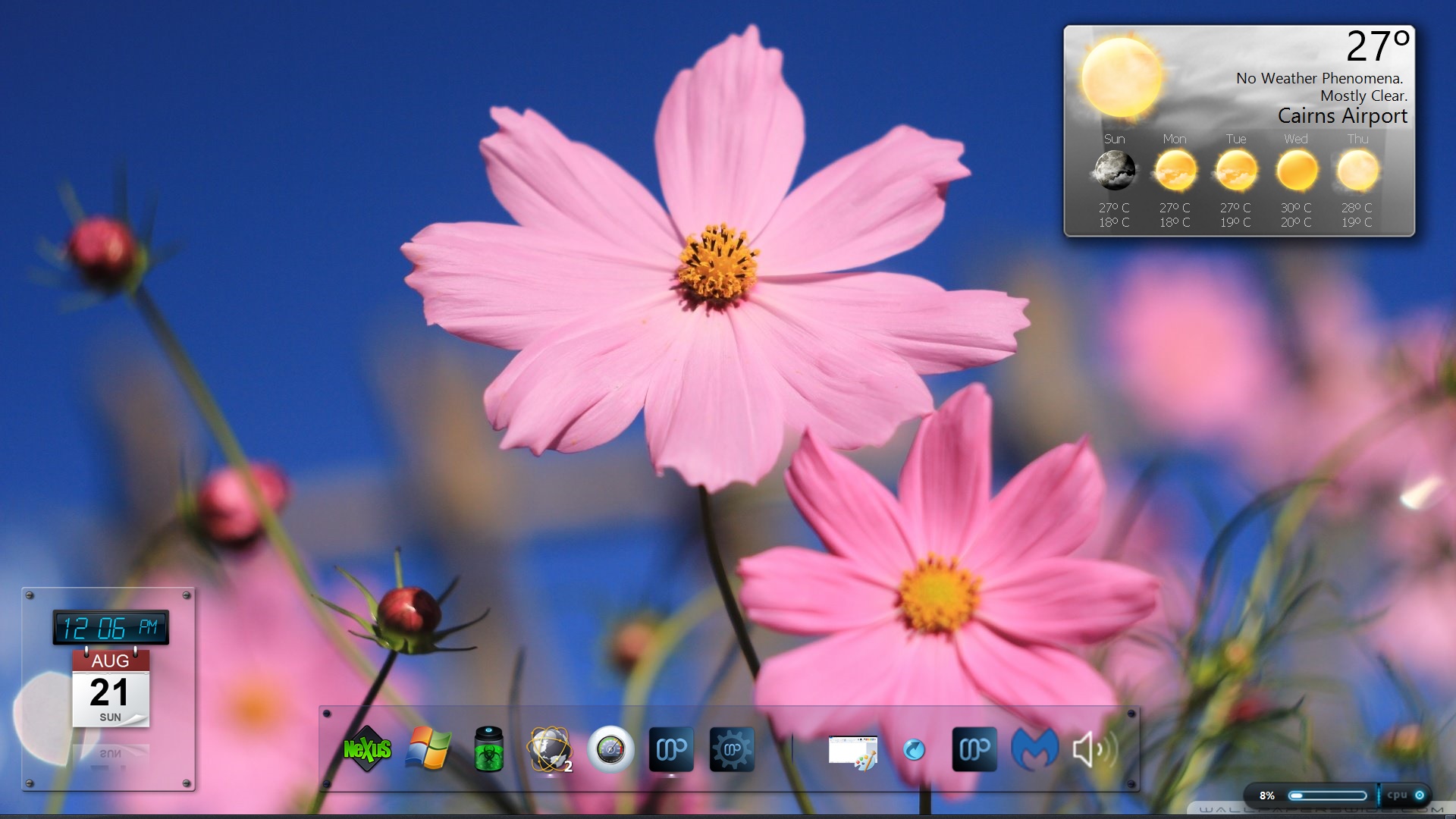

Just installed Winstep Extreme on my Windows 10 media centre, and am blown away with the quality :D . It looks amazing on my 70" panel! I looked high and low through google and came across some info here on the forum that suggests there is not a digital clock module for the desktop, unless the author of the skin specifically wrote one. Seems like a bit of a shortcoming given all the other amazing features. A short workaround I've found is to simply create a new dock and remove all items except a digital clock icon, then increase the size suite your desktop.
I possibly have missed something still?? and there is an easier way to get a digital clock on the desktop?

Thanks for the thumbs up, and for the screenshot.
