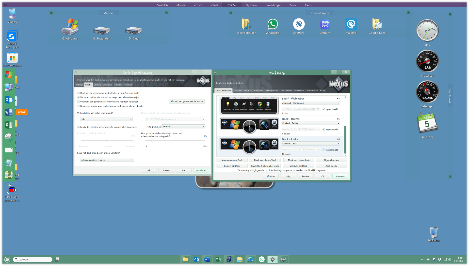

I send a screenshot of my desktop.

No it did not.
You can also post a screenshot here: when replying to this message, in the Upload Attachment section click the "Browse" button to the screenshot file but then you also need to click on the "Add the File" button.

What theme are you using for that dock? Are you by any chance using a *dock tile* theme for the dock?!
The new “span the full screen width when docked” option only works with themes that use a single continuous dock background.
Tile-based themes place a separate fixed-size square behind each icon. Those tiles are repeated according to the number of icons in the dock, so there is no single background image that can be stretched to fill the remaining width of the screen.
To use the full-width option, you will therefore need to select a theme with a continuous background bitmap that can be resized horizontally or vertically.

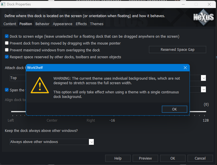

I've now added a warning if that option is selected while using a tiled theme.
