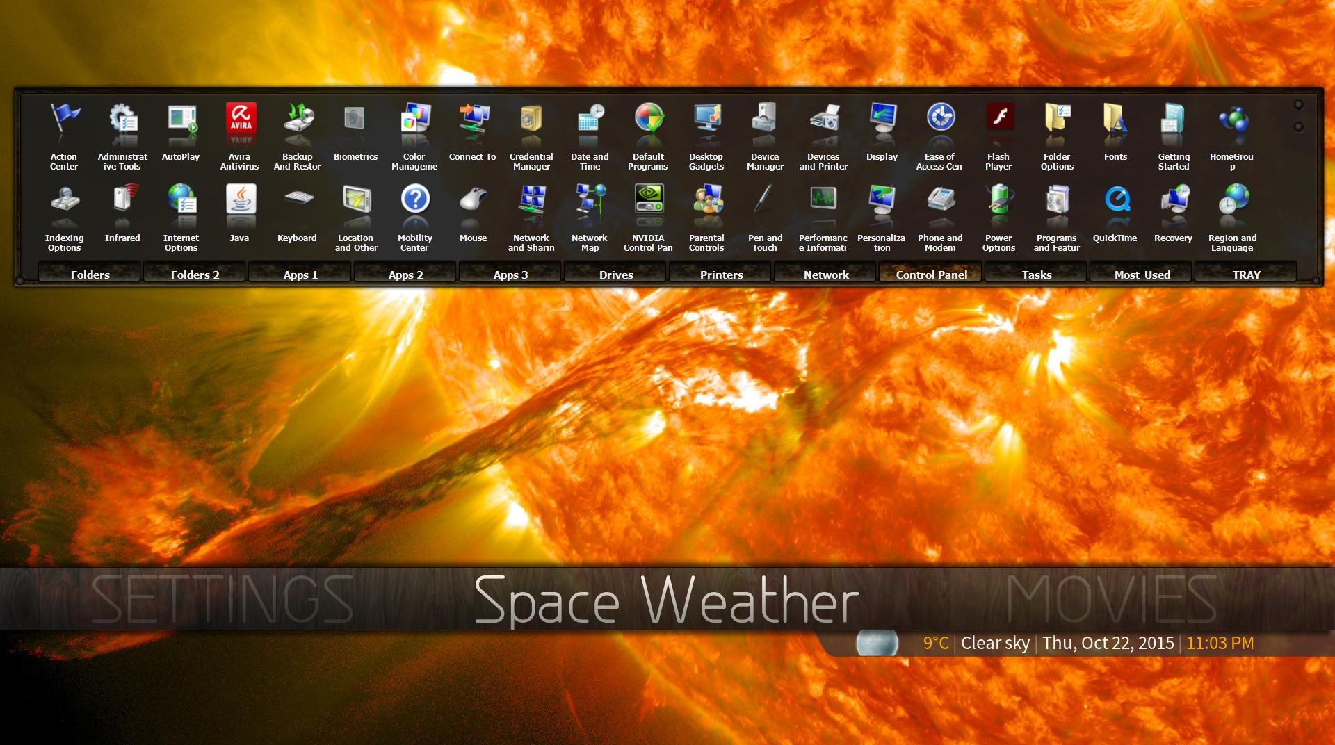

The image is of my upper, external monitor showing where the shelf ended up right after i double clicked on the Control Panel tab. If I double click on it again, it will move even lower by the same amount.
I have always used the shelf on the top of the screen. I have a dock on the bottom of the laptop display and another smaller dock on the left side of the laptop display, and the shelf is either at the top of my laptop display or, if connected to an external monitor, at the top of the second monitor, with the tabs along the bottom.
Windows has my laptop screen as the primary monitor (at all times whether the external is connected or not) and the external as the secondary. But in Winstep preferences, under the Docks & Shelves tab the shelf is shown as Docked - Top of "Monitor 1 - Acer" and the other docks on "Monitor 2 - Generic" SO the monitor numbers here are reversed from how Windows sees them. Not sure if that makes any difference. The Acer is the external.

And the Shelf is set to reserve screen space, I bet... if you disable that option for that Shelf, this doesn't happen?

Are you referring to under the Properties for the shelf, Position tab, "Reserve Edge pf Screen" at the bottom, Yes, both options "Prevent Maximized Windows..." and "Respect Space Reserved by..." are checked. de-selecting them both in various combinations changes nothing, same issue occurs.

Doh. Are you sure? The only time I have seen this happening was because either 'Prevent maximized windows...' or 'respect space reserved...' were turned on.
So, to recap, this only happens when the secondary monitor is attached to the laptop, right? One more question: when you double click the tab for the first time, besides moving down, does the Shelf *also* expand as it should? i.e.; it expands *and* moves down?
Yup, I'm sure, checking all four combinations of those two settings yields the exactly the same results in this matter.
Yes, correct. With the laptop running on it's own and the shelf docked to the top of it's screen, double clicking on a shelf tab correctly expands the shelf.
No, in dual monitor mode, double clicking on a tab only causes the whole shelf to move down, it does not expand.
