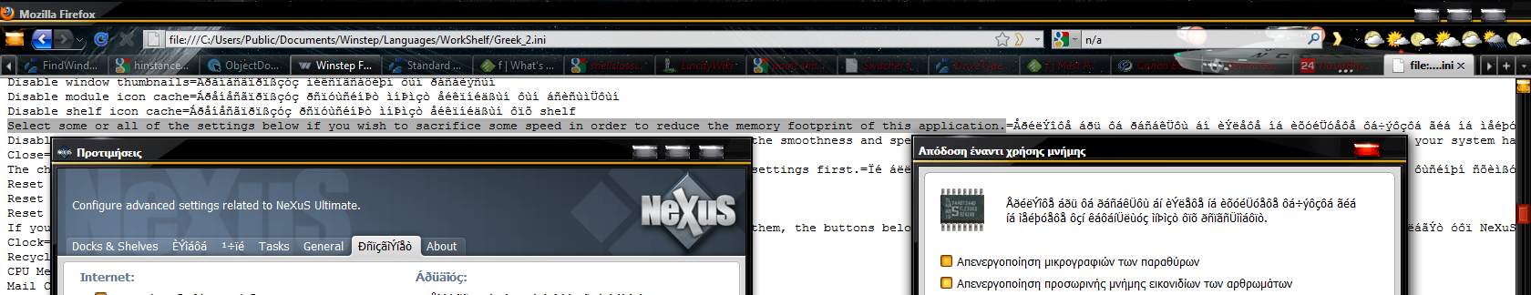

Something else I noticed: if you look at the screenshots displaying results on the US system, the text is filled with '?' (question marks). However, that does not happen with the labels in the latest screenshots. Strange characters, yes, but no question marks. Hmmm...
 Post subject: Re: Language issues
PostPosted: Sun Jan 30, 2011 2:23 am
Ok, so, here's a little experiment I did. I thought about what you said, and I tried finding some correlation, but the story is, Greek codepages are many and the correspondence with character positions totally erratic.
So... I was thinking... how do I get Windows to display Greek text, but override the codepage to be... something else?
Answer: load the greek.ini file into Firefox, and override the character encoding. ;)
The first thing I tried: override encoding to "Western (ISO-8859-1)".
Guess what: all the Greek text is shown *exactly* as Nexus shows it (on the Greek NUL system).
So, it looks like these strings are shown using the default "Western" encoding.
In the screenshot, I've highlighted the English text of the control shown, and I've moved the window right under the text, so you can see the match between the characters (gibberish).
File comment: Firefox encoding: Western (ISO-8859-1)
