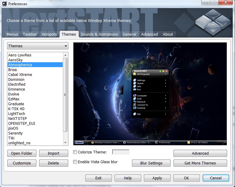

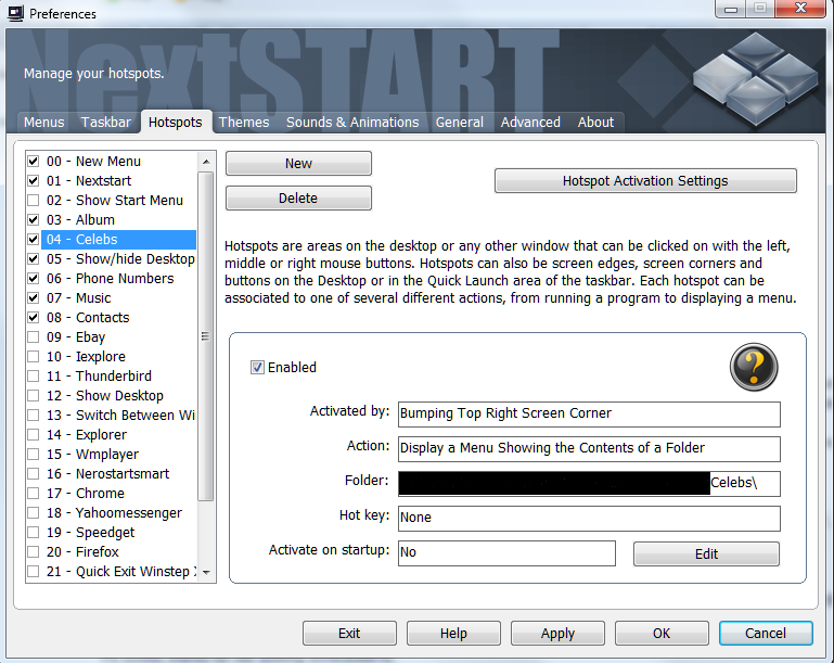

I've made an exhaustive list of screenshots that took a lot of time (which I normally don't have) to compile to show the pertinent settings needed to accomplish the bump settings and a few other ones for my configuration.
I will start from right to left since the menus open with the far most right tab selected.
The screenshots should help to clear up confusion while using Winstep Xtreme:
1) NextSTART--Accessed via Ctrl + F12 or double left-click the NextSTART icon on the System Tray which looks like a computer monitor, or right-click the Nexus icon > put the cursor on the context menu title bar where it reads: NeXus, and has the three buttons to min, max and close the context menu > middle-click (which for people not familiar is to press down on the mouse wheel if you have one. I don't remember if it's the default since I've changed it a few times). If nothing happens, try a left or double left-click. If that doesn't work try a right-click > Settings > Preferences.
2) WorkShelf--Accessed via Ctrl + F11 or right-click the Nexus icon on the Dock > Preferences, or, right-click WorksShelf and then select whatever you want from the context menu.
3) Dock-Bottom. I'll only post the bottom Dock info since the other two are the same except for minor differences like which side of the screen it's set to dock on, and which side to bump.
Very importantly, if I don't mention/or post a function that is in the screenshot, that means it has no significance as far as these settings and are usually minor in nature and could be a matter of taste or in my opinion, best left with the default settings.

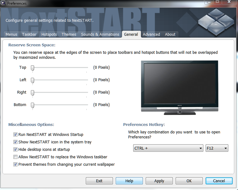

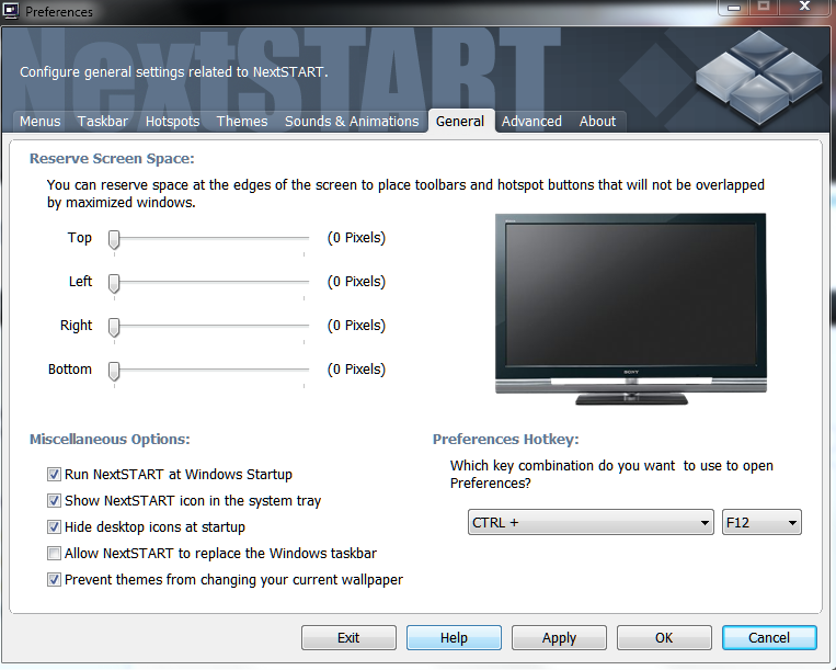

NextSTART

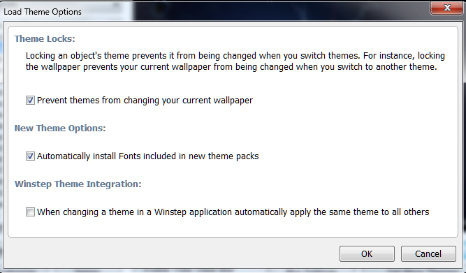

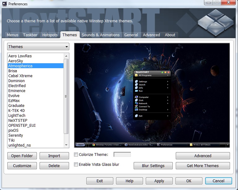

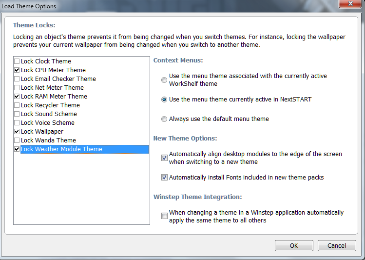

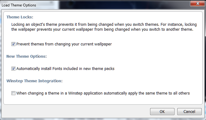

Advanced option under Themes tab

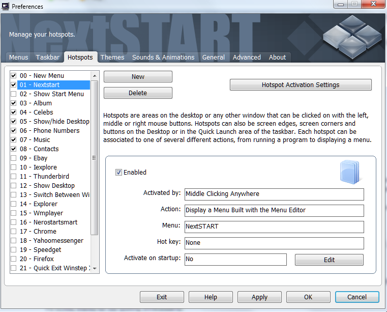

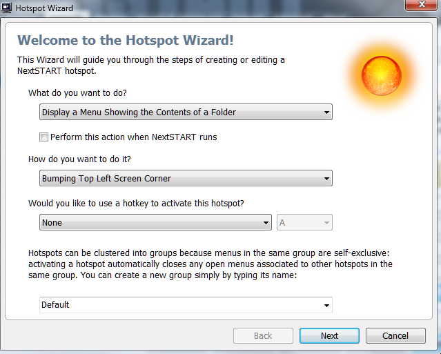

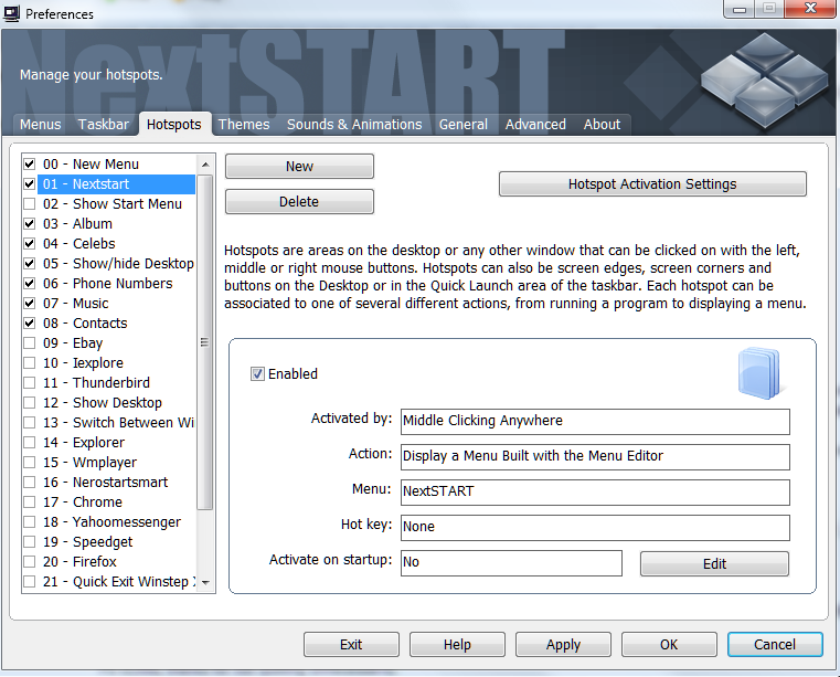

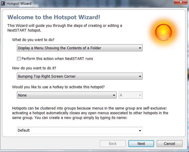

Edit option

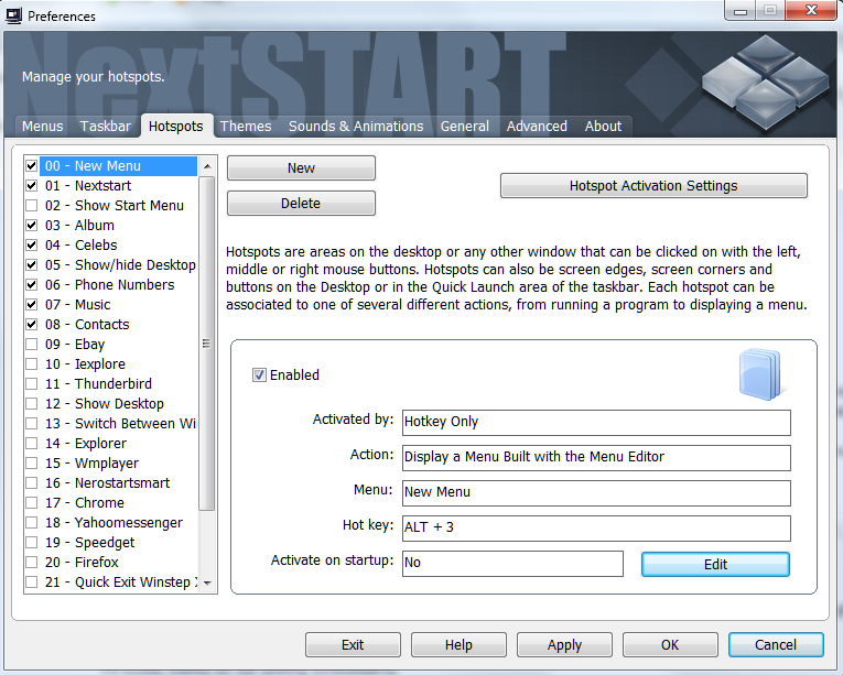

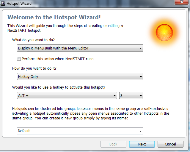

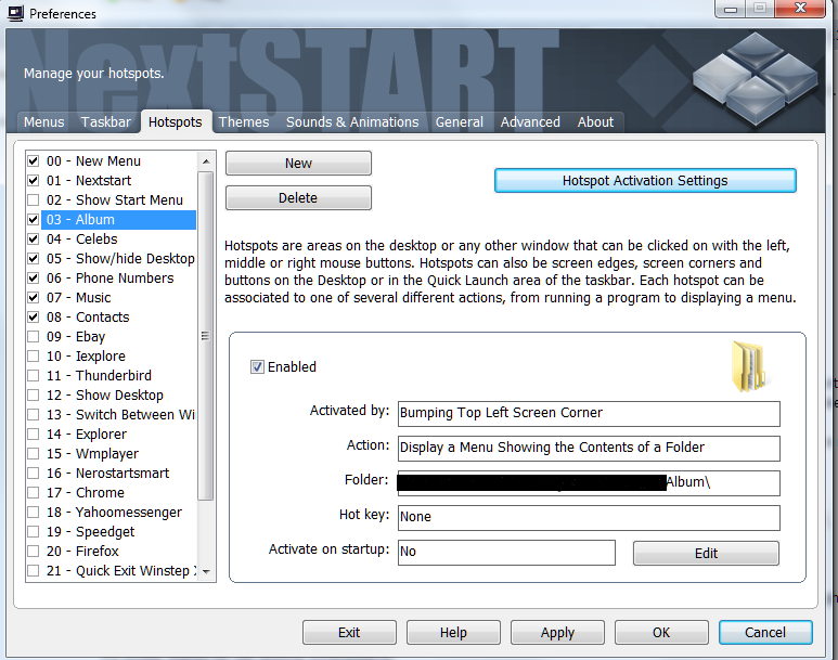

 Post subject: Re: Winstep Xtreme-Planet Background
PostPosted: Fri May 31, 2013 2:56 pm
Edit Option

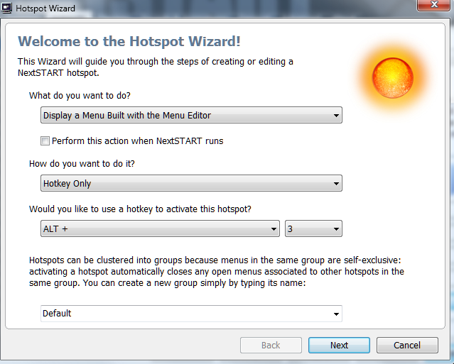

Edit option
PostPosted: Fri May 31, 2013 3:07 pm

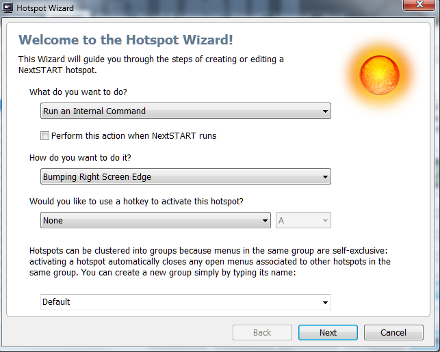

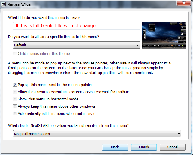

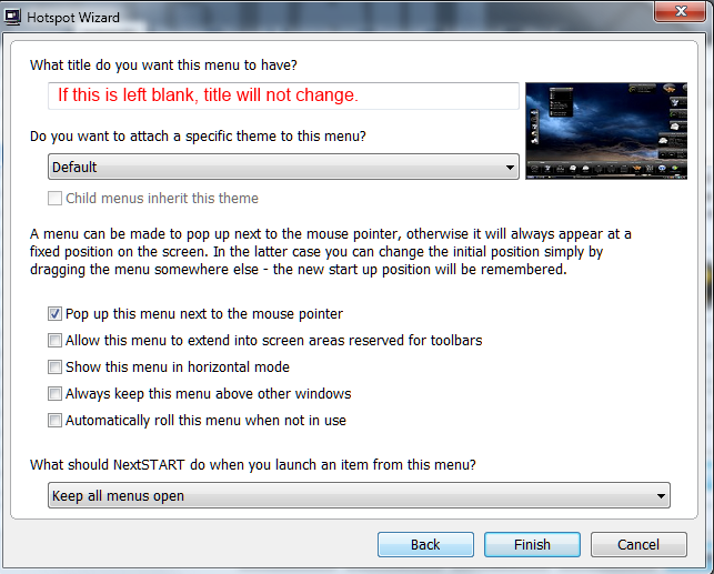

Edit option > Next > Next

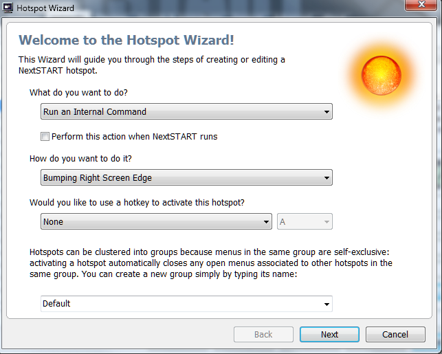

Edit option

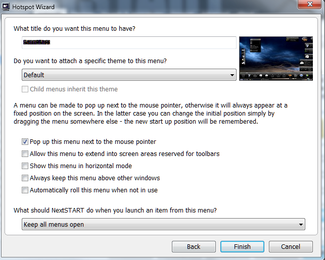

PostPosted: Fri May 31, 2013 3:12 pm

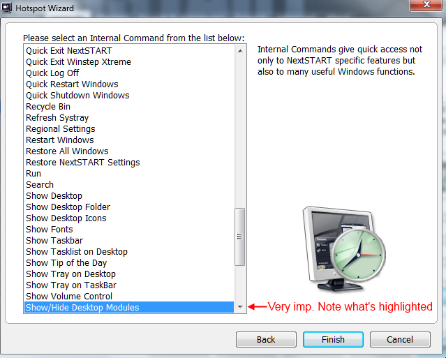

Edit option >Next > Next

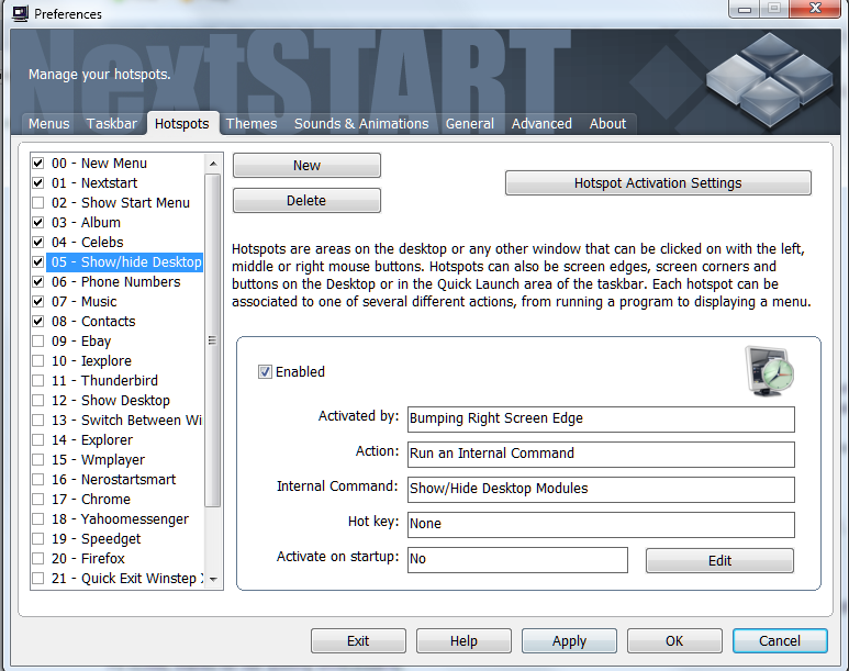

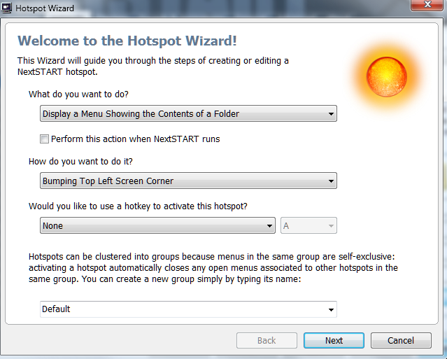

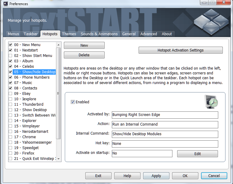

Edit option

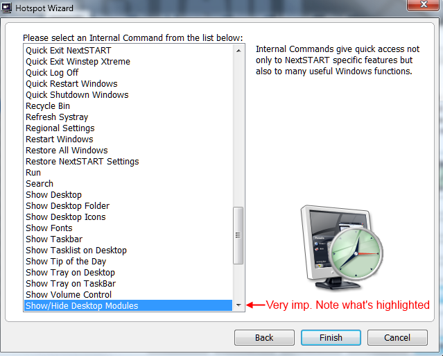

Edit option > Next
The rest that are enabled in the Hotspot list are the same except the bump activation so I will not post those.

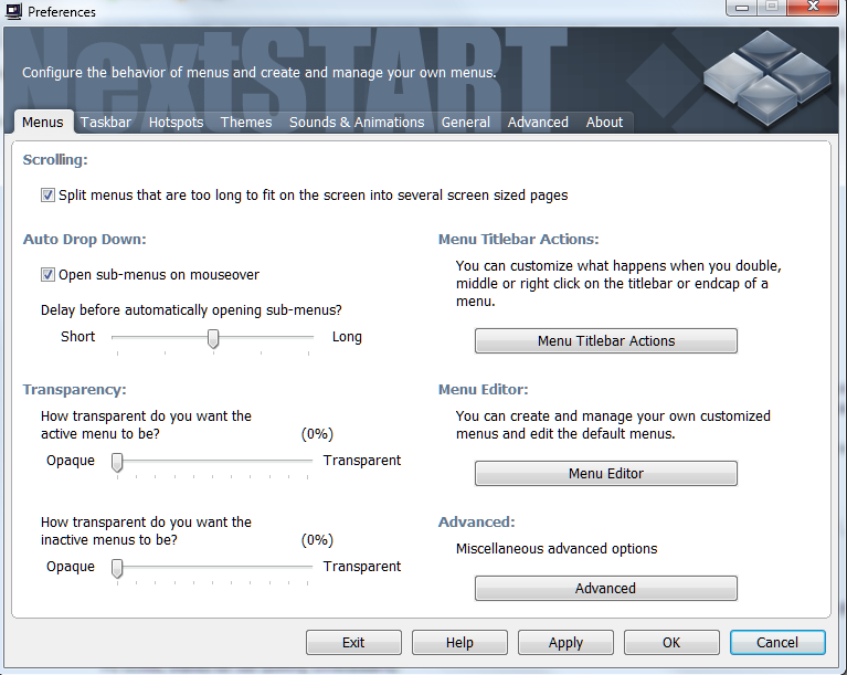

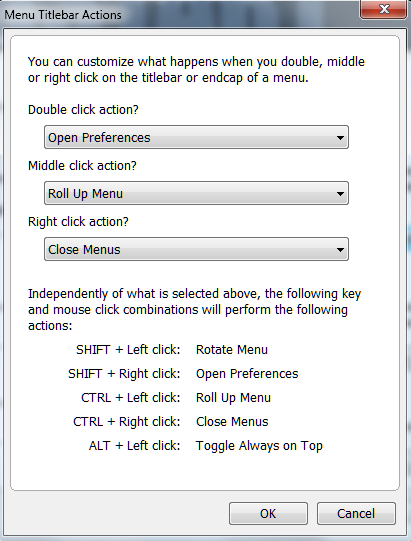

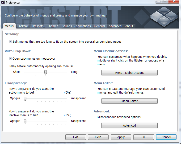

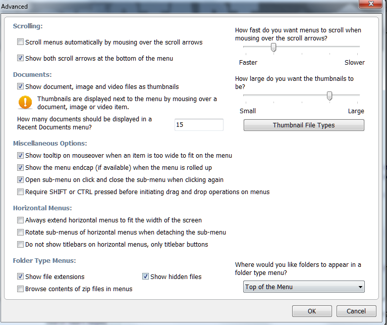

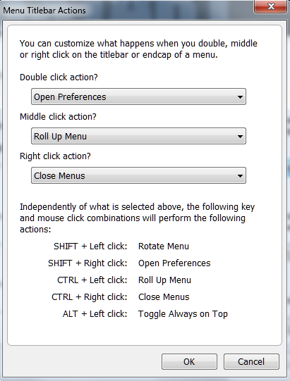

Menu Titlebar Actions option
Advanced option

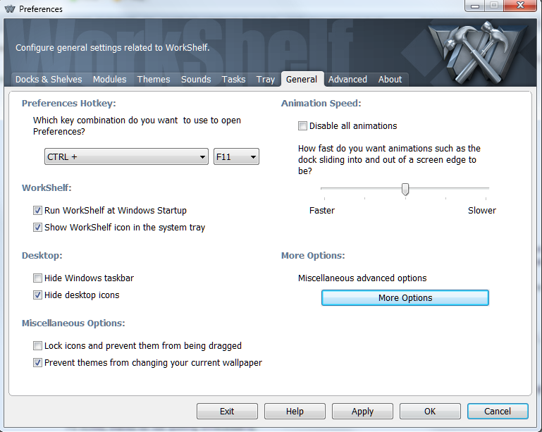

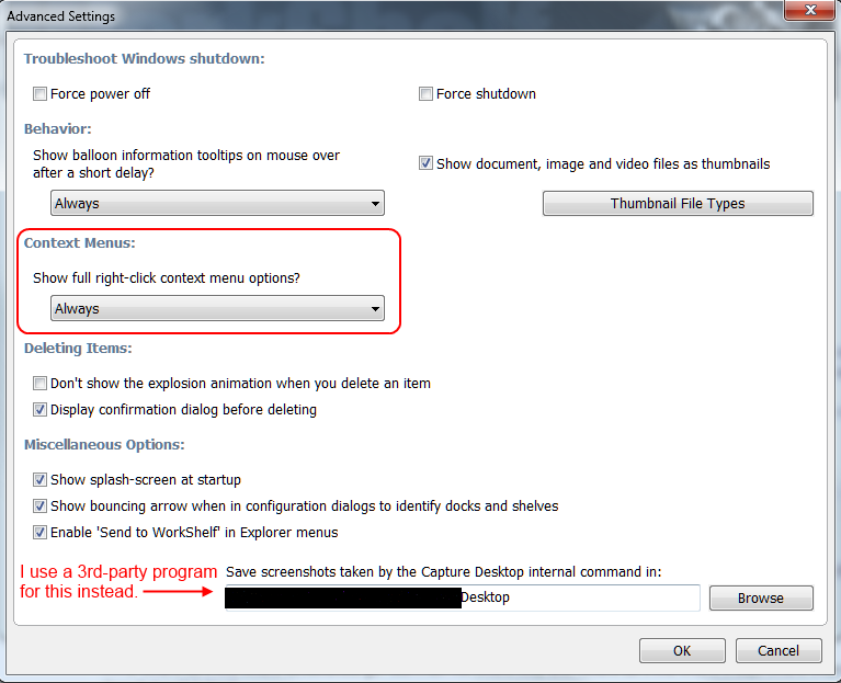

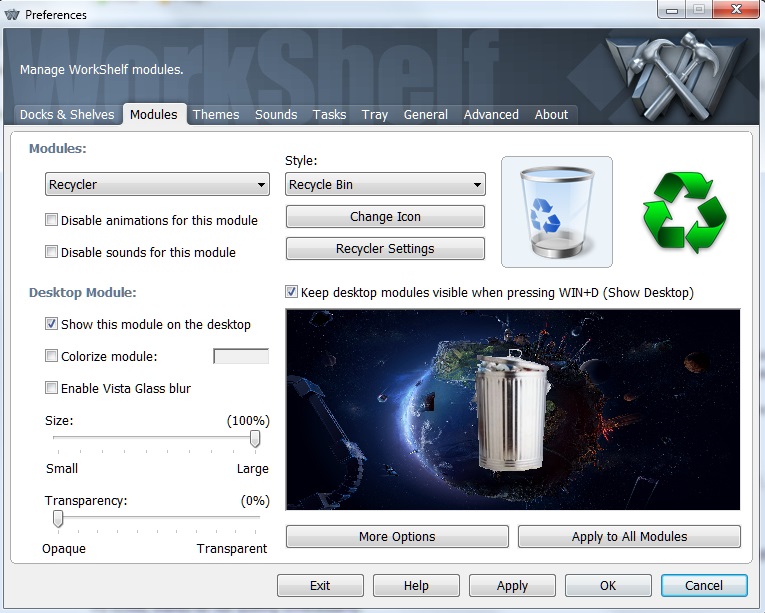

WorkShelf
More Options
WorkShelf-Shelf Preferences-General 2-More Options.png [ 72.96 KiB | Viewed 30055 times ]

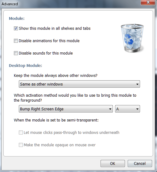

PostPosted: Fri May 31, 2013 3:52 pm
Advanced option

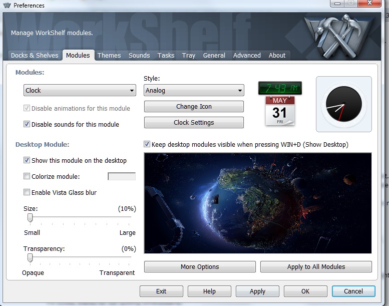

VERY IMPORTANT! THE CLOCK MUST STAY ENABLED OR THE BUMP SETTINGS WILL NOT WORK CORRECTLY. TO MAKE THE CLOCK PRACTICALLY INVISIBLE, RIGHT-CLICK ON IT > SCALE > 10%.
In pull-down list

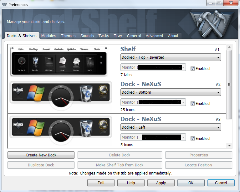

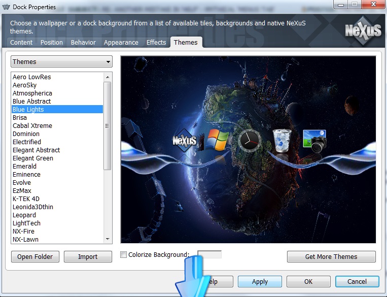

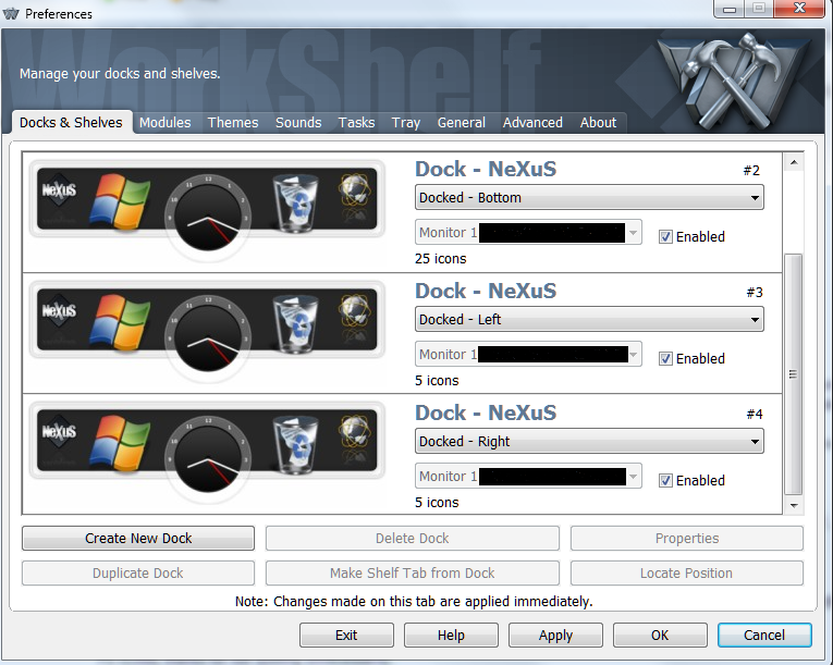

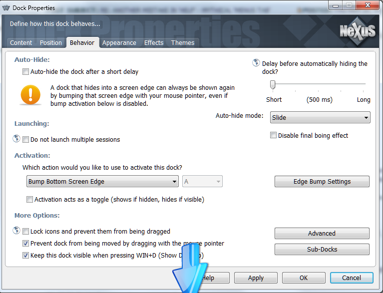

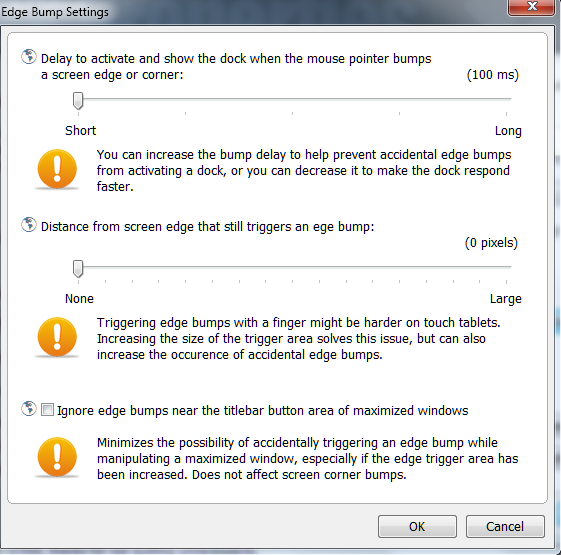

PostPosted: Fri May 31, 2013 4:27 pm
Dock Properties

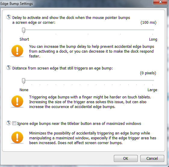

Edge Bump Settings
Dock Properties-Bottom-Behavior 2-Edge Bump Settings.png [ 73.98 KiB | Viewed 30054 times ]
