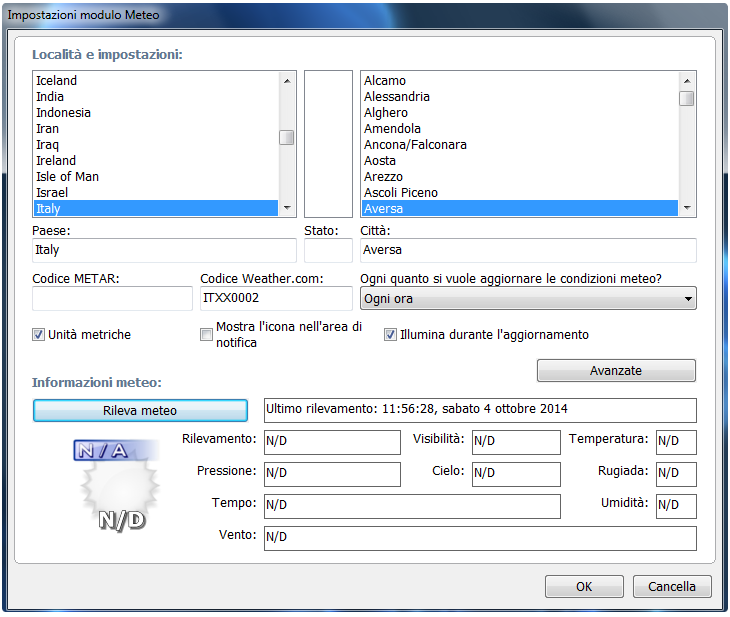

Hi, over a week ago I sent an email to Winstep Support, but I have not yet received a response, so I hope you can help me solve the problem here in the forum.
The issue concerns the "Weather module" of Winstep Nexus Ultimate 12.2, because are many weeks that no longer works, it doesn't detect the weather in my city (I live in Italy).
It's a strange thing, since so far it had always worked fine, and I haven't changed any settings of the widget.
Also, there is no blocks through the firewall.
In attachment to this post there are a screenshots series where you can see the error message ("Invalid location") and the current settings of module.
In addition to my city, there are also many other italian locations that no longer work, but some still work.
I hope there is a way to restore the correct functionality of the widget, can you help?
Thanks for your attention and best regards.

I could obtain the weather in Aversa Italy.
The only different setting compared to yours is the Weather.com XML Source URL. Mine is:
http://wxdata.weather.com/wxdata/weather/local/%1?cc&dayf=%2&link=xoap&prod=xoap&unit=%3&par=%4&key=%5
So you could try that setting.

Hi, HENK.
I replaced the string that you suggested, and now the weather module works perfectly. Thank you so much, you've solved my problem!
I had assumed that it was to change those settings, but I didn't know how.
I owe you a beer! Image
