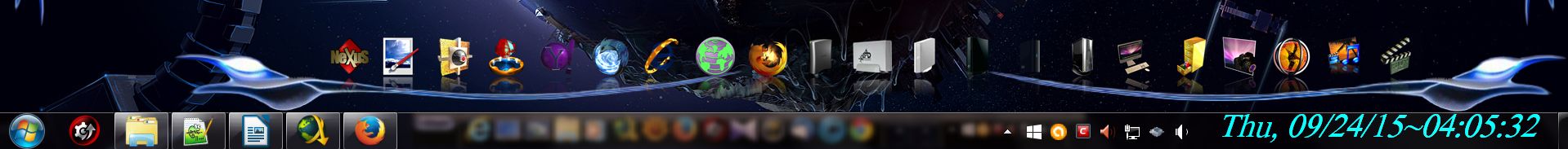

As you can see, the Winstep taskbar is underneath the Windows one.
Are you able to reproduce the issue if you enable the settings and procedures I used?

You can't keep the NextSTART taskbar always on top of the Windows taskbar, because both will be fighting for 'always on top' status - and only one can have it.
If you dock the taskbar, it will reserve screen space for itself and it will respect the space reserved by the Windows taskbar, i.e.; it will appear right above it.
TL;DR, Two bodies cannot occupy the same space. ;)
