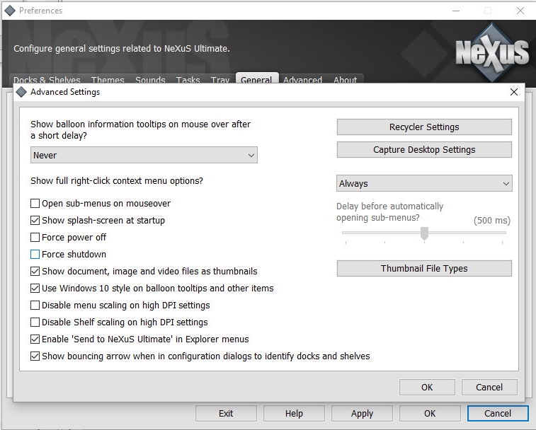

ummm .... but I did ... here's the preferences screen.
You're confusing the setting for 'Ballon Tooltips' with the setting for 'Show full context menus'. The latter is at the right of the dialog and is still set to 'Always'.
You may want to take another look.

Joined: Sun Nov 11, 2012 1:52 pm
Posts: 14
Yeah, I noticed that and thought that might be the case so I set that to Never as well. That's when I started getting the short menu on some, long menu on others.

Can you please set the Balloon Tooltips option to 'Always' and the 'Show full right click context menu options?' to 'Never' and then post a screenshot of that dialog so I can confirm the settings are correct?
 Post subject: Re: Unknown Exception when right-clicking
PostPosted: Sun Mar 27, 2016 5:12 am
Posts: 14
hmmmm ... ok, and now I'm confused. I set the left combobox to Always and the right to Never. Clicked OK, then Apply. Then went back to More Options to do the SS and the right combo was back to Always. Tried it again, same result.
