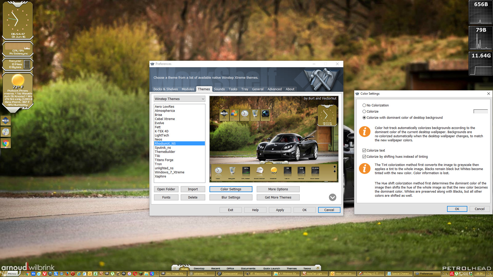

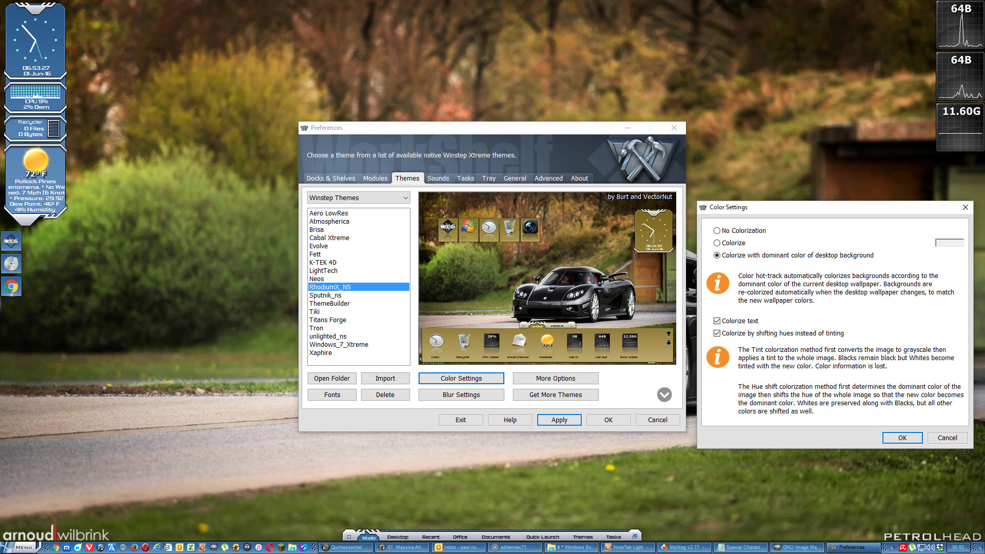

No. You need to help me figure out what is not working and why. :)
Lets start with screenshots. As you know, I love screenshots, it allows me to see a lot of things at a glance.
So, please post here a screenshot of your *entire* desktop (so I can also see the wallpaper) with WorkShelf Preferences open in the Themes tab and the colorization options visible (i.e.; you click the little gray down arrow at the bottom right of the themes tab to roll those up into view).

PostPosted: Wed Jun 01, 2016 2:07 pm
Jorge, here is a screenshot before exiting and restarting Winstep but after actually TELLING it to Apply:
File comment: Before exit and restart of Winstep
As you can see, Winstep settings knows the color it SHOULD use, but it doesn't actually use it.
Here is a screenshot after exiting and restarting Winstep:
File comment: After exit and restart of Winstep
Now the colors are correct.
On a sidenote, you will also notice in the screenshots that the modules that don't have skins are dark grey in both shots, as I was mentioning before.
