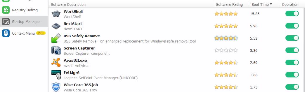

Okay, here's round two. I later tested it several times and unfortunately the boot times again increased to 190 seconds. The WorkShelf boot time was 25 seconds.
I then disabled WorkShelf via Wise Care 365 (which also disabled NextSTART) and restarted the PC. The boot time dropped to 89 seconds. As you will see in the following screenshot something really odd after I re-enabled it. It shows both WorkShelf and NextSTART enabled and disabled. :? Notice the boot time.

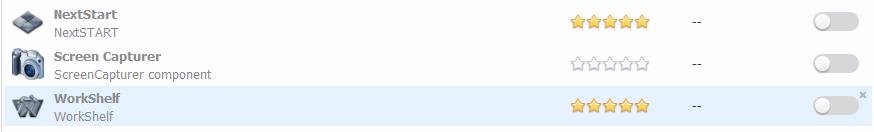

I restarted it again and the boot time was 92 seconds. Again you see how they are both enabled and disabled. This is consistent throughout.

As you can see, there are several fluctuations in the boot times of WorkShelf. Except for the first screenshot, NextSTART is consistent.
What is your take on all of this? Why did the boot time increase so much but after I disabled WorkShelf and re-enabled it the boot times went down considerably?
